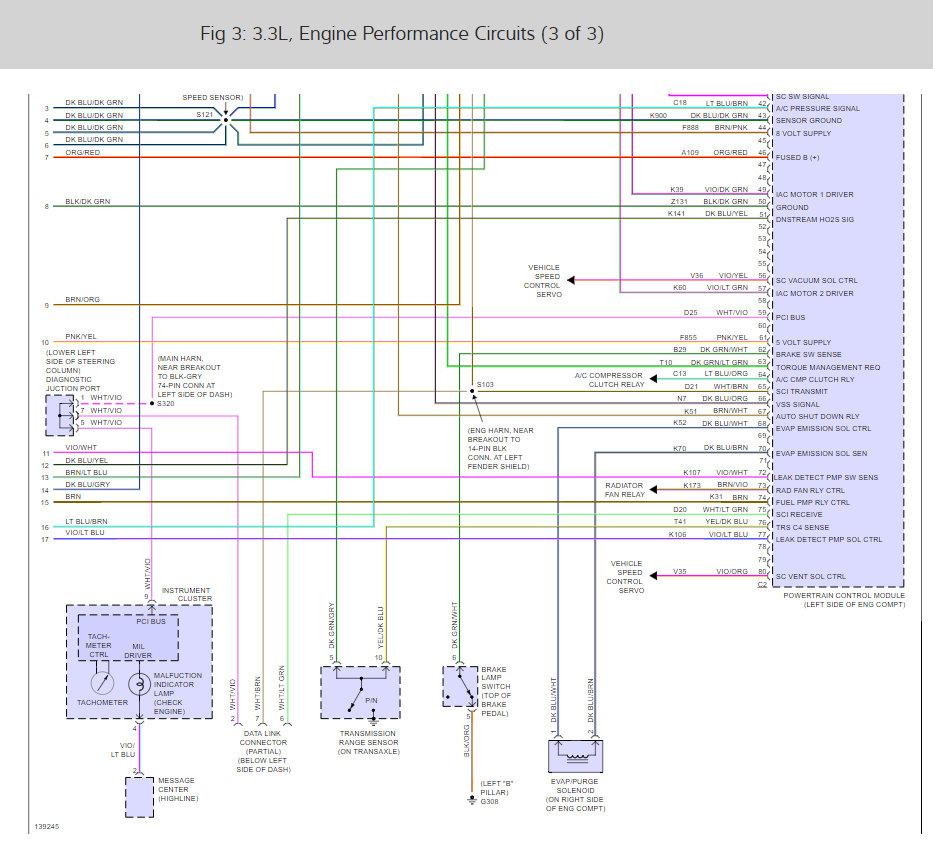

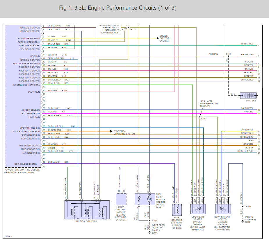

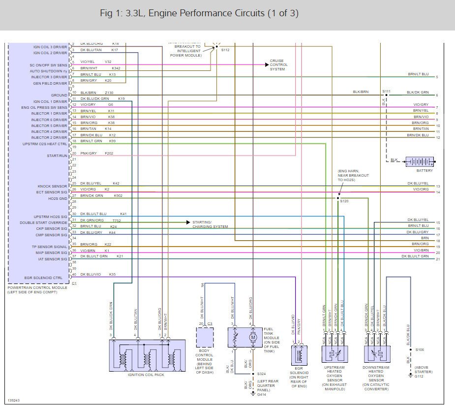

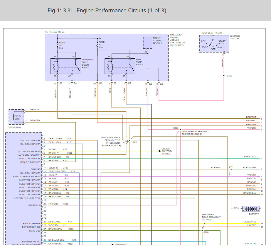

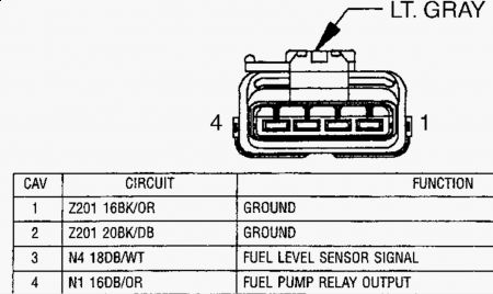

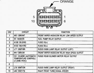

Dear, i am interested on the right Color pin from the Fuel pump - Gasoline Fuel Pump off - I cant find any Information about this Pin (+12Volt) or you can send me a Electric-Plan for the Fuel Pump- location. I am very happy you can help me

Here is a guide to help you check the wiring out to see what's going on. https://www.2carpros.com/articles/how-to-check-wiring If fuse is blown, check for short to ground in fuel pump relay output circuit. Repair as necessary and replace fuse. https://www.2carpros.com/articles/how-to-check-a-car-fuse

Check out the fuel pump wiring diagrams below! Please let us know what happens. Cheers
