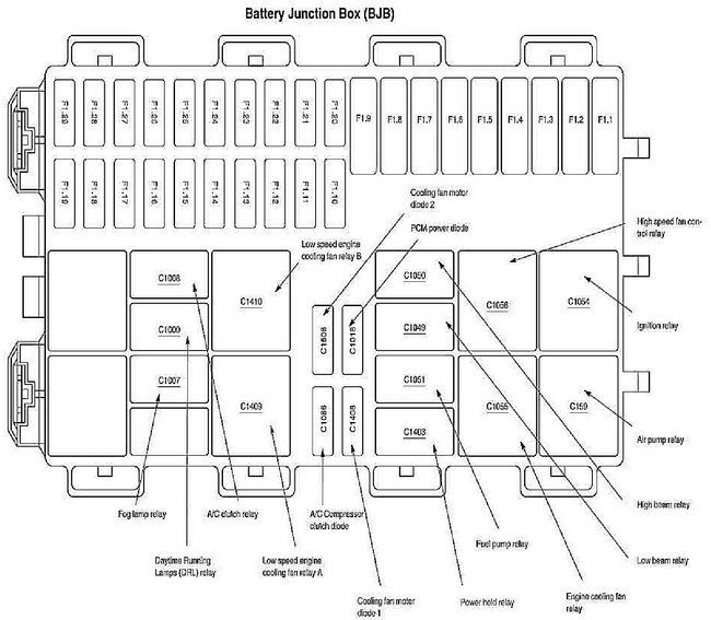

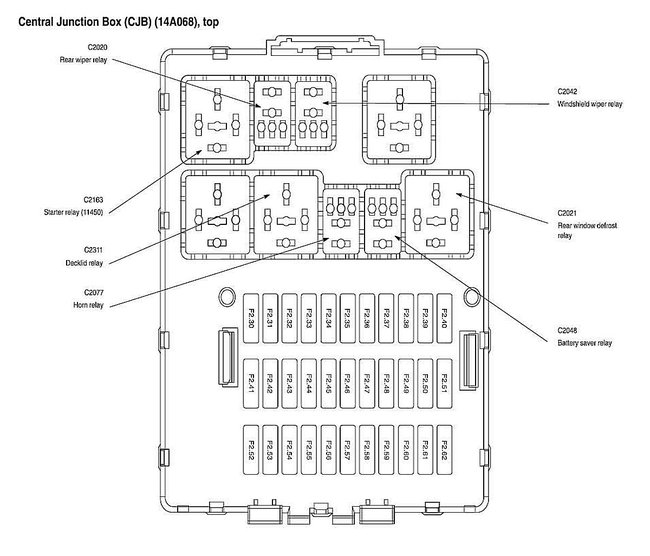

Will not start, replaced ignition switch/starter and one pat relay. Still no luck only clicking. Got starter relay from local part store but not the right one. On the Ford OEM it reads 70A G1UHQ. But cannot find that anywhere?
Desperate now for any ideas?
Do you have fuse diagram for box under the hood and also inside the floor board?
Sunday, February 24th, 2019 AT 3:52 PM
  • 109,885 POSTS

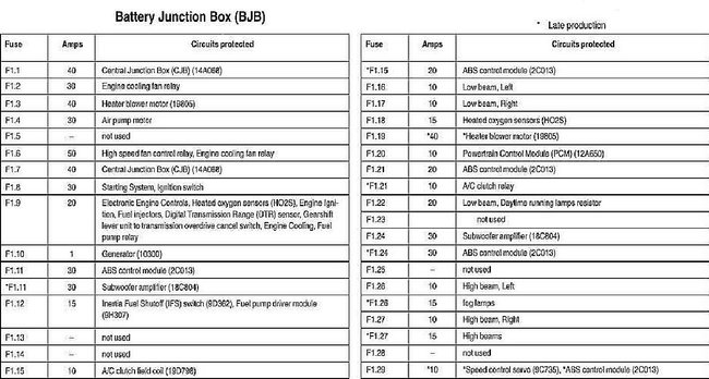

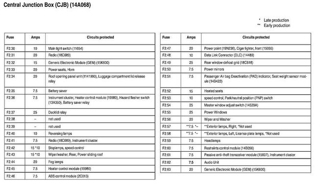

First, I attached the pictures and legends for fuses. See the attached pictures.
Next, here is a link that shows how to test the original relay you removed. See if it is actually bad.
