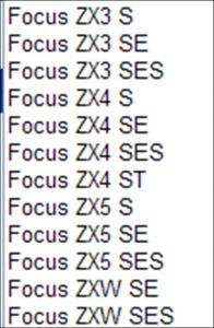

To better assist you please tell me the exact model of your focus from the attached list. Also your engine size in liter.
https://www.2carpros.com/forum/automotive_pictures/248015_Model_1.jpg
