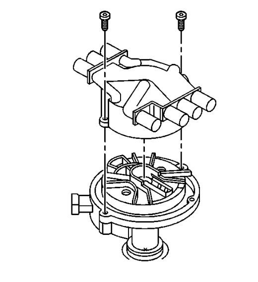

I took my truck to a mechanic because it wouldn't start. He told me that there was moisture in the distributor cap. He cleaned it all up and it started fine. He told me that it is a design flaw on Chevrolet's part because where the cap is located. He told me there is no way to prevent it from happening. It was been raining for the last week and even though the truck is parked in the carport apparently the cap is wet again because it won't start. It seems bizarre that I've owned this truck for 13 years and now suddenly it won't stay dry. I'm afraid that the mechanic is just screwing me around. I need help
May 28, 2019 at 4:01 AM
Good afternoon,
I would replace the cap and rotor and get a can of clear spray paint. Replace the cap and when you are done, spray the paint all over the cap and it will seal it from water getting into the cap. Check out the diagrams (Below). Please let us know if you need anything else to get the problem fixed. Roy

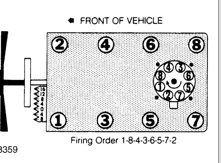

Truck stopped on me the first thing I checked was to see if is getting any fire on #1 plug. There was no fire I removed ignition module had it checked at auto zone and it failed. Purchased a new one replaced it making sure to put compound under it tried to start it and it would not start. I replaced distributor cap and rotor and the truck started having a problem. It now it is misfiring like the firing order is incorrect. I have checked firing order it is correct. The plug wires are less than three months old. I am stuck as to what it is problem. It acts like the timing is off. any ideas?
Aug 15, 2020 at 5:40 AM (Merged)
HMAC300
  • 48,601 POSTS
the distributor would not be out of time by replacing distributor cap. it is either on wrong or a bad wire/cracked or firing order incorrect. all Chevrolet V8's from that year fire the same. see picture.

with the engine at top dead center, the rotor should face forward with number 1 spark plug wire directly above it.
why did you have the distributor out??
