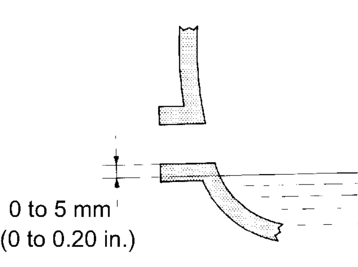

I just drained the diff fluid and let it totally drip for a long time. It came to almost a full gallon. I understand it has a little over 3 quarts. I added 4 until it got close to hole. Is that accurate? Seems like it took more at adding than when drained and i thought it was 3 an 1/4 quarts? I don't think i can overfill it but i wanted to be sure..
Anything i should do at startup like let engine warm 1st and move it into each gear?
Jan 2, 2024 at 6:10 AM
STEVE W.
  • 15,423 POSTS
The OE number is 3.5 quarts for full, but normally the better method is to remove the fill plug and check the level there. Full is level with the hole to 5mm below. I generally check it cold because the oil will expand as it warms up, so if you check it warm you may have some leaking out if it was up to the plug cold.

Okay, maybe since i let it drain longer i got more out. I placed my finger right there cold and it was very close to hole. Is there an issue if it took almost 4 or if it's a tad higher than on graph?
And is the mobike 1 synthetic 75 90 good? Thats what i used.
I'm not sure if i have limited sliü but that has the additive if it does.
Jan 2, 2024 at 7:00 AM
STEVE W.
  • 15,423 POSTS
75-90 will be okay, they call for 80-90 for ones that may be operated in the cold so the 75-90 will be fine. As long as the truck was level when you checked it you should be okay. LS additive won't hurt if it doesn't use it, just makes it stink more.

Thanks, I'm in TN so it doesn't get as extreme on cold temperatures. After driving does the level go any lower? As u check it next day cold?
So, I'm fine if it took 4 quarts?
Jan 2, 2024 at 2:06 PM
STEVE W.
  • 15,423 POSTS
The only reason it might go lower would be if it leaks. Driving around the oil will get warmer and expand from the heat, so if you were to check it on a level surface with it cold and it was right at the fill plug, then you checked it after a long trip with it still hot, it would likely leak out a bit due to the expansion. But if you check it cold it would still be level with the plug. As long as the truck was level when you checked it and the oil is at the fill plug it will be fine.
