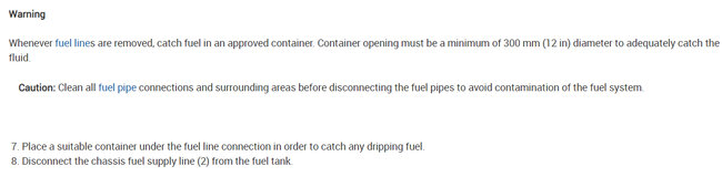

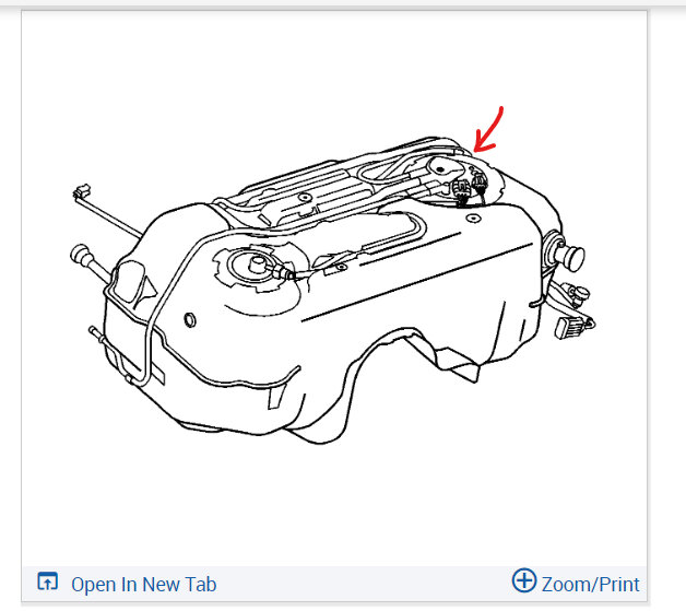

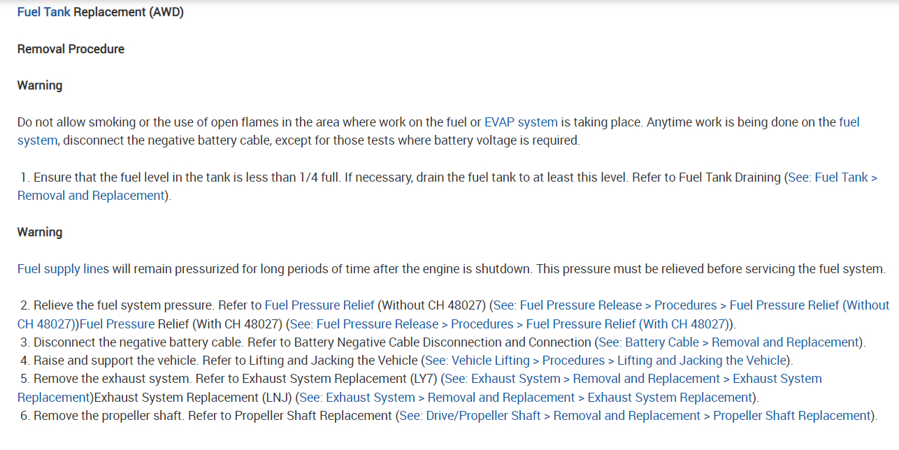

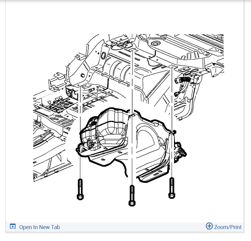

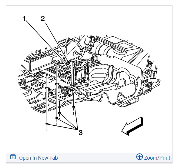

This can be because you are out of gas, the primary fuel pump stopped working (common) or the fuel pump relay stopped working, here is the location of the fuel pump relay so you can swap it out, then while cranking the engine over test the grey wire for power and if so the fuel pump needs to be replaced.

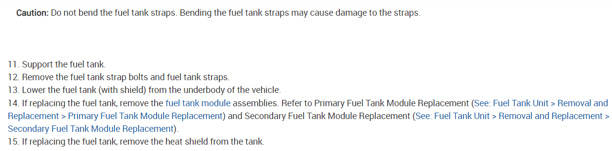

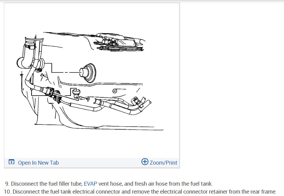

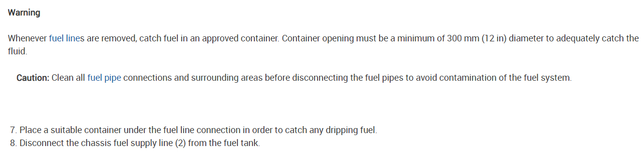

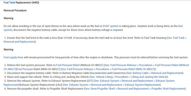

Here is how to test the for power and I have left the instructions on how to replace the pump which the tank needs to be removed for.
Here is how to drain the fuel from the tank:
https://youtu.be/Q5MH2gnyFH0?si=elF5bIrBlkagkirL

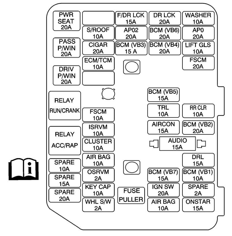

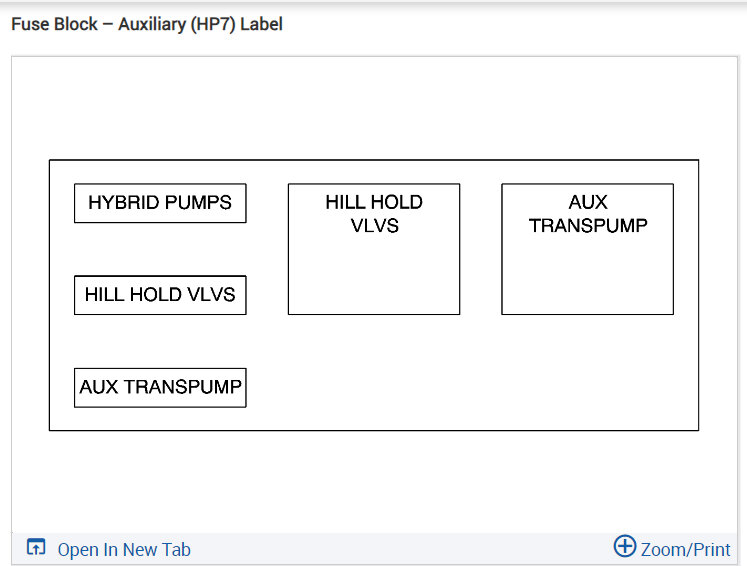

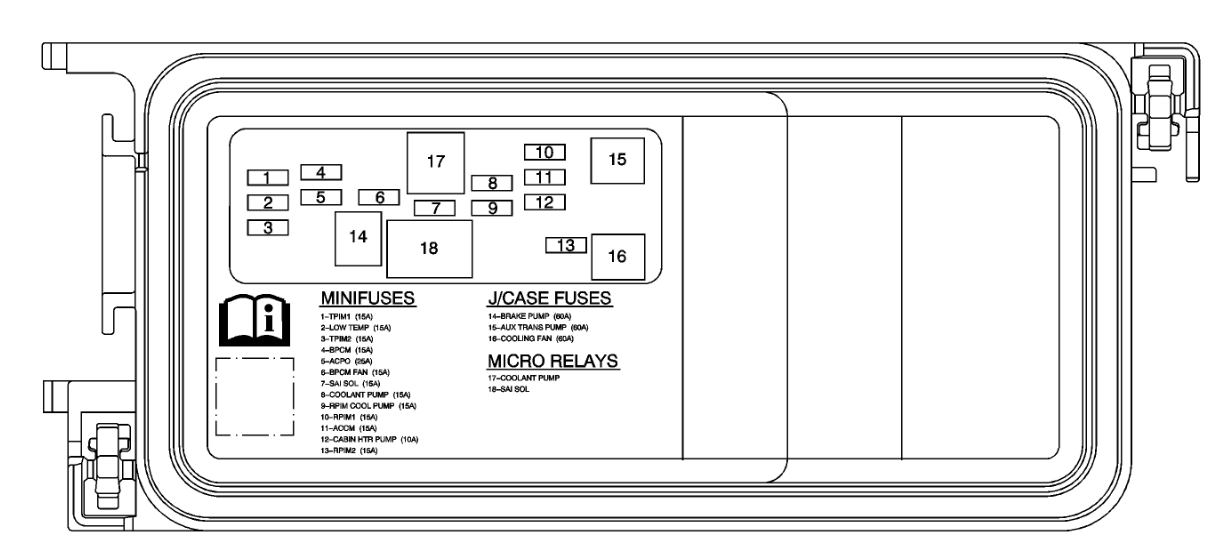

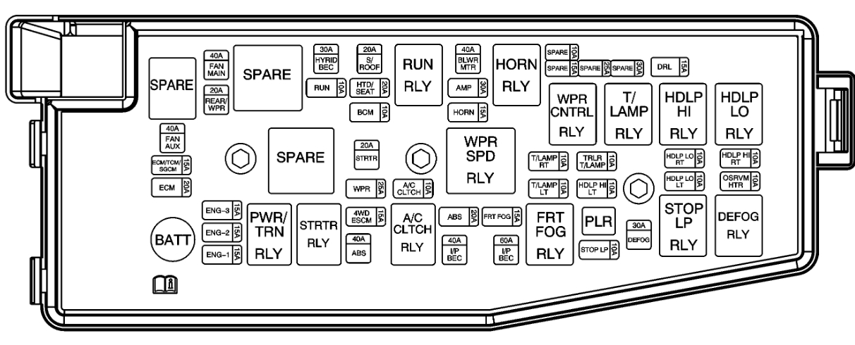

Yes, if it shows RPM it is working, we should have done this early, can you please turn the system on and check all fuses please?
Be sure to check the BCM fuses. Check out the images (below). Let us know how it goes.
May 12, 2024 at 5:24 AM

ABAYA
  • 77 POSTS
Thak you very much, sir.
All fuses are okay.
However, during the rebuild of the engine, I have changed the injectors without their calibration.
Does this interfere in the engine start?
Please send me the procedure to calibrate them.
