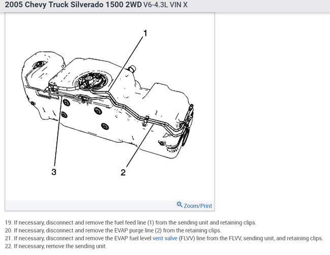

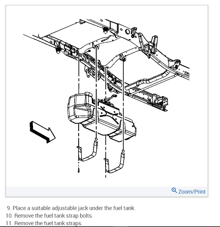

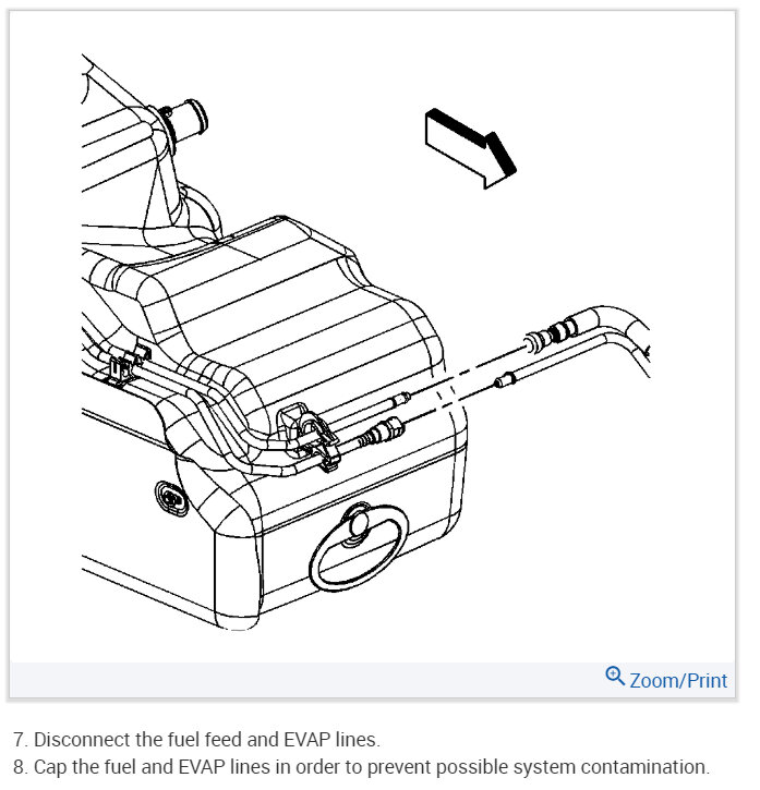

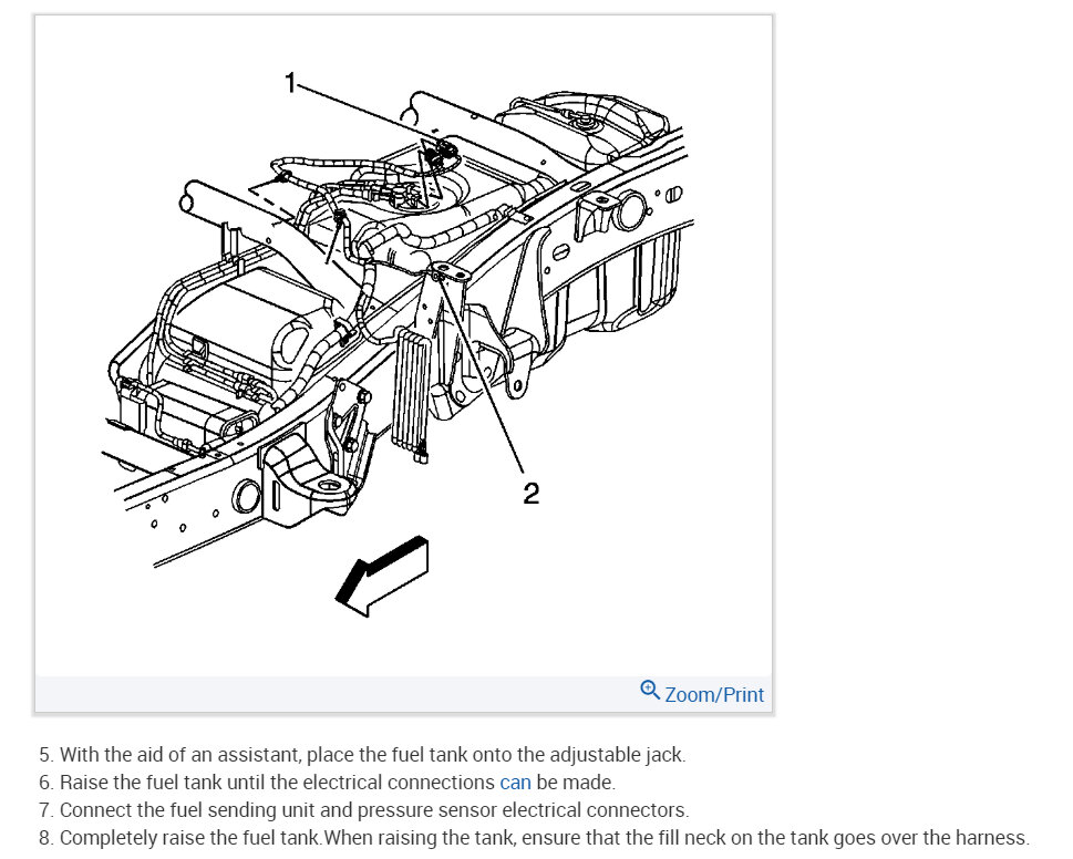

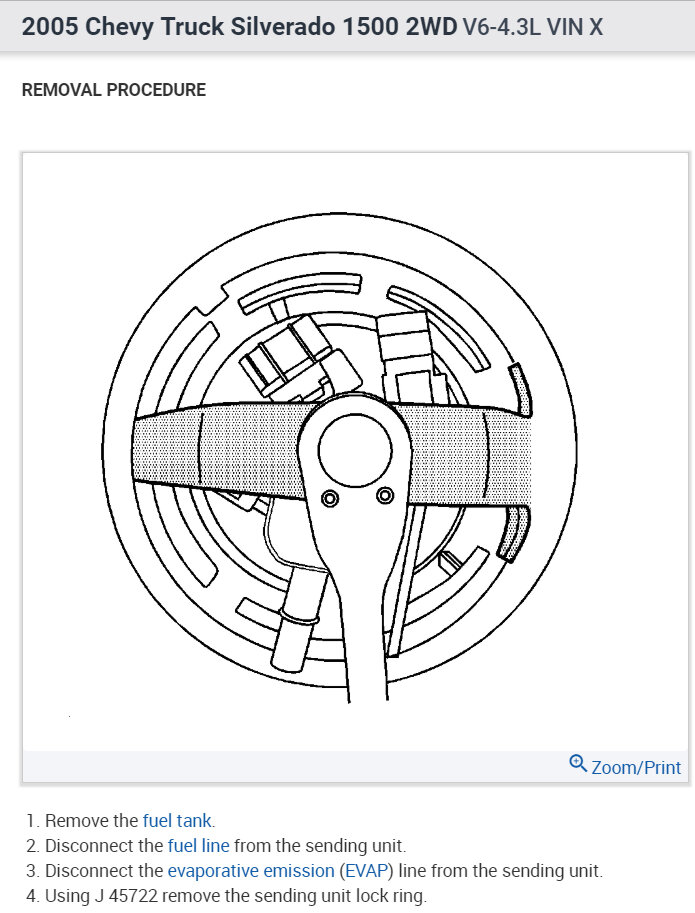

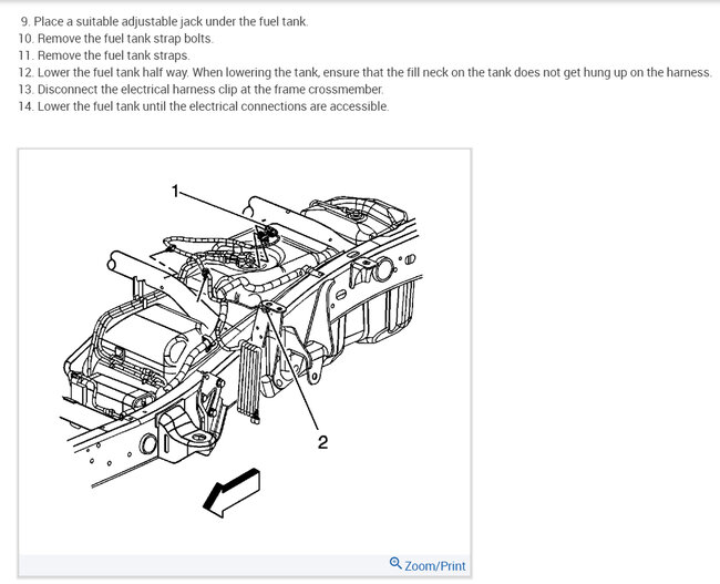

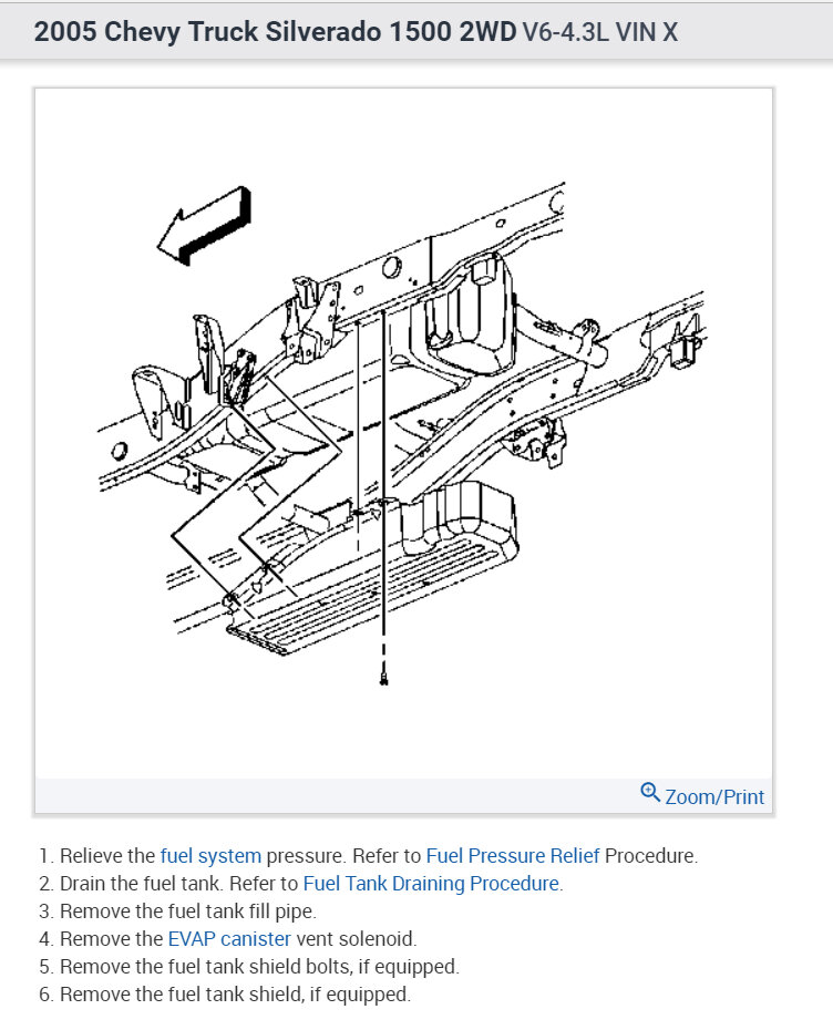

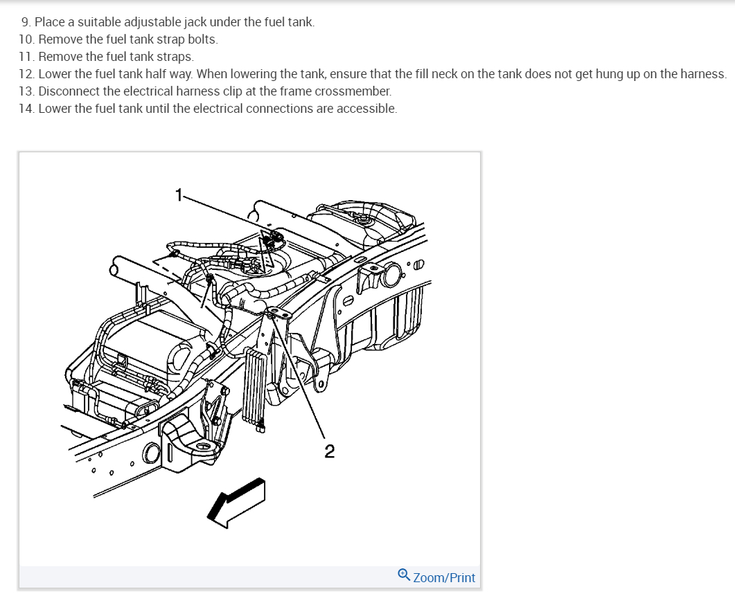

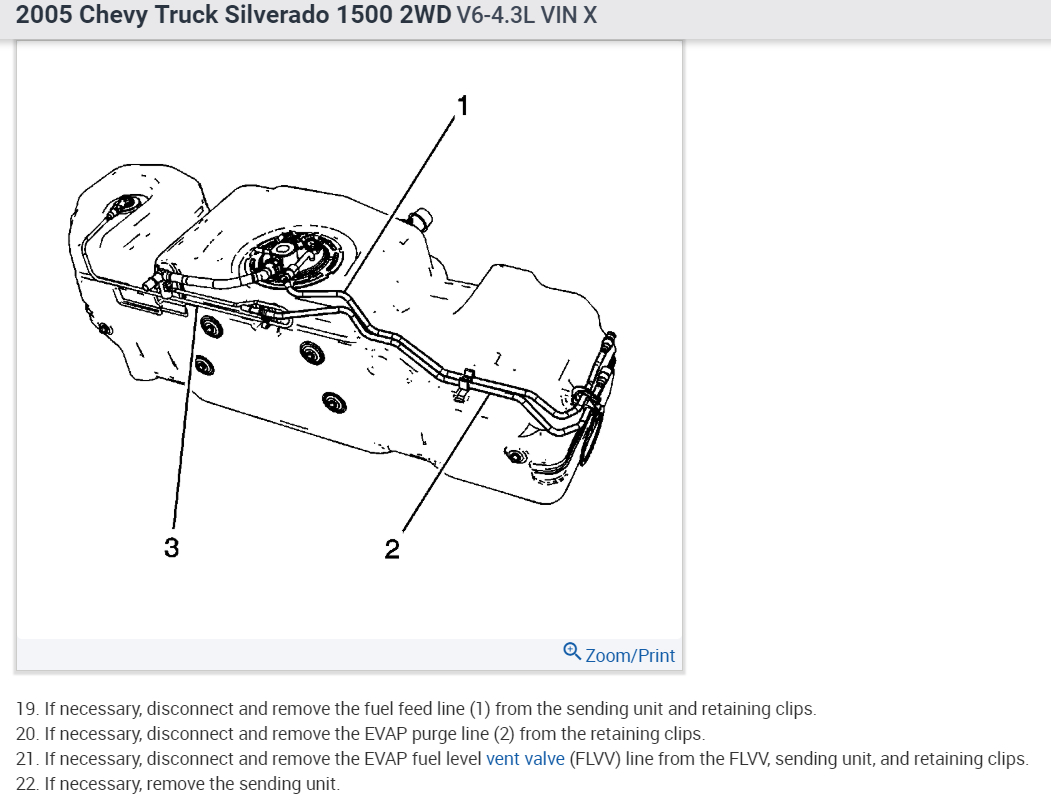

This can be many things, but I have seen a fuel pump starting to fail causing this problem. here is a guide to help us run the codes to see what comes up and I have included how to change the fuel pump out in case you need it.
This guide may help as well:
https://www.2carpros.com/articles/engine-stalls
Check out the images (below). Please let us know what you find. We are interested to see what it is.
