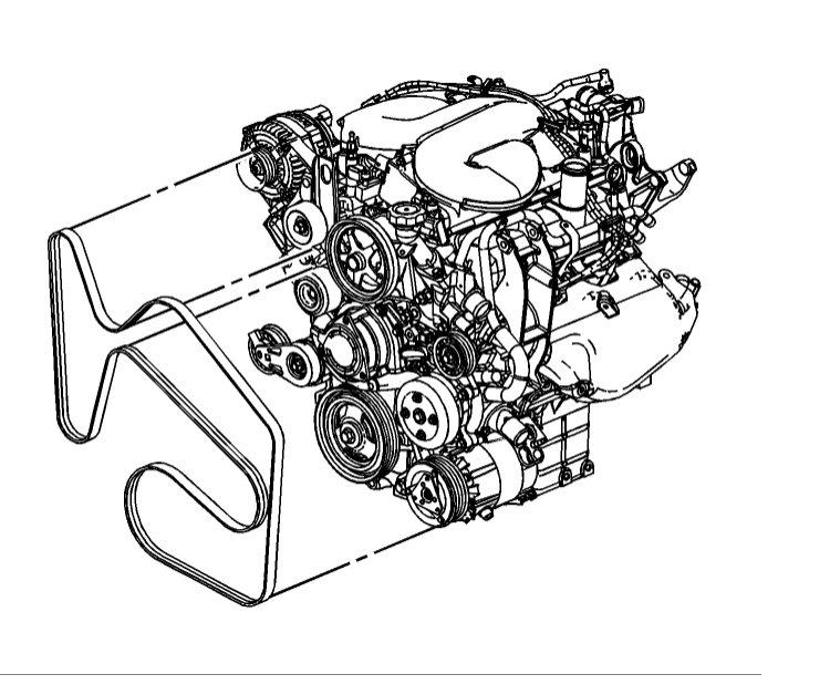

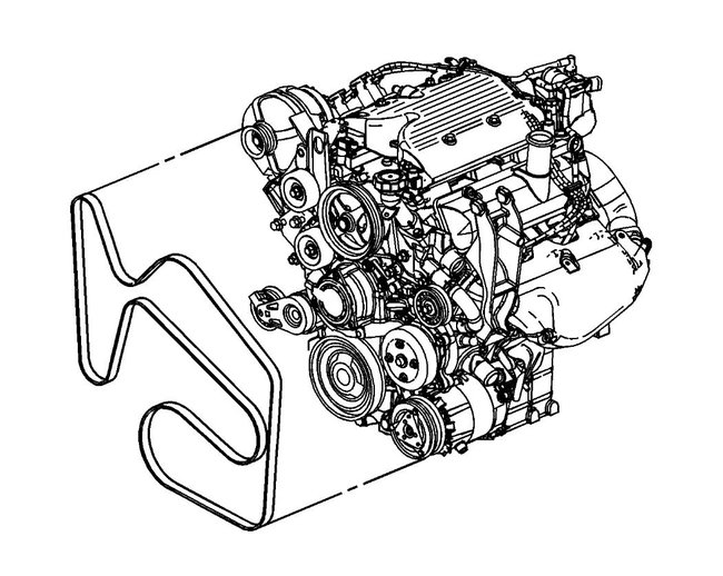

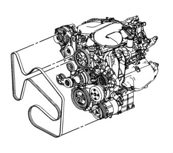

i need diagram for serpentine belt replacement
Mar 18, 2017 at 3:22 AM
HMAC300
  • 48,601 POSTS
that should be on the panel above radiator most cars have that unless someone stripped it off see pic for diagram. tensioner should be replaced as well if replacing belt. Check out the diagrams (Below). Please let us know if you need anything else to get the problem fixed.

Do I torque the tensioner towards the front or back of the car to loosen the serpentine belt?

which ever way is away from the belt over the pulley

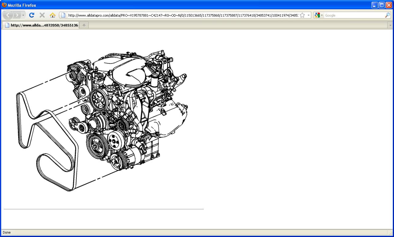

what is the belt serpentine belt routing for an 06 impala with a 3.5 liter engine?
Jun 18, 2020 at 7:12 AM (Merged)

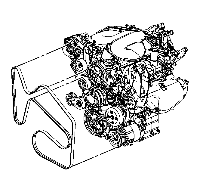

BLUELIGHTNIN6
  • 16,542 POSTS
Hello 3.5L Engine - 5.3 Liter is in the diagrams below
https://images.2carpros.com/forum/automotive_pictures/261618_GraphicCAS5A2TH_1.jpg
Install by starting at the generator, route belt around all pulleys except for tensioner. Rotate belt tensioner clockwise in order to release the spring tension. Install drive belt around the tensioner. This guide can help as well. https://www.2carpros.com/articles/replace-serpentine-belt Check out the diagrams (Below). Please let us know if you need anything else to get the problem fixed. Cheers

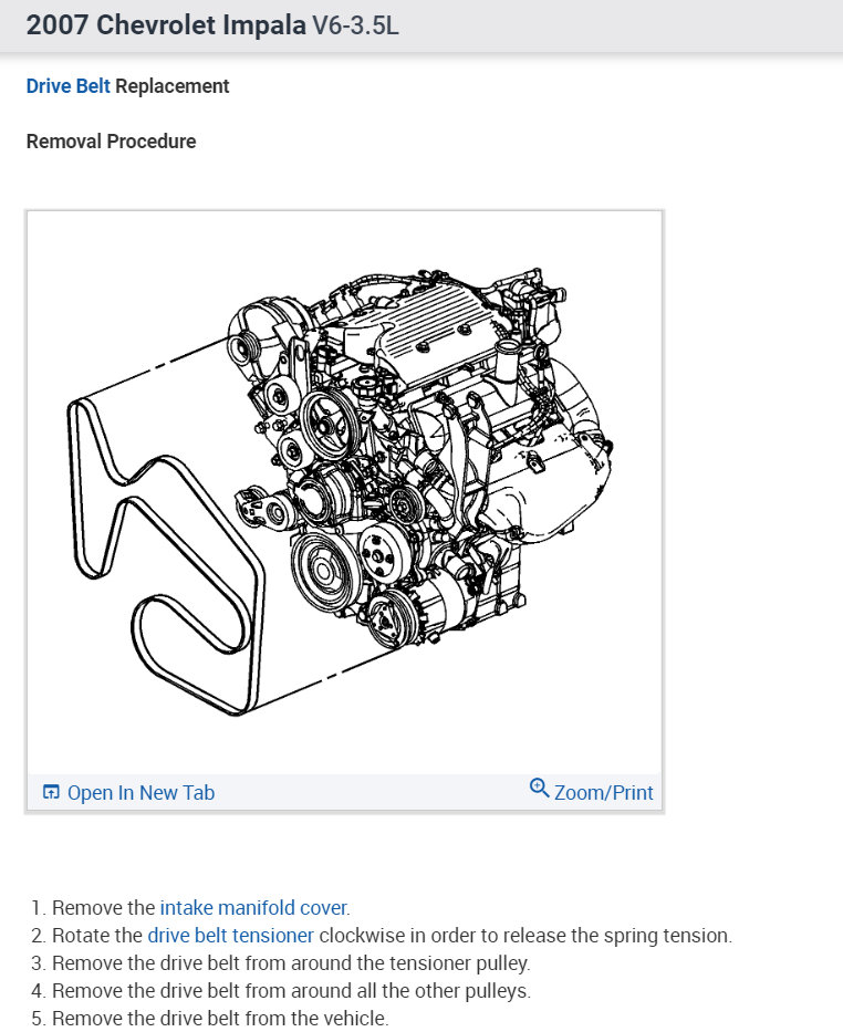

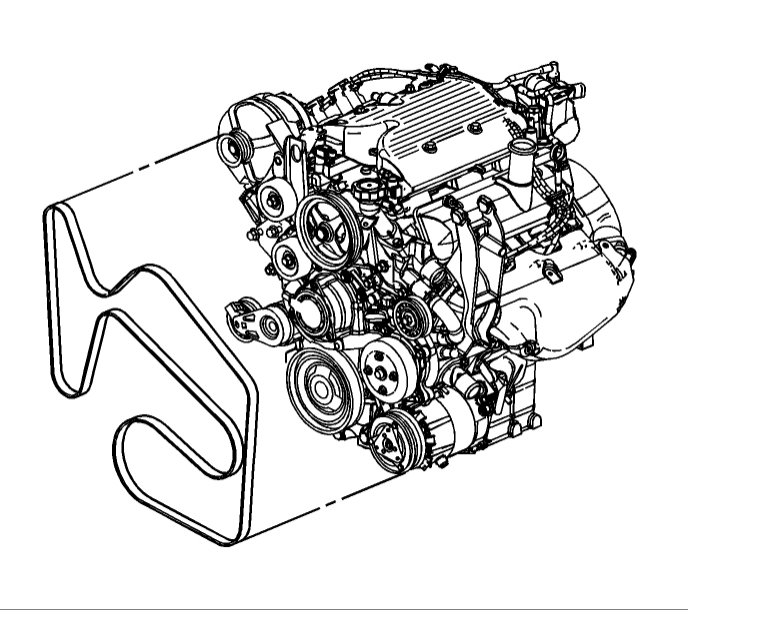

MDYKES3948
I need to change the belt on my car becasue I can see cracks. Can I get a diagram to put the belt back on? 3.5 engine Thanks! love this site.
BLUELIGHTNIN6
  • 16,542 POSTS
Here is a guide that will give you an idea on what you are in for when changing the belt:
Here is the diagram (below).
Cheers

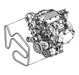

JIS001
  • 3,412 POSTS
I was looking at both 3.5L and 3.9L and looks to me like they are the same? Here is diagram for a 3.5L. And this one is 3.9L.
https://images.2carpros.com/forum/automotive_pictures/337695_39L_1.jpg
Hope this helps you?

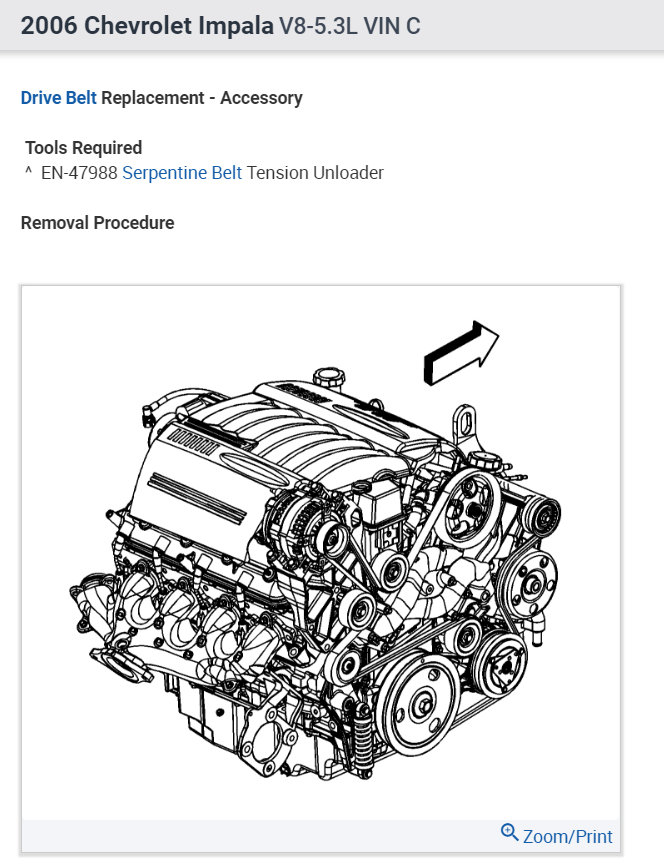

BEASLE1
I have a 2006 chevy impala and I need a serpentine belt diagram
SATURNTECH9
  • 30,868 POSTS
There you go.

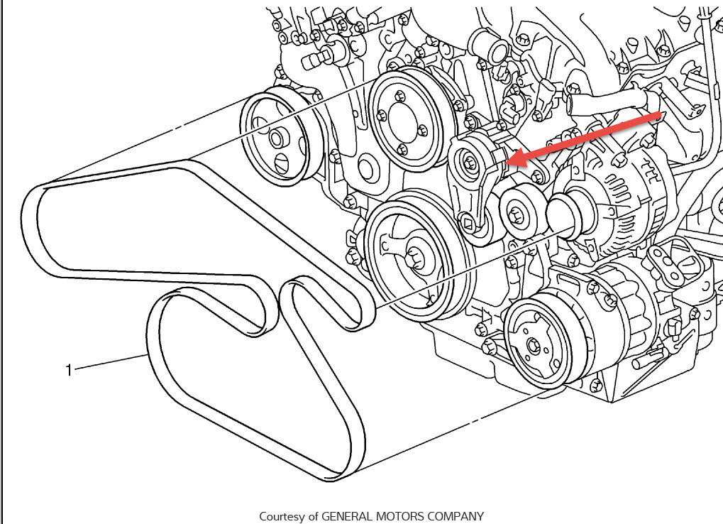

TSHORT82392
I need to replace my alternator, but I want to replace my serpentine belt also, I just need the diagram for it, as I cannot find it anywhere.
HMAC300
  • 48,601 POSTS
if you go to repair and service then diagrams it is right there. however, if you are replacing belt replace tension-er as well as it is worn out too. See picture.

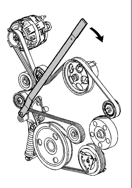

DARKMAN13
My serpentine belt broke and I was wondering where is the tensioned located at and what tool I need to loosen it up , is there a video that would show me ,
Jun 19, 2020 at 3:22 AM (Merged)
  • 110,251 POSTS
This guide should help walk you through the steps.
It is a different model GM vehicle, but should help.

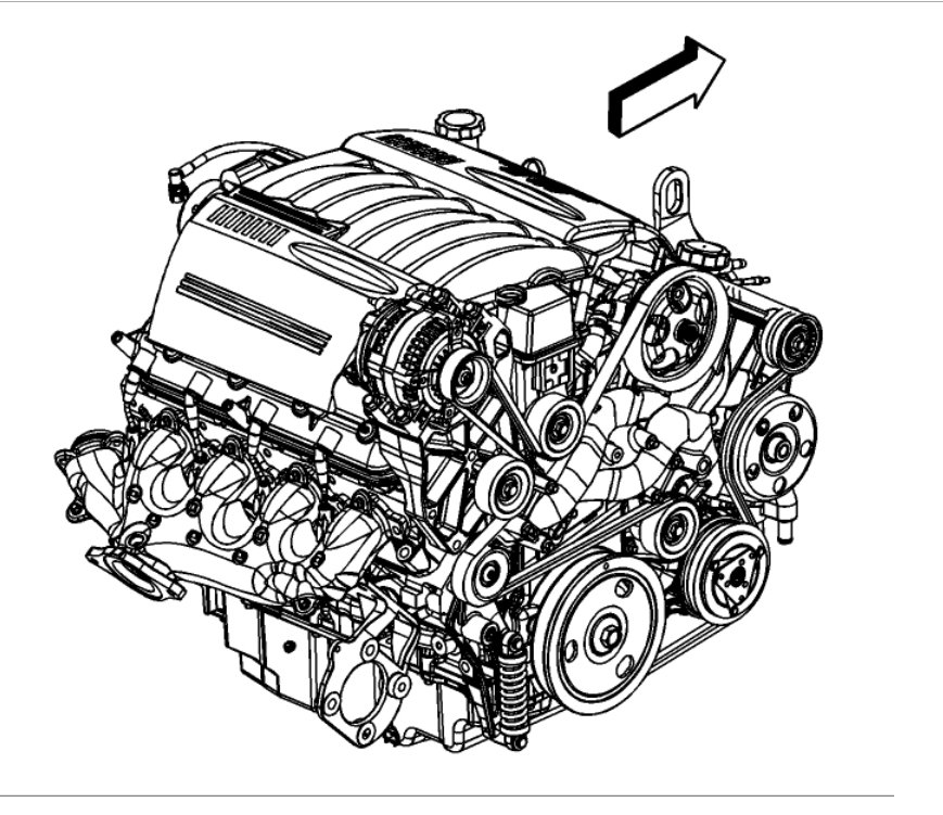

SCOTTX3
I have the SS model with a 5.3 liter engine. I am in need of a serpentine belt diagram since Chevrolet failed to put on on this vehicle.
What tool and size of the socket I need to perform this duty?
Love this site!
Jun 19, 2020 at 3:23 AM (Merged)
  • 55,770 POSTS
Here is a guide and some diagrams (below) to help you get the job done. This guide will give you an idea the diagrams will be fore your car.
This guide may help too.
https://www.2carpros.com/diagrams/chevrolet/impala/2004
More (below). Please let us know if you need anything else to get the problem fixed.

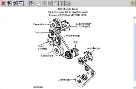

EAGLE1966
I need a diagram on how to put the belt back on. the engine is a 3.8
  • 75,988 POSTS
See below.
https://images.2carpros.com/forum/automotive_pictures/12900_belt_2.jpg
