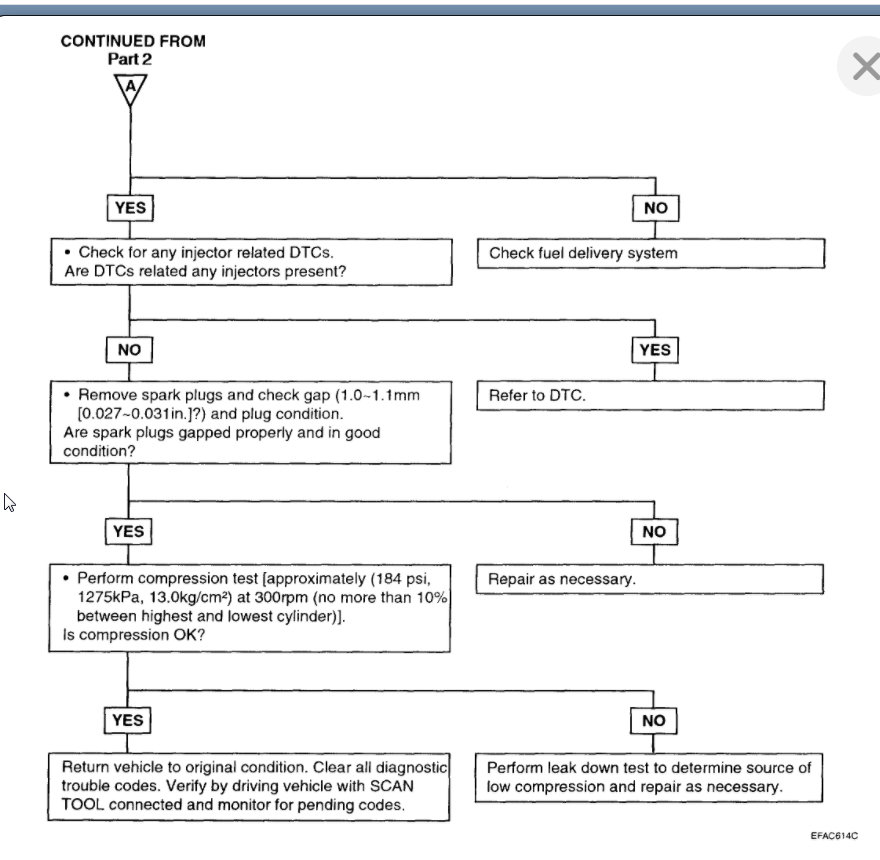

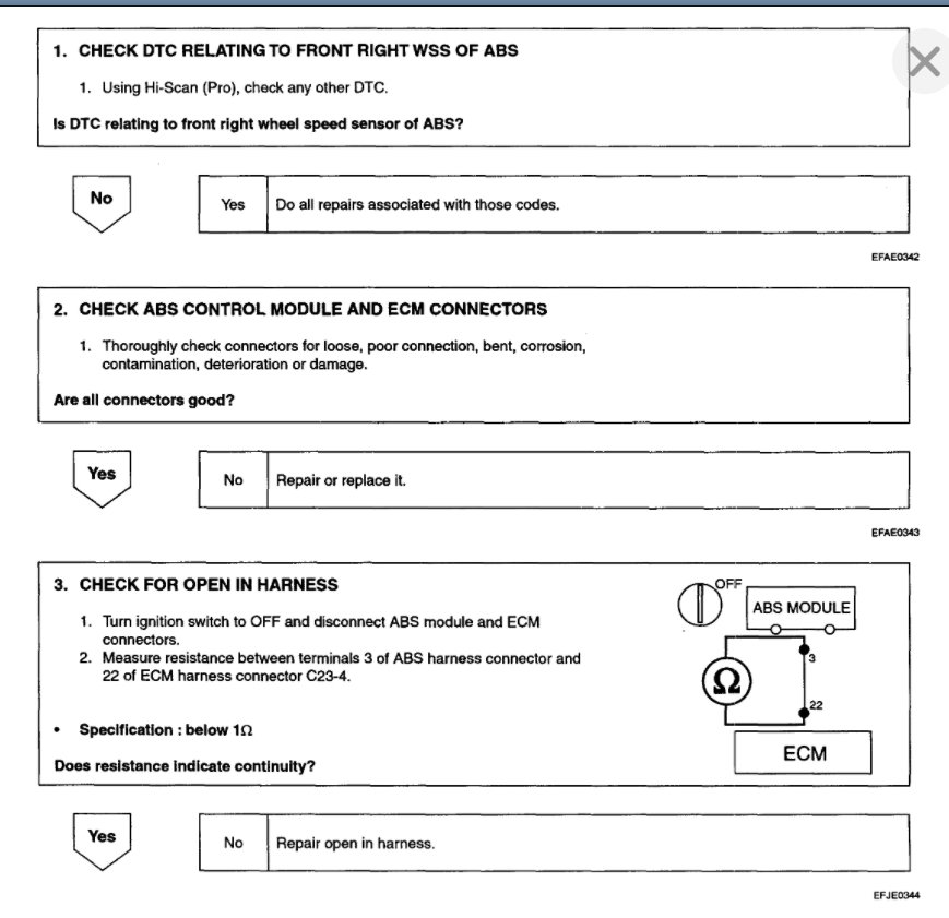

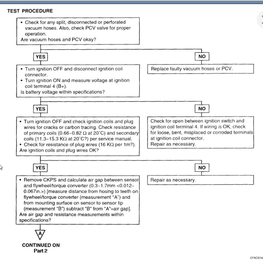

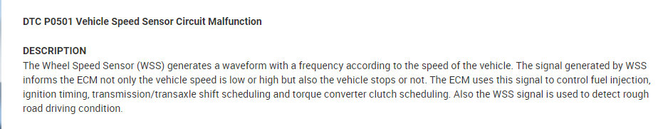

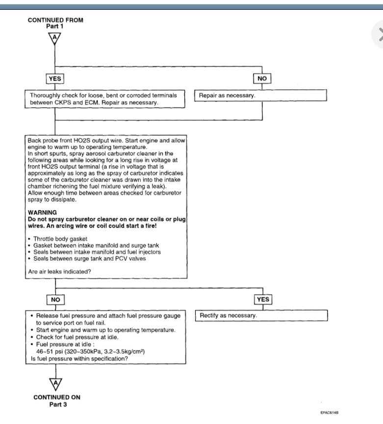

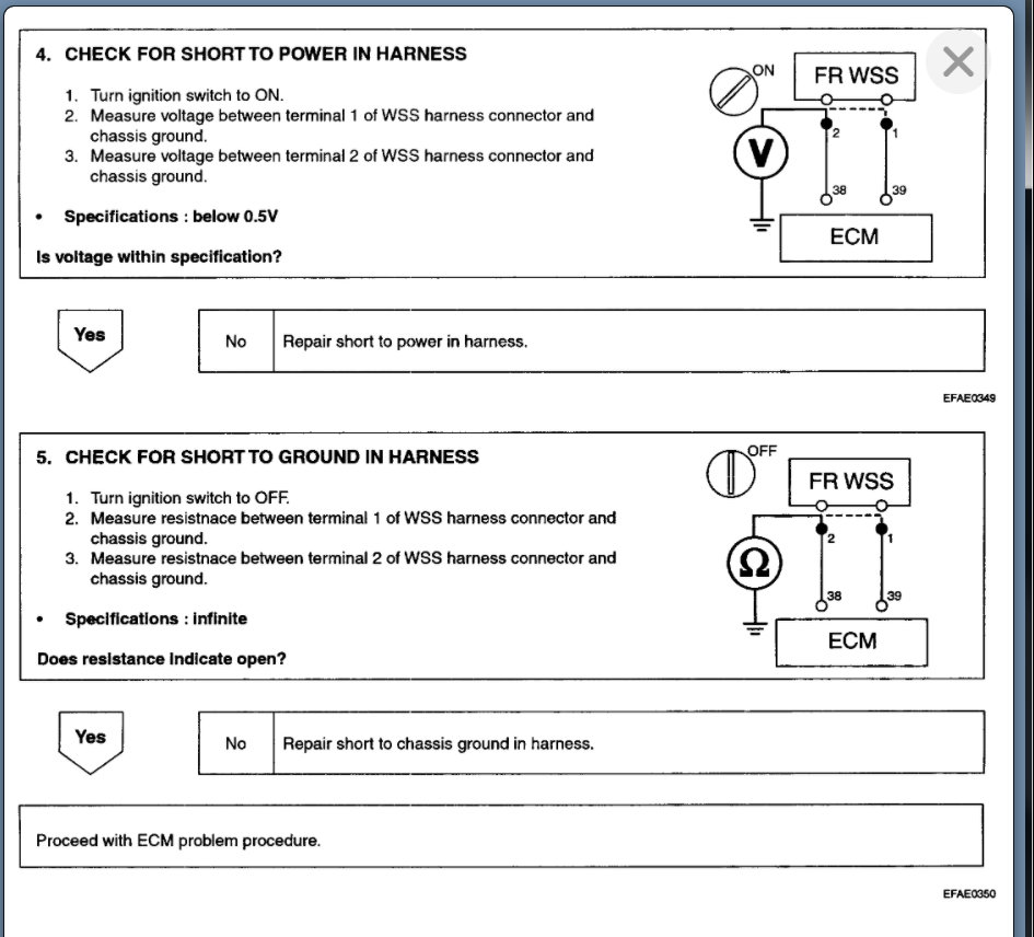

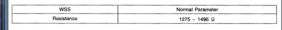

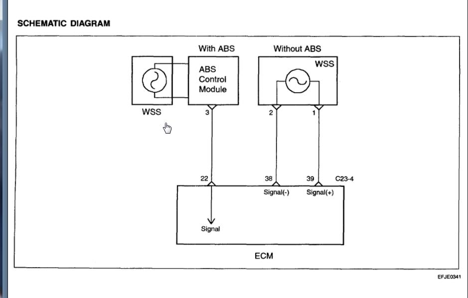

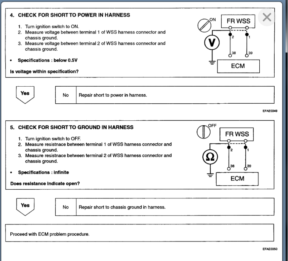

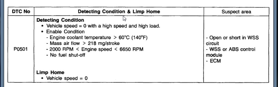

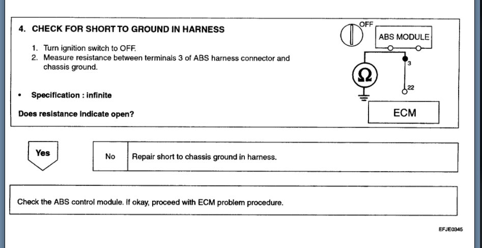

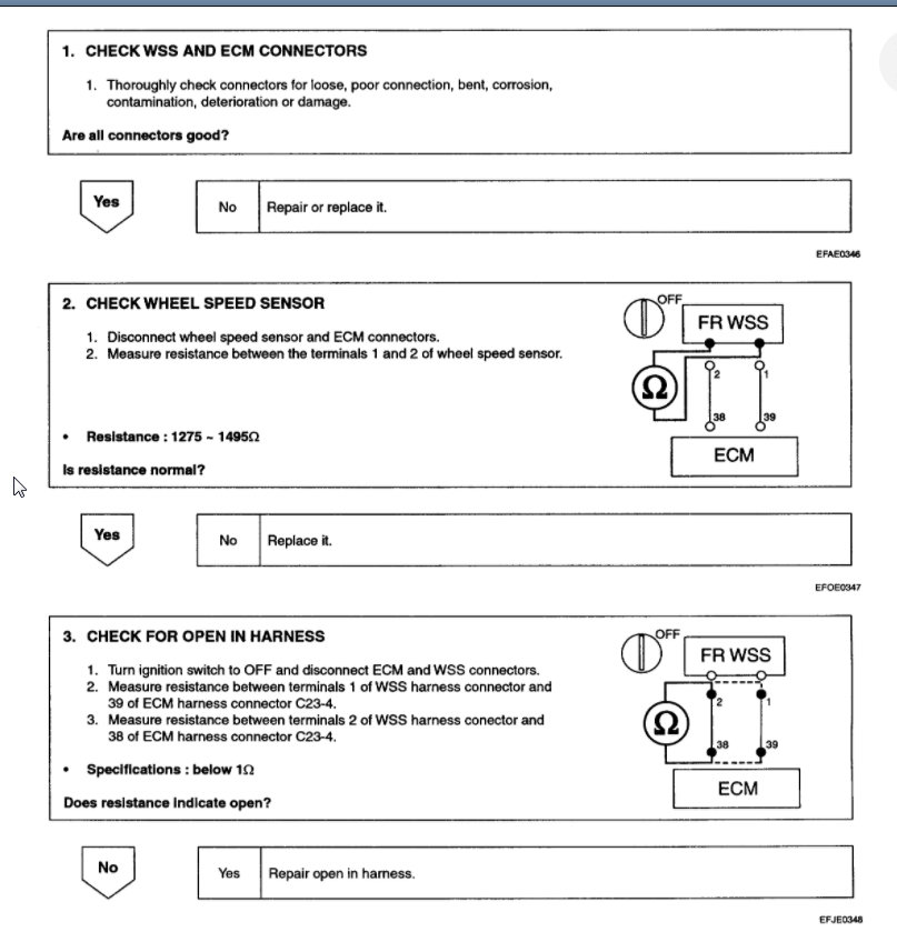

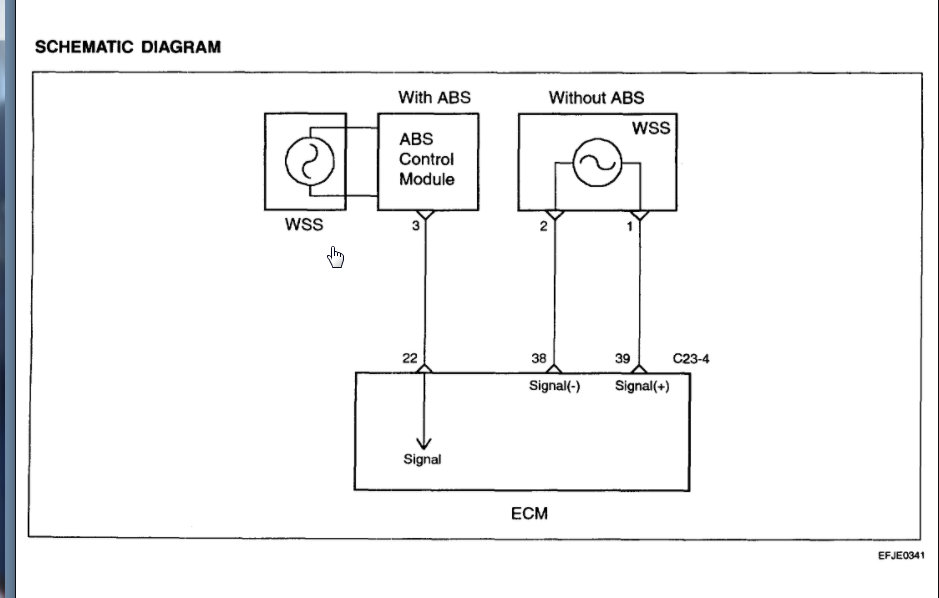

I am not sure if we have the same codes as the P0302 and P0501 are not for the cam and crank sensor.
I attached the info below for these codes and we need to run through both of these and figure out what the issue is. I suspect the speed sensor code (p0502) is causing most of the issues. However, you are not going to be able to just clear them so let me know what questions you have and we can go from there.
Thanks
