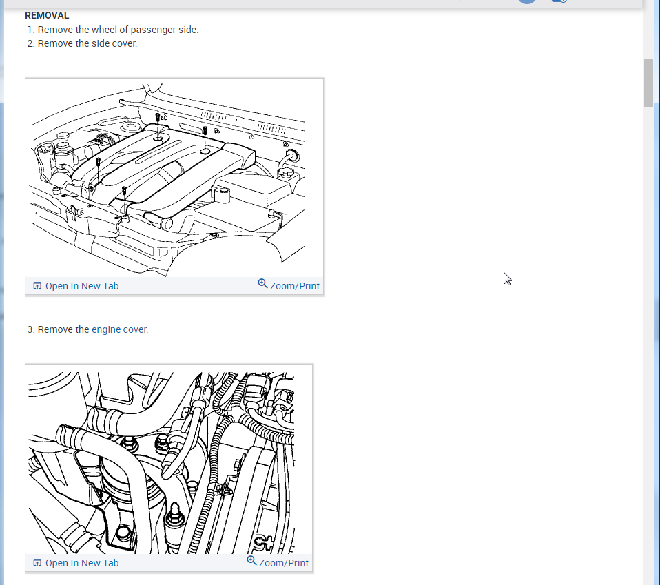

On my car, we were at a stoplight about to turn left and the car stalled out. It would not start right away, but after pushing it out of the way, about 10 minutes passed, tried to start again and it started. Went to a local car store and have them put on a free OBD-II and it came out with the code of P0341.
Is there a way this can be fixed by me or someone w/some general car knowledge or do I have to take it to the dealer to have this sensor replaced and the check engine light reset?

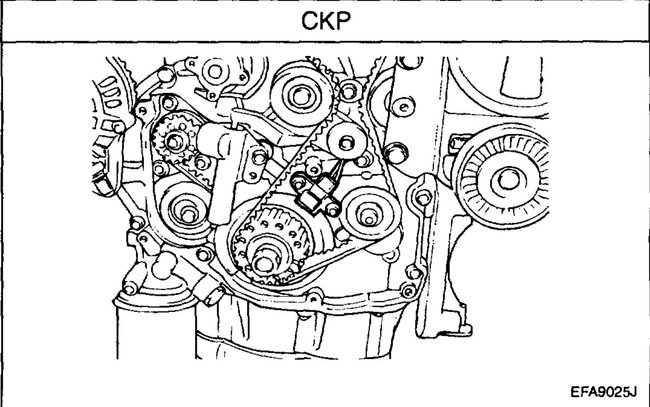

Patrick:

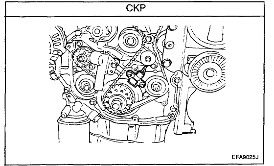

It is located behind the timing cover, you will have to remove all of the belts and brackets to get the cover off to replace it.
Check out the guide below, its not vehicle specific but it will give you an idea of whats involved
See the diagram below for the location of the sensor on your vehicle

I replaced the sensor yesterday, car still would not start, so had to take to shop and mechanic said I replaced sensor backwards, now he said he has to replace with another new one, would it short it out
if I put it on backwards?
Jan 23, 2019 at 8:55 AM (Merged)
BLUELIGHTNIN6
  • 16,542 POSTS
if crank sensor is installed backwards it damages the plate that is between the crank sprockets, that is why it will need replaced. the plate should have FRONT or REAR labeled on it..

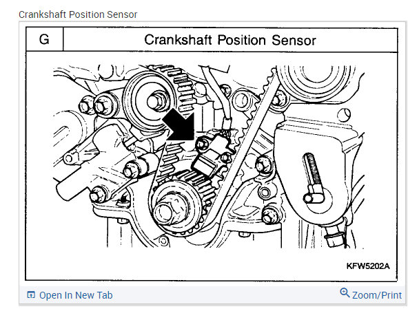

where is this sensor located on the motor and do you have a pic for the location.
KHLOW2008
  • 41,814 POSTS
Hi RobertJ0929, Sensor is located at rear of engine.
https://images.2carpros.com/forum/automotive_pictures/192750_Rear_OfEngine04SanteFe4cylFig69_1.jpg

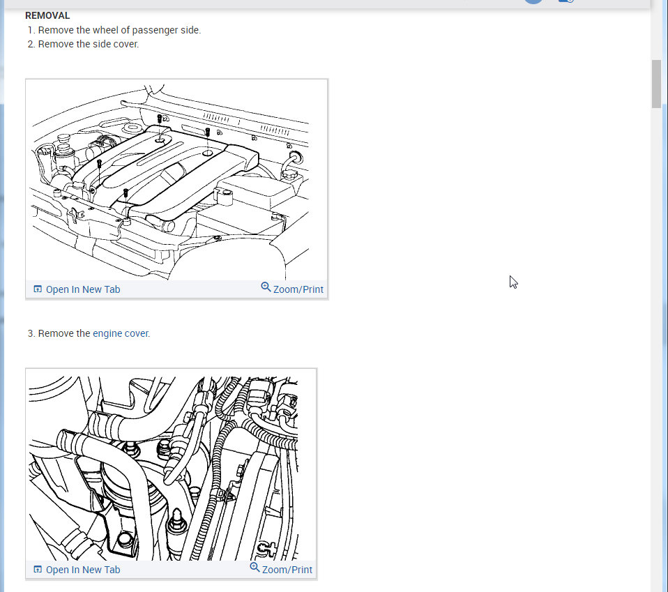

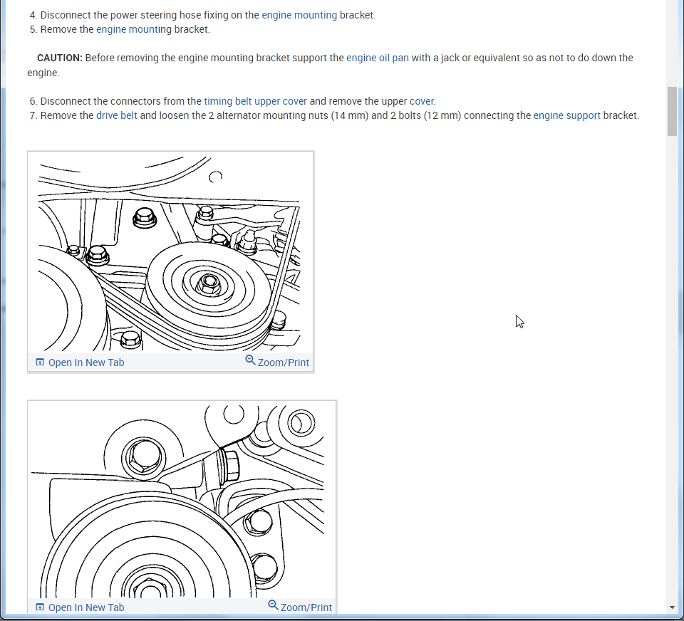

Here is a guide and a diagram to help you get the sensor changed out.
Cheers

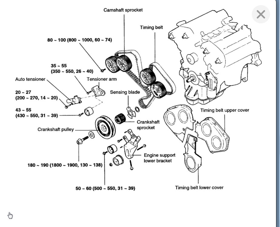

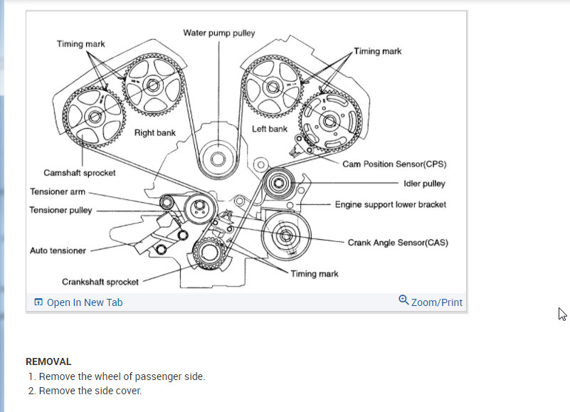

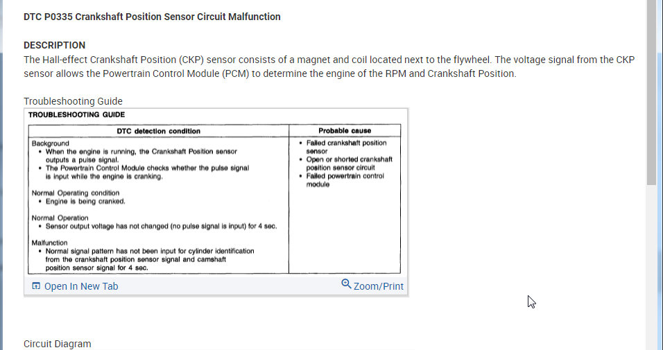

DONALD MCKEE
2003 Hyundai Santa Fe GLS 3.5l v6 2wd dual transmission showing code p0335. how do I get to it to replace it?
Apr 28, 2021 at 2:27 AM

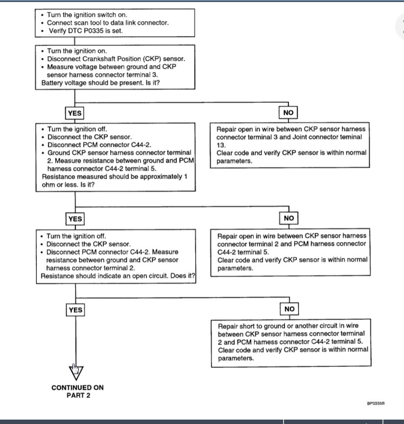

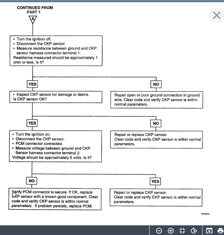

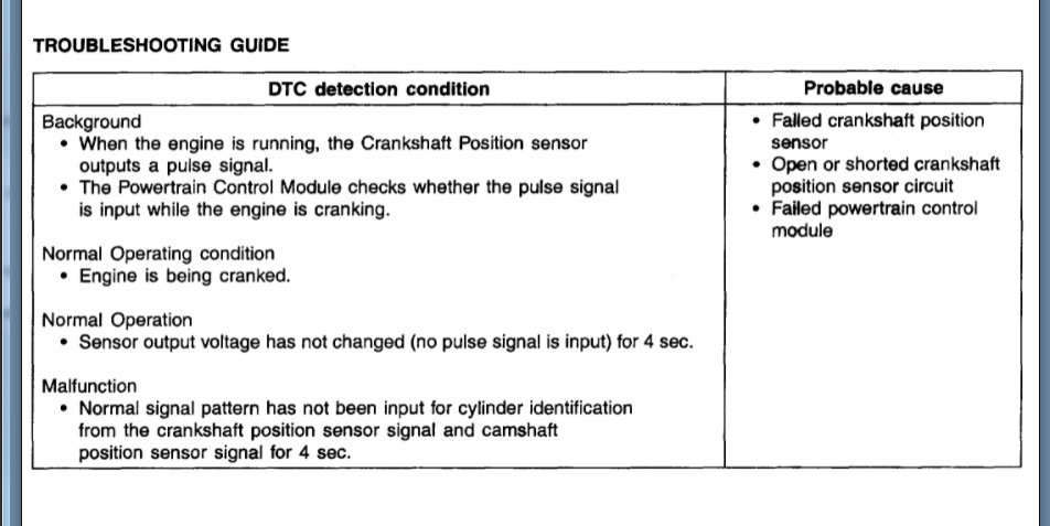

You need to remove the timing belt cover to access it. I attached the info below but before you do, I would run through the testing just to be sure this is the issue. There are other causes of this code and if you didn't need to remove the cover to get to it then it may be worth just taking a shot at it but I would not want to be wrong after doing this.
Please let us know if you have other questions. Thanks
