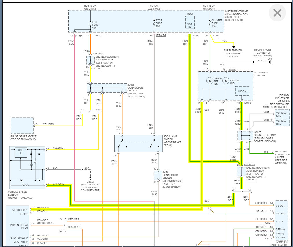

I need a diagram that explains what wire runs the speedometer and odometer.
Apr 11, 2022 at 1:05 PM

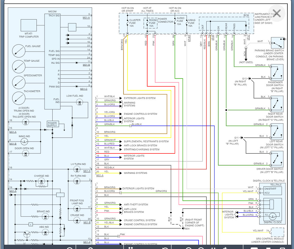

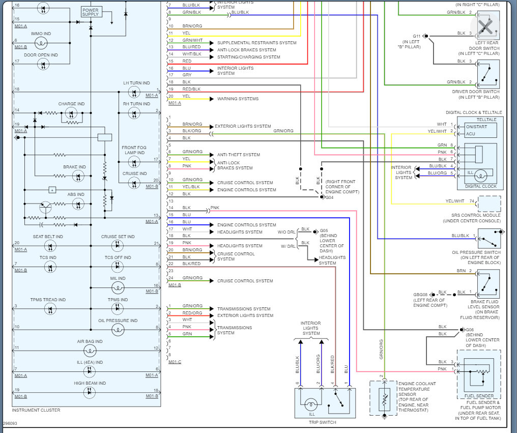

I am attaching the wiring diagrams on these systems. However, if you have an issue with the speedometer and odometer then let's start with checking for codes.
The only reason is the speedometer gets this signal from the ABS module, and it calculates the mileage based on this signal.
If there is an issue, then more than likely we have some codes so I would suggest we start with this.
Please see the wiring diagrams below and let us know what other info you need.
Thanks

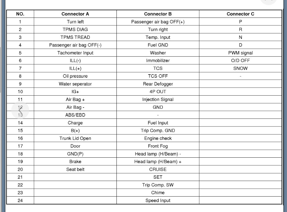

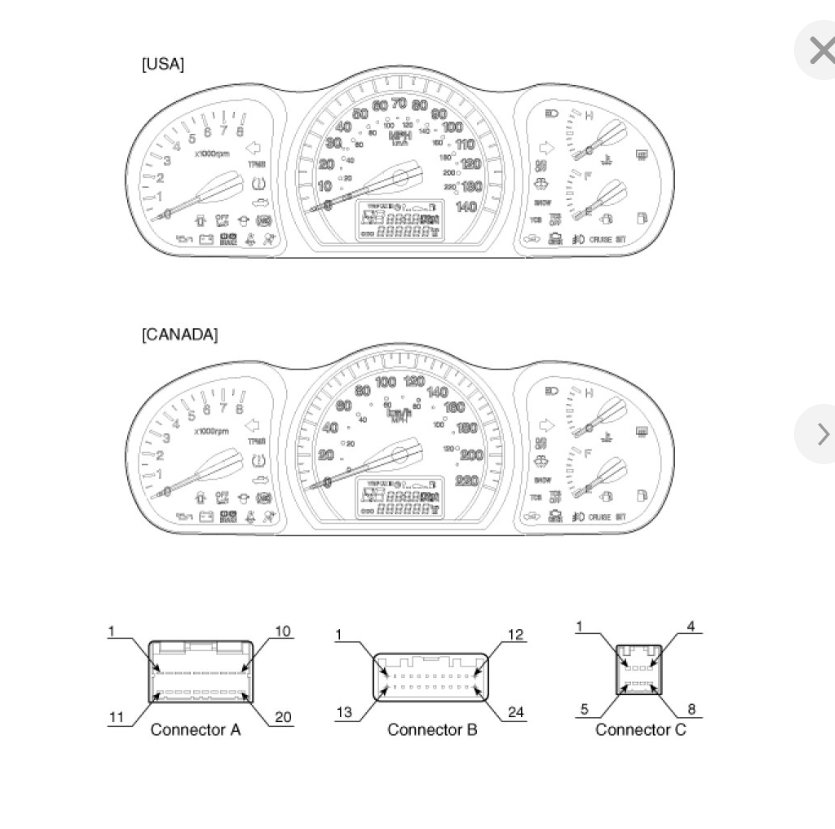

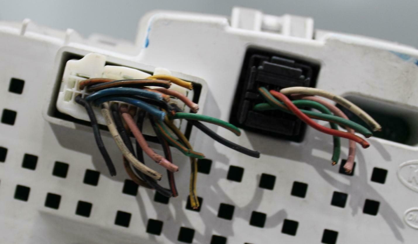

Okay. Connector c is on my cluster but there's no harness to it. The other two pins in your diagram marches mine. Now, I located pin 24 on the harness at the cluster and ran a continuity test from the cluster to the transmission speed sensor. I get continuity from the cluster to a connector in the kick panel, but i don't get it all the way to the transmission.
I get nothing at the ECM plugin. I don't get anything from the ECM to the transmission, or the cluster. I need to know the path the current takes from the Transmission to the cluster.
So, i can trace the complete circuit.

BTW, that green wire with the orange strip is the same color as the wire on the speed sensor. If you're looking at the front of the cluster that pin is bottom left. The 24 pin in the pic you sent is bottom right. Does that matter?
Apr 14, 2022 at 11:45 AM

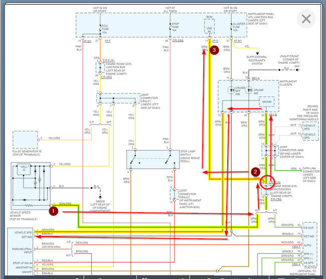

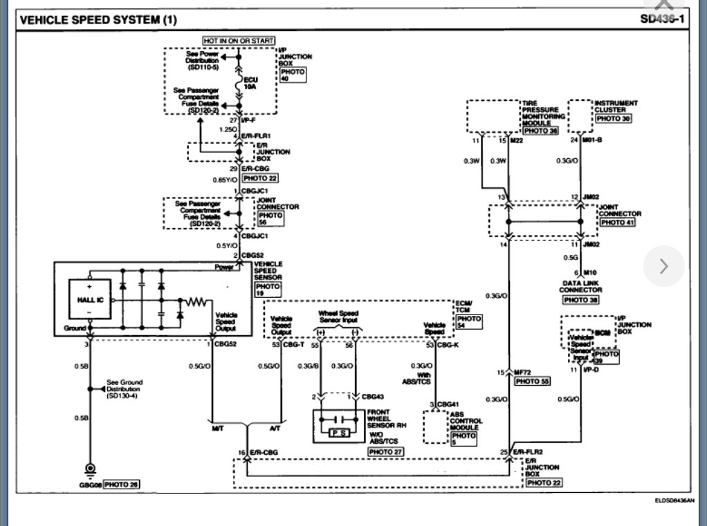

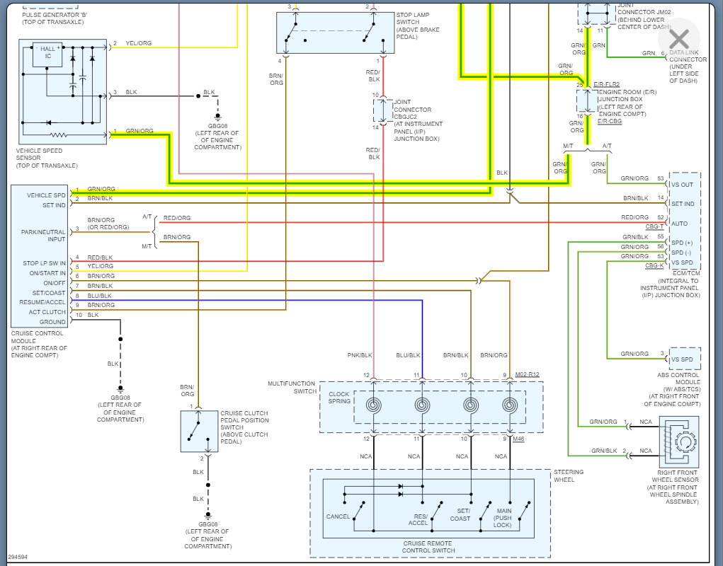

I am attaching the diagram below. Due to this being a Manual transmission it does not run to the ECM. Only auto transmission goes to the ECM/TCM.
If you have signal getting to the Cluster, then the cluster is the issue.
Apr 15, 2022 at 11:45 AM

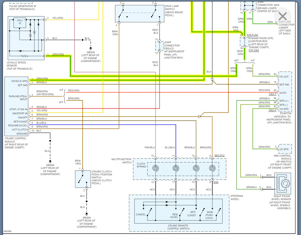

Can you show me the direction of flow? And does the transmission speed sensor need to be turning to get voltage at the cluster?
Apr 15, 2022 at 12:40 PM
Take a look at the diagram. There are two paths for this signal but they both start at the vehicle speed sensor.
Yes. These are signal circuits so if the vehicle is not moving then you likely have little to no voltage.
The circled location is the split but the path that is number is the one for the speedometer. The other is for the cruise control.
Apr 16, 2022 at 12:32 AM
RD66
  • 61 POSTS
So where is the speedometer in this diagram?
Apr 16, 2022 at 1:52 AM
I am not sure why they made the diagram this way but if you look at the cluster where it says VSS in, that is the input to the cluster for the vehicle speed. The "BCM" uses this to operate the speedometer.
If you look at the diagram of the cluster in my first response you will see where the circuits are going into a module that is within the cluster. Basically, this is a logic module that takes the input, converts it so that it can be displayed on the speedometer.
This is why if you have a signal on these circuits then the cluster is the issue.
Apr 16, 2022 at 9:34 AM

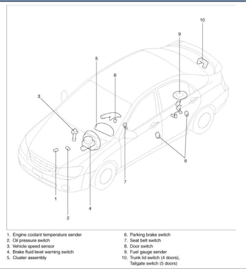

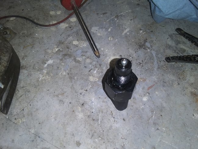

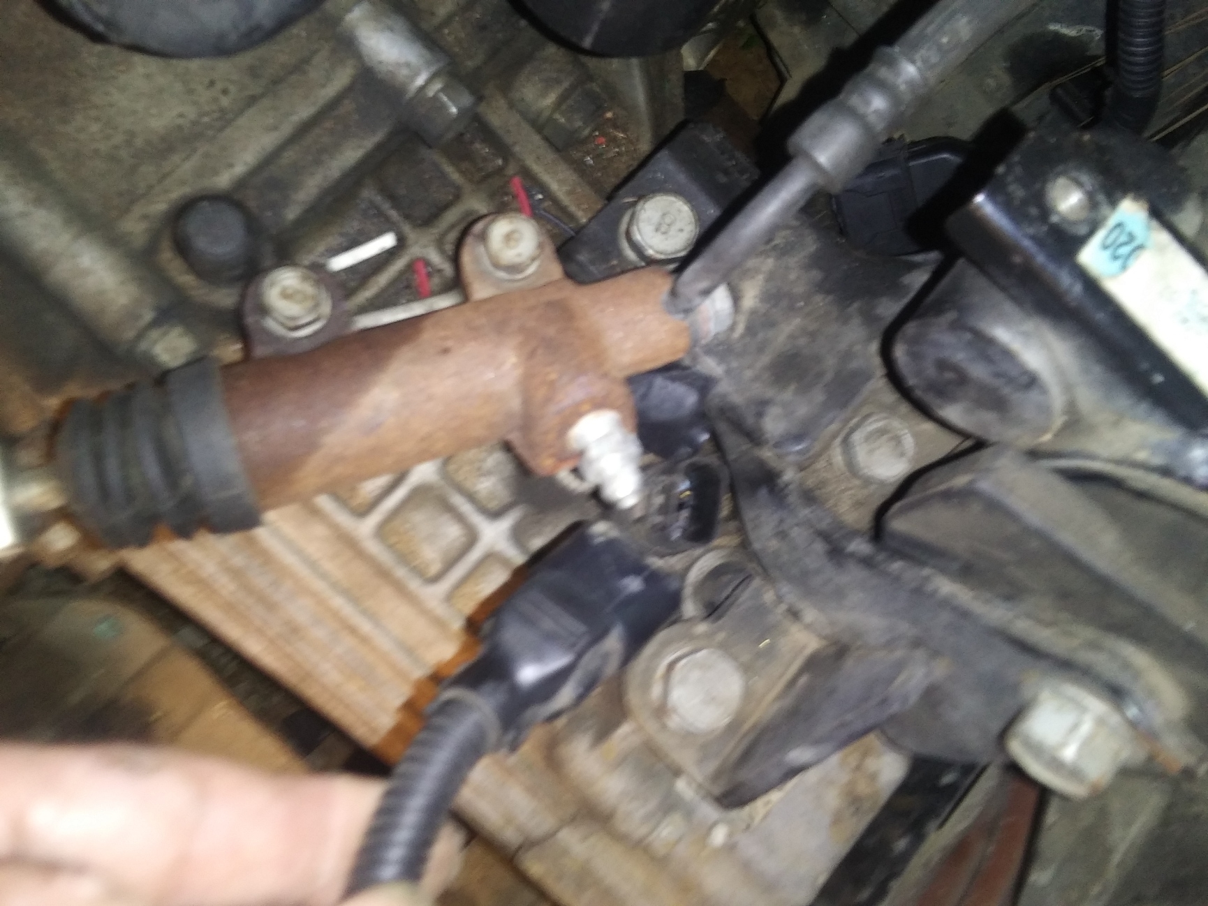

I understand. Let me ask you this: what is this sensor next to the clutch cylinder?
Apr 16, 2022 at 10:08 AM
RD66
  • 61 POSTS

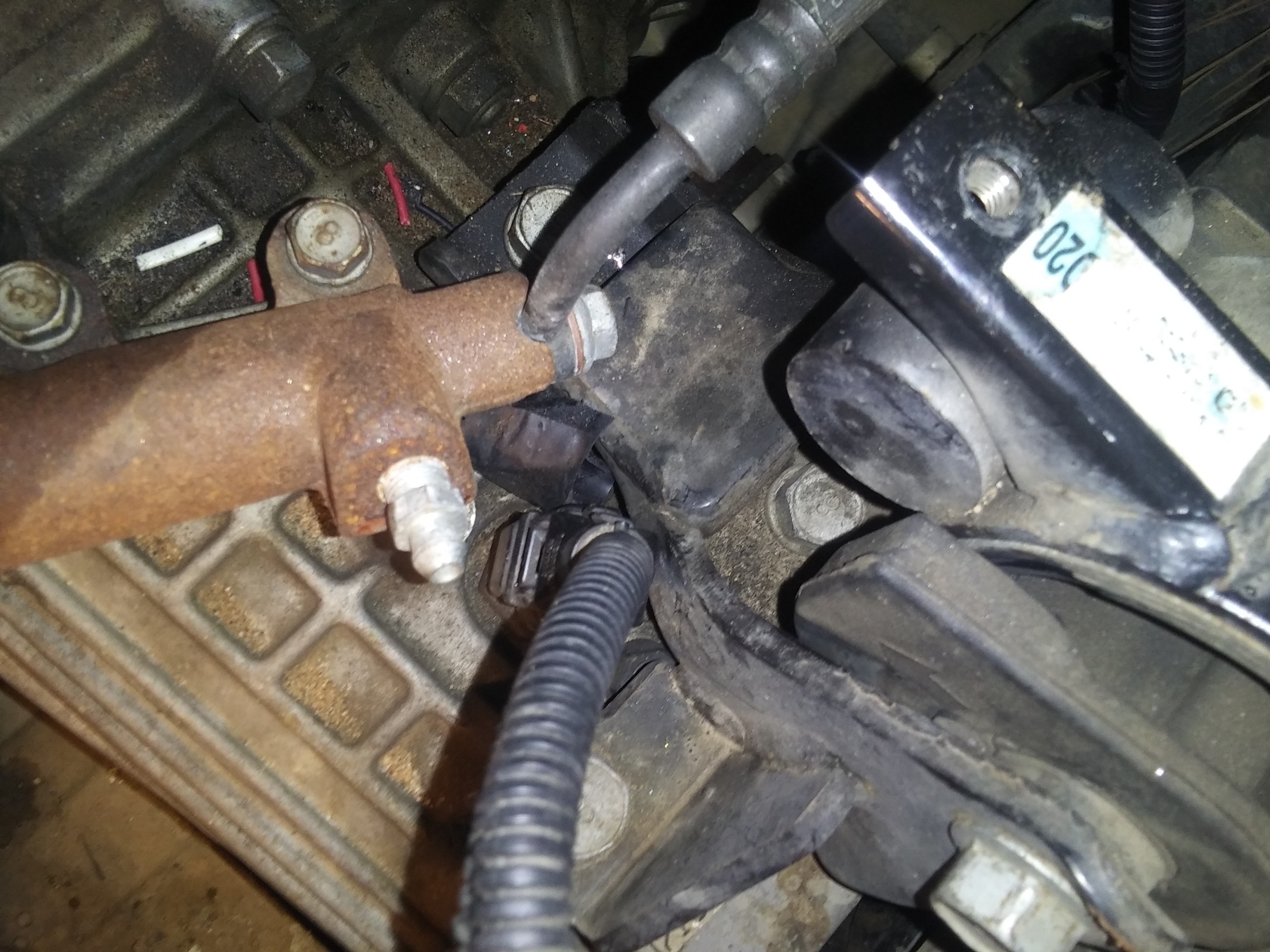

Hers another view.
Apr 16, 2022 at 10:18 AM
Hard to say. It looks like the location of where the vehicle speed sensor should be.
I would have a better idea if I saw the actual sensor removed from the unit.

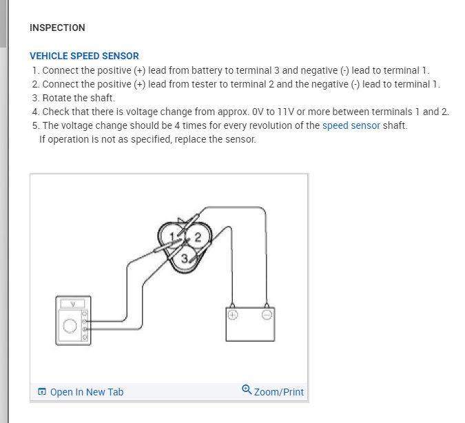

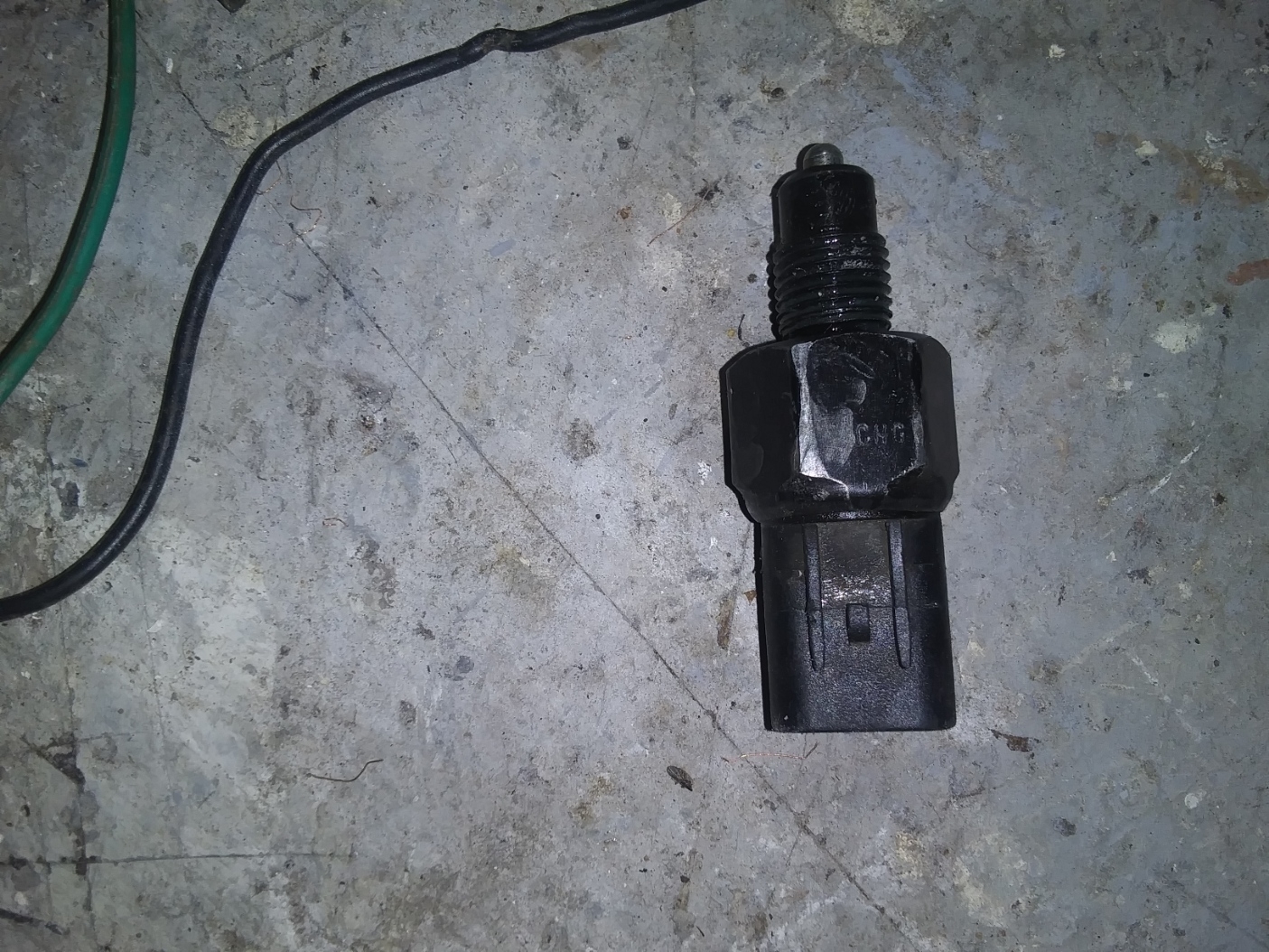

The speed sensor is on the back side next to the firewall. Does manual transmission have an input and an output sensor? The one on the back has three wires, the one in front has 2 wires. On a different note, I have an Evap code PO453 Evaporative Control System Pressure Sensor High Input. I tested the pressure sensor, I'm getting 5 volts to it. and i probed the yellow wire and got 2.5 volts, but when i added vacuum, the reading went up instead of down. It's supposed to go down, right?
Apr 16, 2022 at 11:40 AM
RD66
  • 61 POSTS

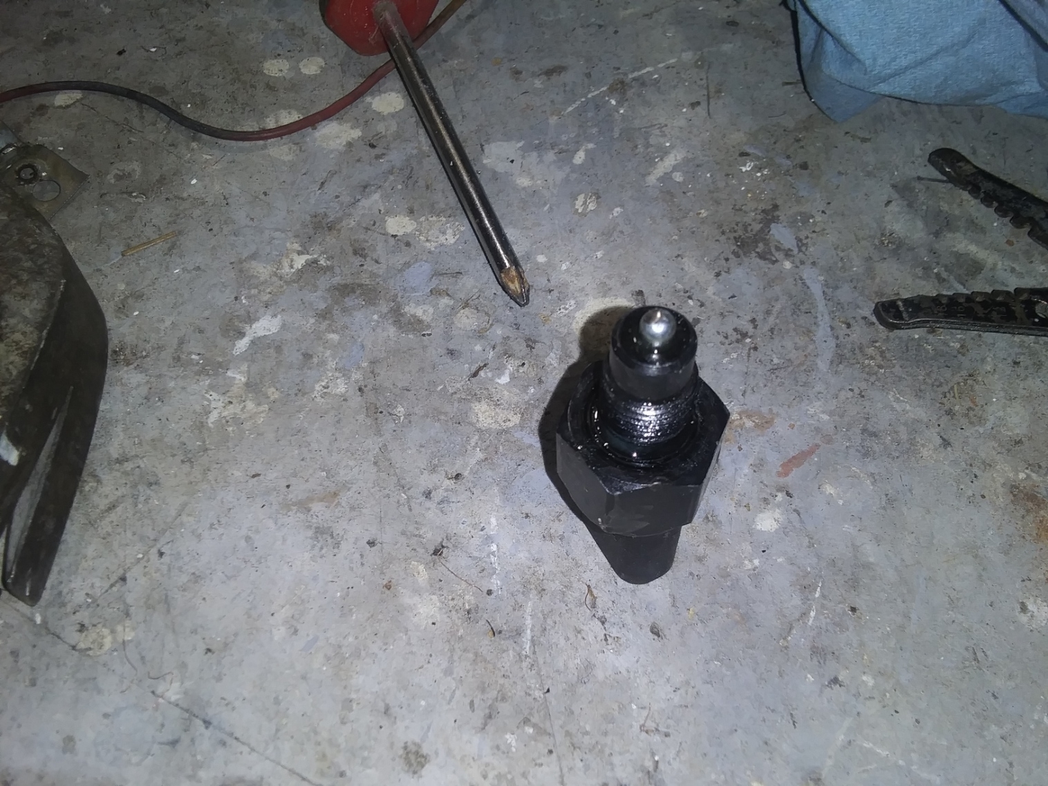

It's the backup light switch.
Apr 16, 2022 at 2:32 PM
Great job. Yep. Manual does not have input and output, but you got it.
Thanks for the pictures. That really helps others in the future that view this.
