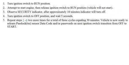

Passlock is an injector disable if problem with security system? Below is a relean procedure, don't know if it will help?
https://images.2carpros.com/forum/automotive_pictures/512072_passlock_relearn_2.jpg

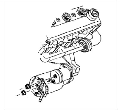

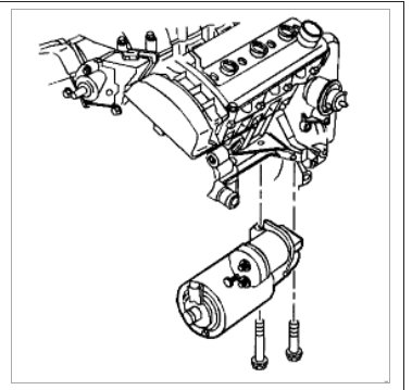

Check connections to starter, If OK, then remove starter and have it bench tested at any autoparts store, If OK, then the ignition switch or neutral safety switch is most likely culprit.

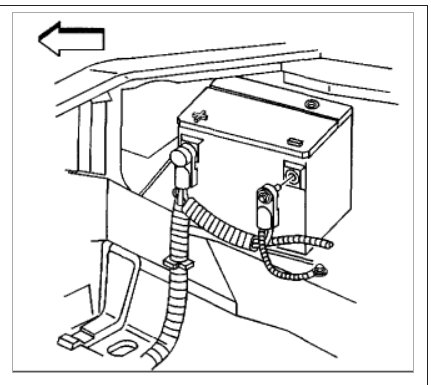

This sounds like it could be the starter or positive battery cable. What happens is corrosion develops and causes the starter to not get the amperage it needs to work correctly. Here is guide to help you see what you are in for when doing the job:
Here is how it will be for you on your car (below).
