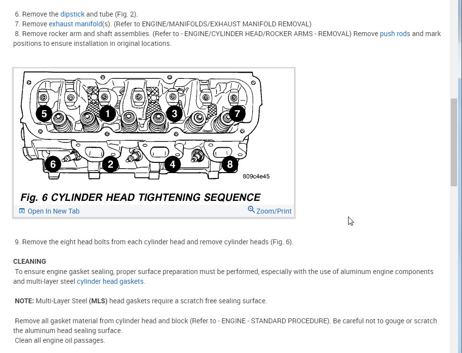

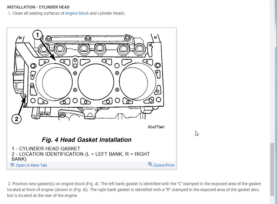

Unfortunately, this may be a head gasket. I have seen a number of times that the head gasket allows combustion chamber gases into the coolant when it gets hot.
The way to test this is when it starts to overheat you need to test for combustion gases.
I hate to say it but normally these hard to find and duplicate overheating normally always comes back to the head gasket.

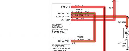

Car is overheating; however, the fans are not running. Where are the fan relays or controls?
Nov 18, 2020 at 12:37 AM (Merged)
  • 75,992 POSTS
Start by checking fuse no.24 40amp in the PDC and then the relay-see below
