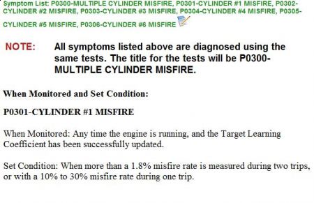

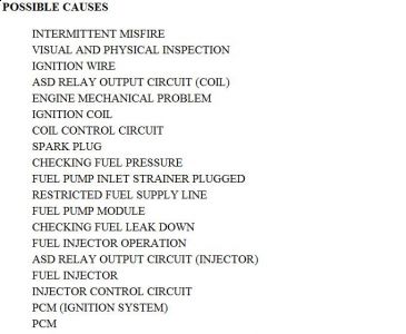

https://www.2carpros.com/forum/automotive_pictures/55316_04tcp0300_1.jpg
https://www.2carpros.com/forum/automotive_pictures/55316_04tcp03002_1.jpg

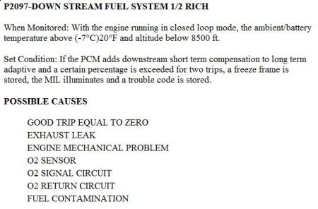

https://www.2carpros.com/forum/automotive_pictures/55316_04tcp0522_1.jpg
https://www.2carpros.com/forum/automotive_pictures/55316_04tcp2097_1.jpg
https://www.2carpros.com/forum/automotive_pictures/55316_04tcp20972_1.jpg
There is a TSB about rough idle and P0300 - P0306, involving re-programming the PCM.
https://www.2carpros.com/forum/automotive_pictures/55316_04tctsb_1.jpg
You may want to cal your Chrysler dealer and inquire about the TSB to see if that applies to you.
