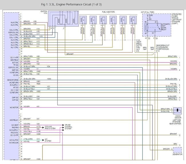

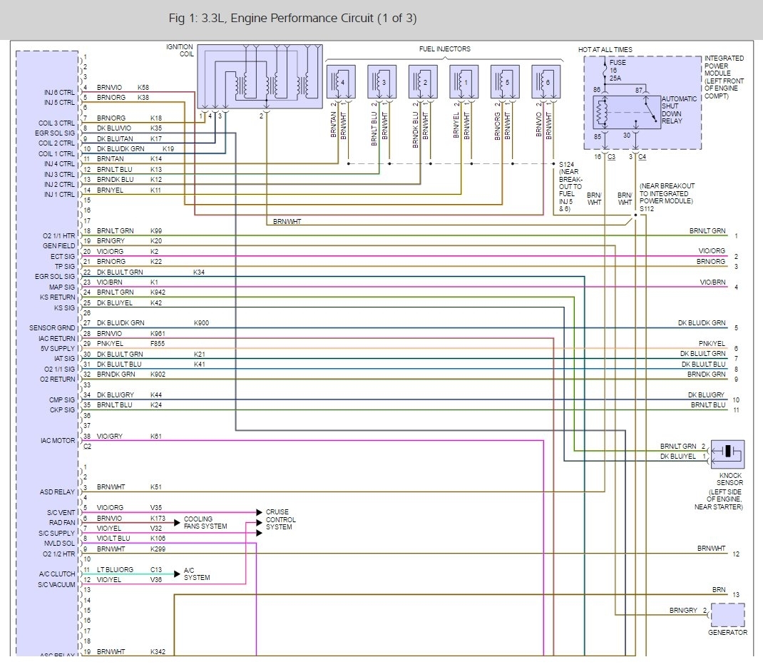

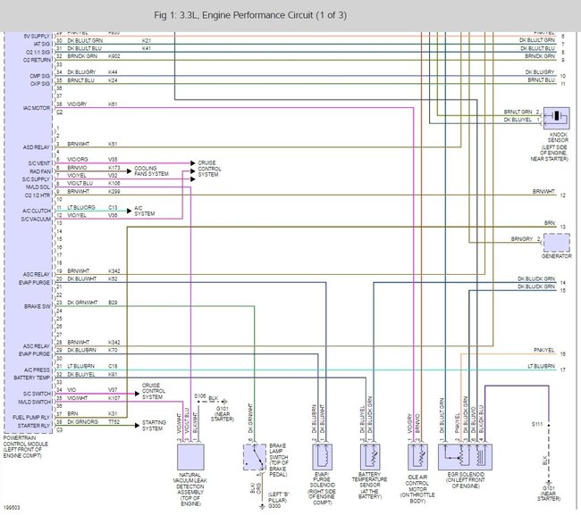

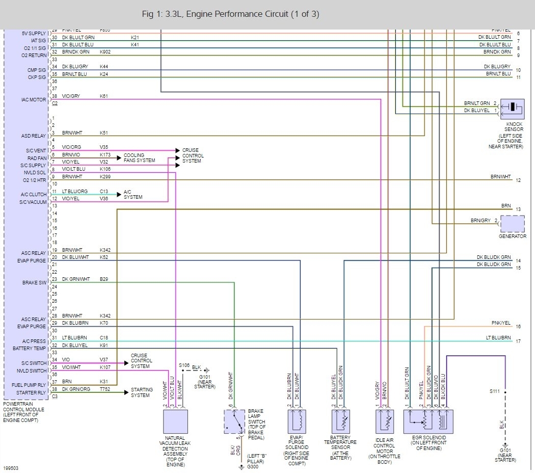

The first thing that comes to mind is the crankshaft angle sensor. Even when this sensor fails the computer cannot tell there is a problem. It is difficult to test these sensors without an oscilloscope while in driving conditions.
It would be best that when the engine stalls or doesn't start if you can see if the spark or fuel injector pulse fails. Also these vans had a problem with the ASD relay.
Here is the location of the relay and a guide to test it
Please run some tests and get back to us so we can continue helping you.
