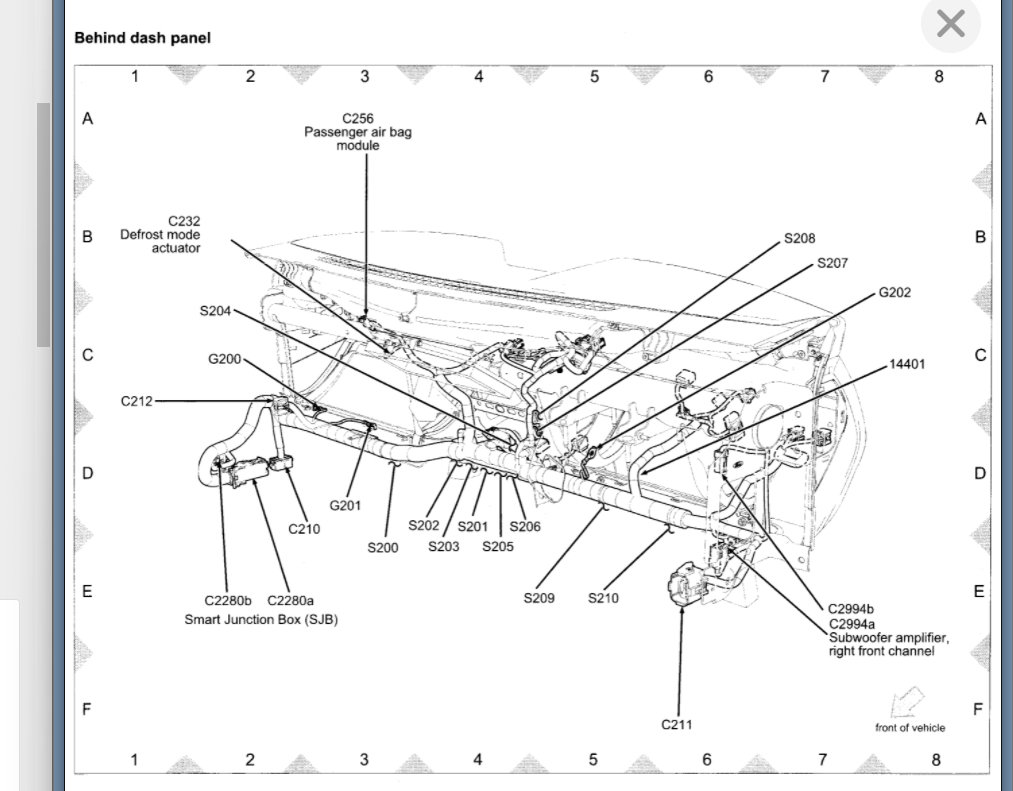

Defrost seems to be blowing from under the dash
2007 FORD MUSTANG
140,000 MILES
SEANWC
When I turn on the defrost it only sends to come from under the dash.
Nov 27, 2021 at 11:42 PM
This sounds like we have a mode door issue.

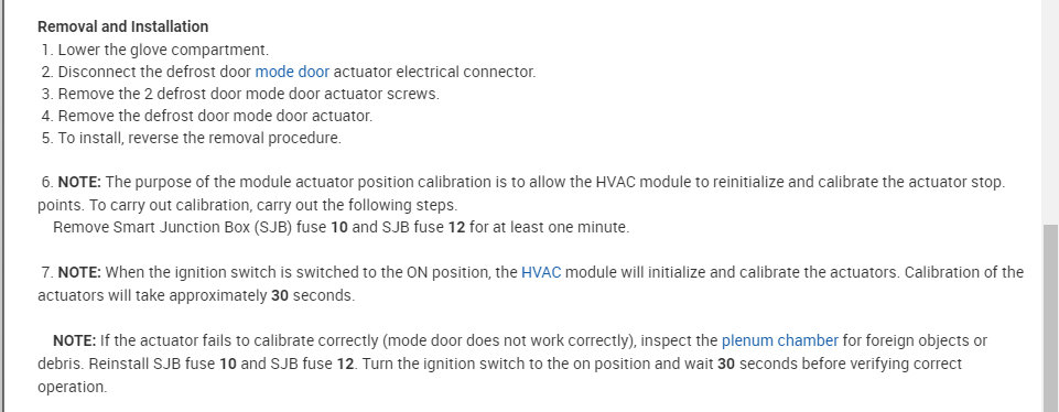

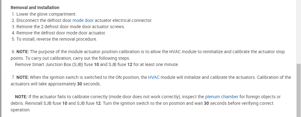

Here is a guide that talks about this. It is slightly different, but the actuator is the same.
https://www.2carpros.com/articles/air-vents-stay-in-the-defrost-position

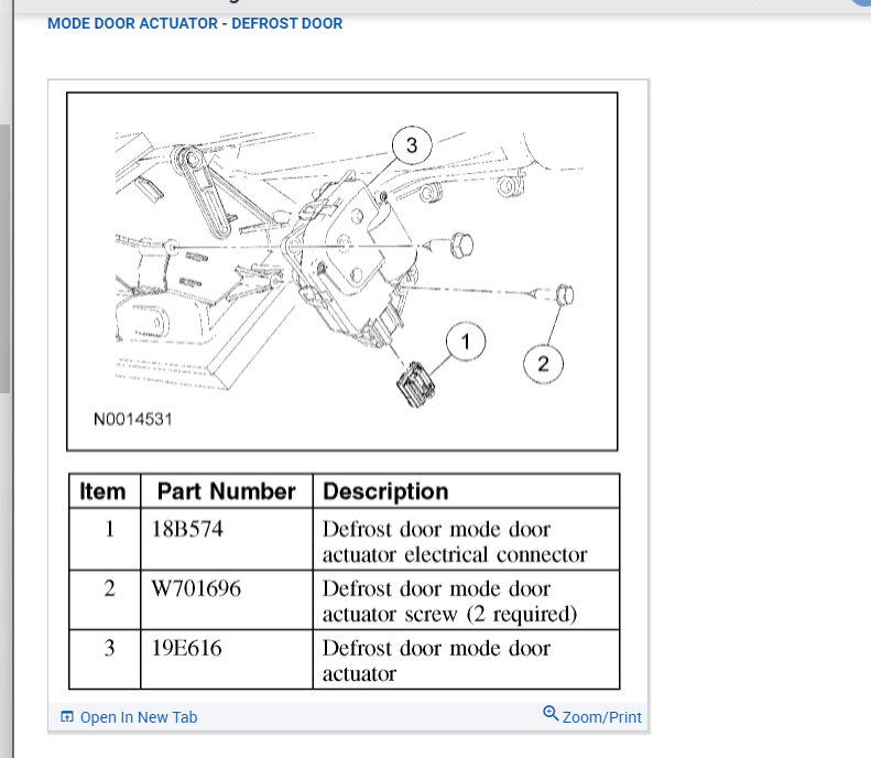

Your vehicle is slightly different in that you have a couple mode door actuators. One is for the defrost and the other is for the panel/floor.
So, if you are only getting air out of the floor this would mean the defrost actuator is most likely the issue.
So, if it were me, I would be replacing this one that I am attaching below.
Please run through this and let me know what you find with this, and we can go from there.
