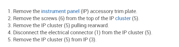

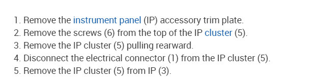

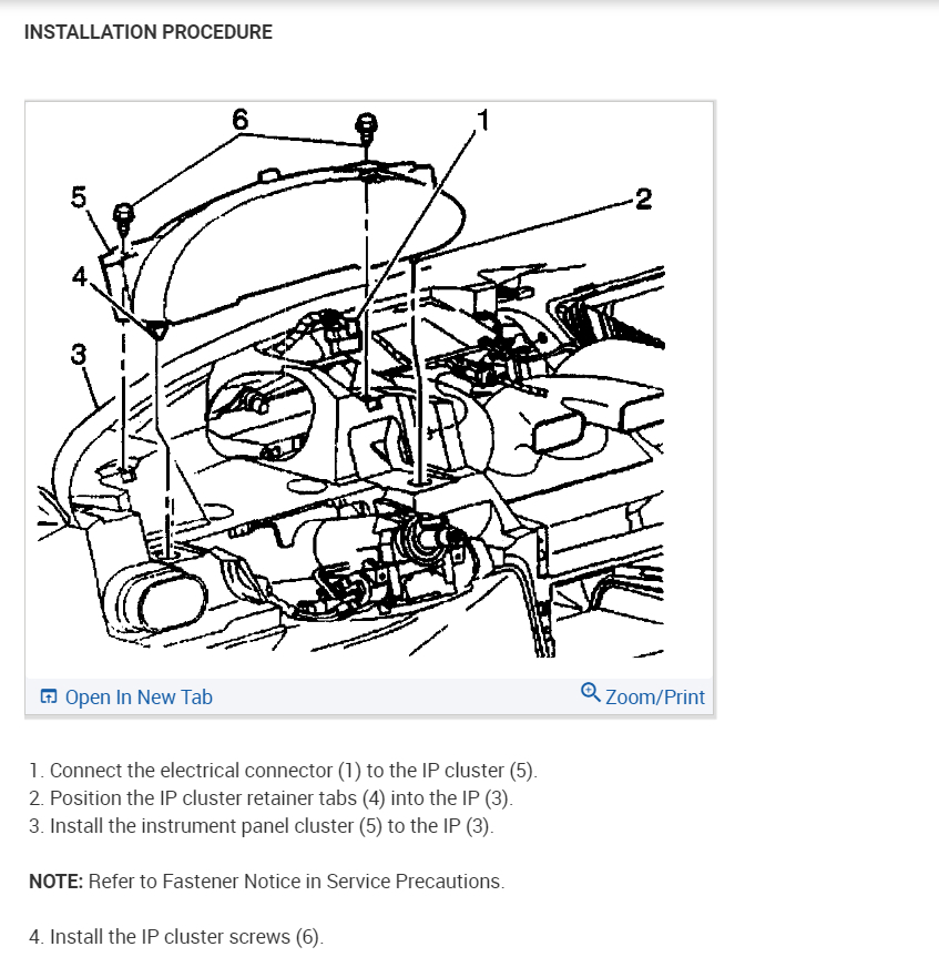

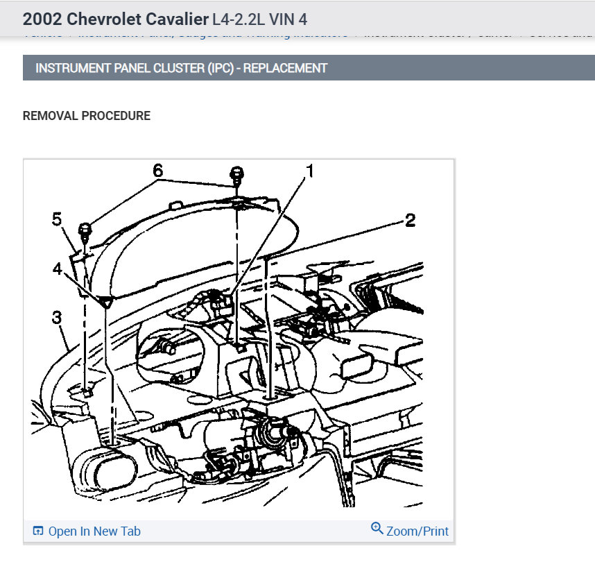

Which lights are they can we get more information on the problem please? It sounds like the cluster has gone out, but I would check all fuses first.
Here is a guide to help:
Here is how to change the cluster out in case you need it. You can get a preprogrammed unit by searching Google or Ebay. Check out the images (below). Let us know what happens and please upload pictures or videos of the problem so we can see what's going on.
