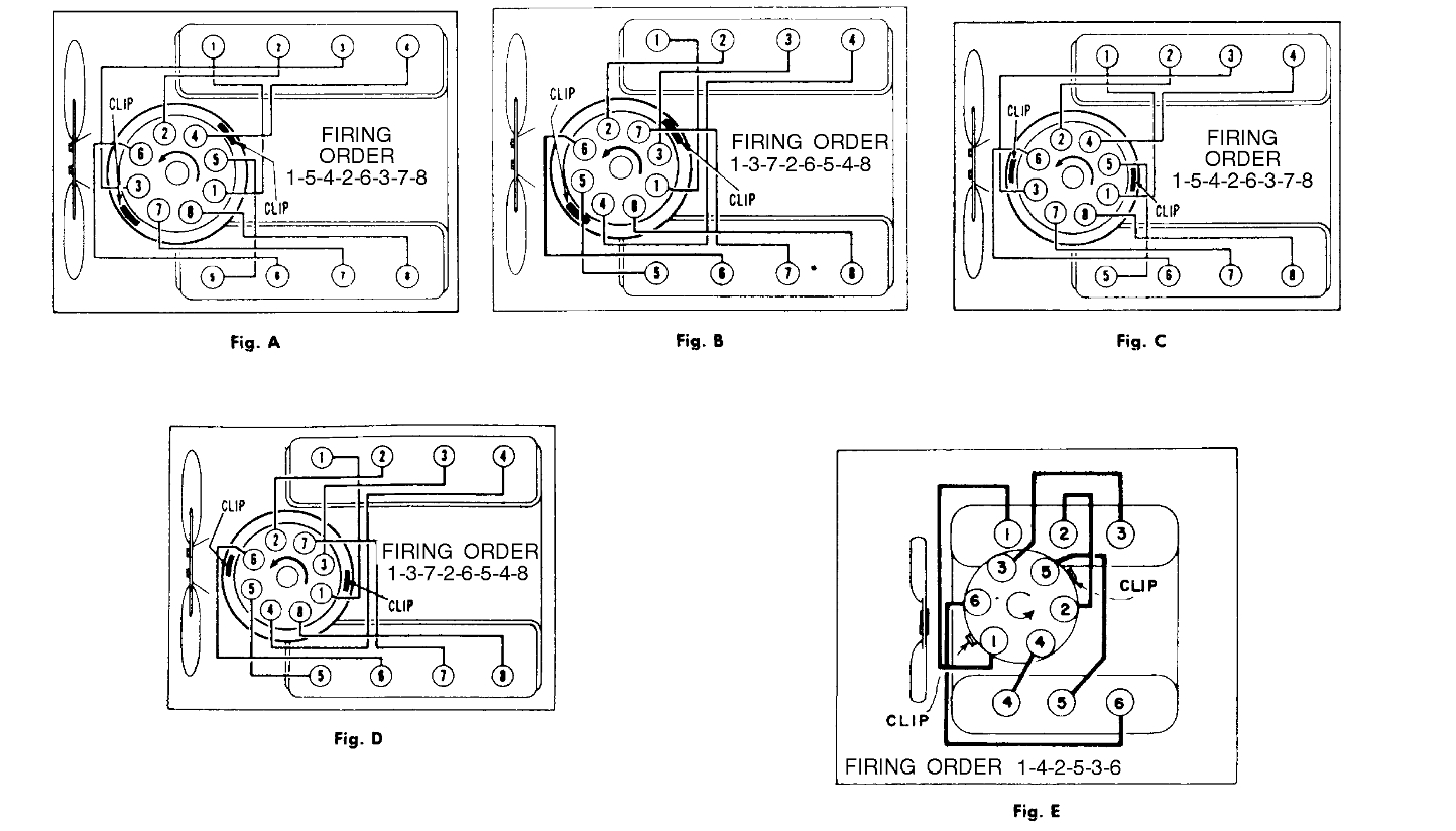

Fe 390 brand new I just want to get the engine running. It has HEI red cap distributor. I can't get any fire it has juice and gas and it'll crank. Dash wires and engine wires' mixed-up plugs missing.

This might help, it is hard to say what you need maybe you can upload some images of the problems so we can help. Check the plug wire firing order in the images below.
