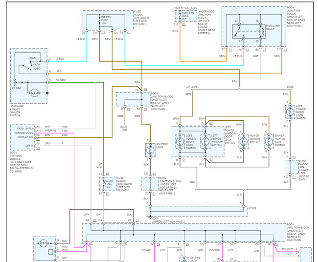

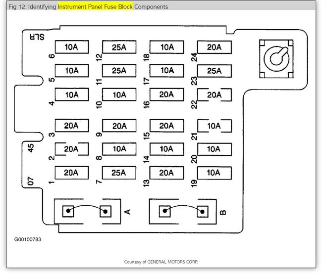

My Dash lights won't work, but when I roll the dimmer all the way up and the cab lights come on the dash lights light up. I've checked some fuses that I think go to the dash they all work and have even tried replacing the switch and dimmer box and that hasn't worked. What else could be wrong?

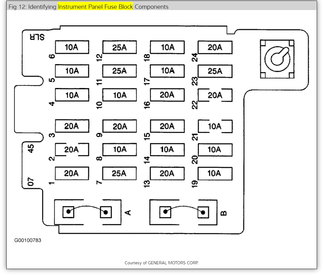

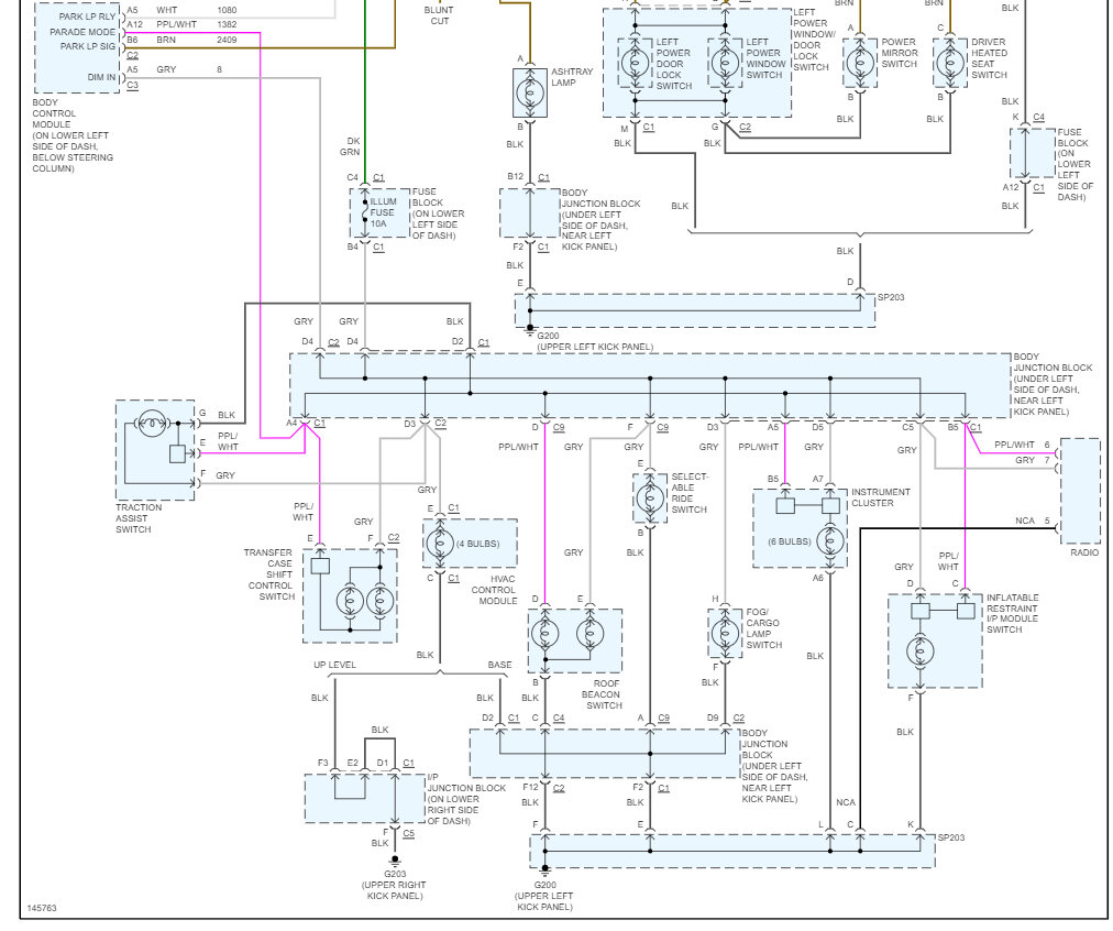

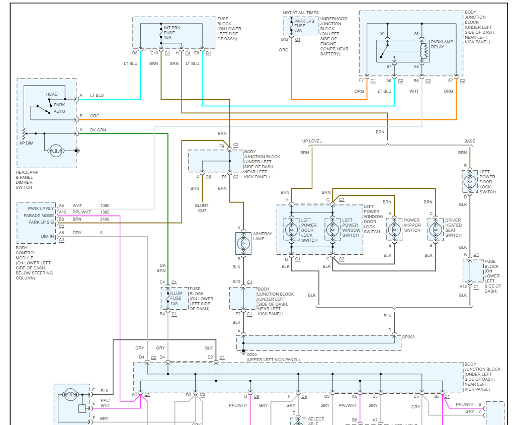

I would check the INT PARK and Illumination fuse in the fuse box on the left side of the dash for power here is a guide to help you and the instrument cluster illumination wiring diagrams so you can see how the system works.
This guide can help you check the fuse.

I've checked the fuses are all good.

Okay I would remove the cluster to see if you have ground to the black wire and power at the purple/white wire with the headlights on.
This video should help:
https://youtu.be/_HEC44xENxw
Please go over this guide and get back to us.
