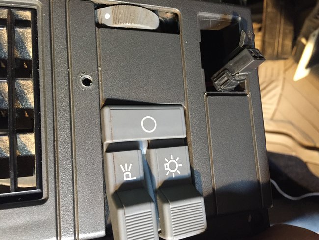

When I shut off the truck, everything turns off except the dash lights. The only way to make them go out is to take the fuse out. My dimmer switch (not for headlights, for dash lights intensity) does not adjust the light level. However, when fully on, the interior light will come on. How can I fix this?

A picture of what I am talking about. The roller switch on the right (or top).
Sunday, October 2nd, 2016 AT 3:16 PM
HMAC300
  • 48,601 POSTS
The headlight switch powers it so when you pull fuse out with truck off see if power is still going to fuse if it is it may be a bad headlight switch. Also check ground at right hand back of cab it may be broken wire.

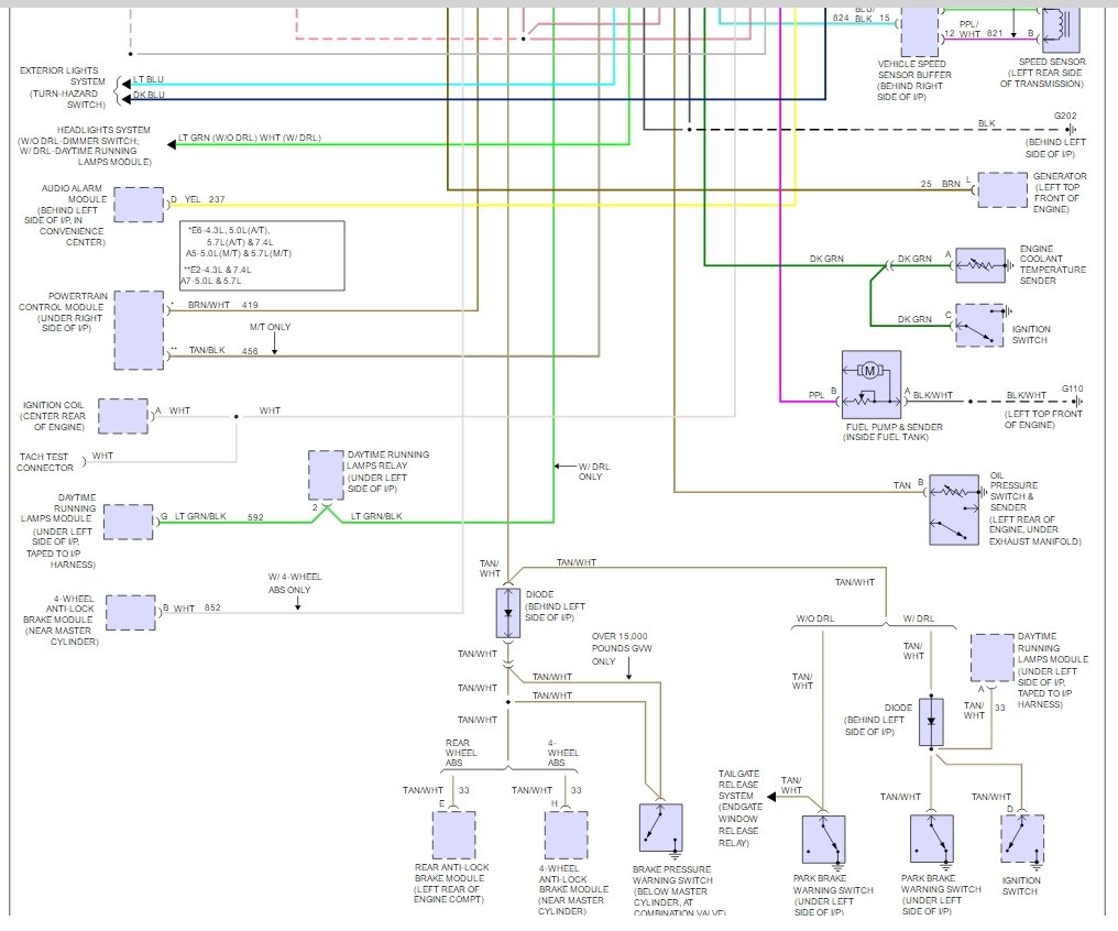

I found these wiring diagrams for you to help you and Hmac300 find the problem
Please let us know what you find so it will help others.
Best, Ken

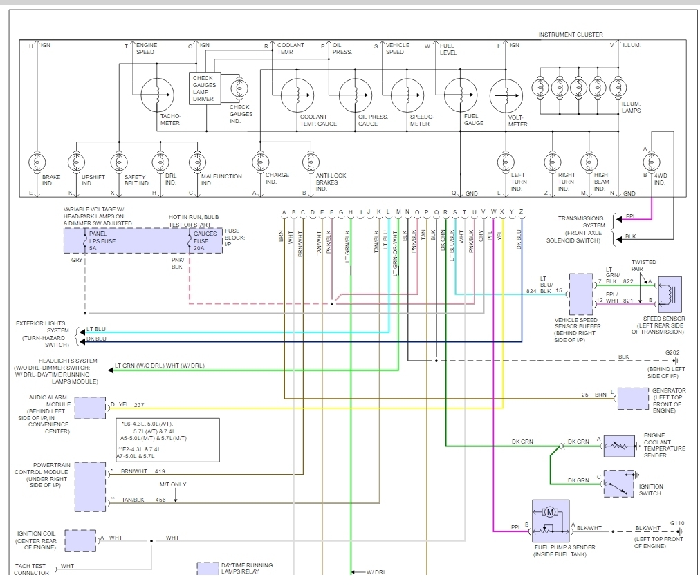

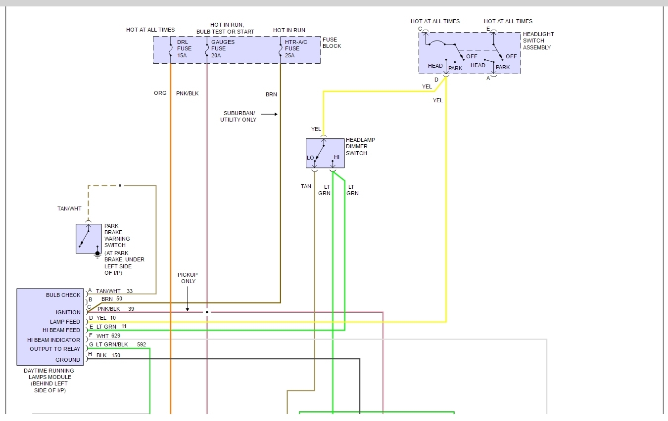

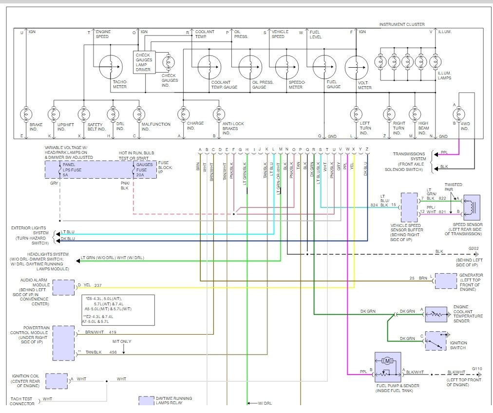

Yep sorry about not getting the diagrams up, here they are.
It looks like the DRL module could be causing the problem.
