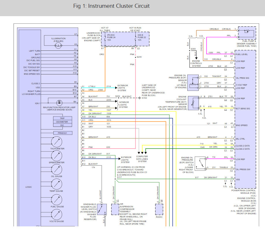

All dash gauges not working except tachometer
2005 CHEVROLET TRAILBLAZER
100,000 MILES • 6.0L • V8 • 4WD • AUTOMATIC
ROBERT ERWIN
  • 18 POSTS
Only the tachometer works all others are not working.
Oct 5, 2018 at 10:53 AM
  • 55,224 POSTS

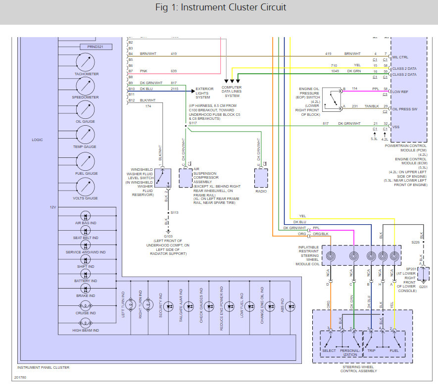

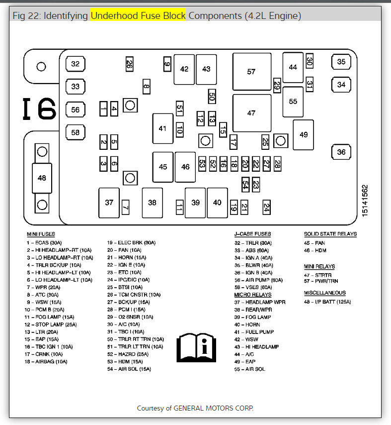

There are two fuses ( #24 IPC-DIC and IGN E) that need to be checked first. Here are the wiring diagrams so you can see how the system works and the fuse location along with a guide to help you test the fuse for power:
Oct 7, 2018 at 5:29 AM
ROBERT ERWIN
  • 18 POSTS
ken fig 22 you sent me is for a 4.2 is the 6.0 the same location
Oct 26, 2018 at 7:15 AM
  • 55,224 POSTS
Yes, should be. Let me know.
Oct 27, 2018 at 3:23 AM
DANIELAL
Ken,
Just want to thank you. At a local auto stereo shop the installer asked me to pull the fuse for the radio for 20 minutes to reset the disc player and when I plugged it in the car would not start or anything. The Envoy XUV windows, door locks or anything, the lights only worked and the gauges did not work.The key response was "Unknown User".
I found your thread about fuses #24 and IGN E and pulled them and checked them and they were good. I reinserted them and everything worked. Oh yes, the CD player works also.
