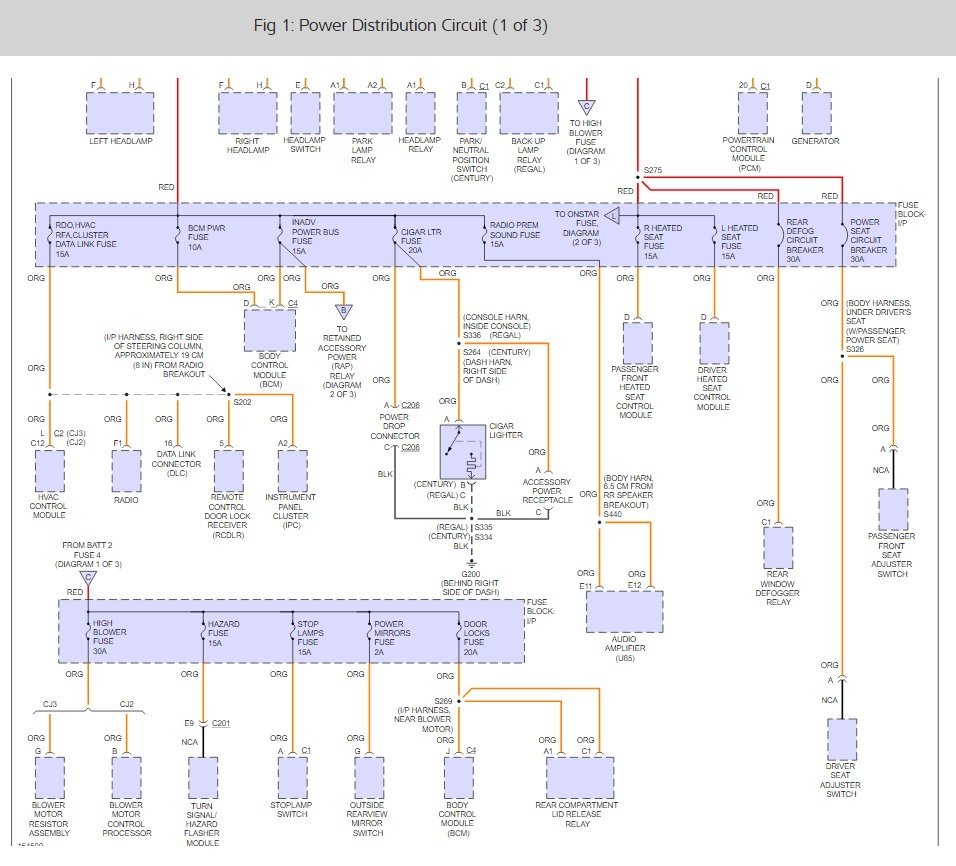

dash gauges are all out and no power windows and no blower for air and heater and its as something shot or blew but the two places that i checked the fuses are not blown. what else might i do to see if the problem can be fixed without going into the shop?
Aug 18, 2013 at 1:42 AM
JDL
  • 16,098 POSTS
Will the vehicle start and run? Did you check for voltage at the applicable fuses? Even if the fuse is good, if no voltage on the fuse circuit, the circuit is still dead. I haven't looked at your wiring yet, if those circuits you listed, get feed from the ignition switch, I'd have to check voltage to and from the ignition switch.
For a start, I'd pick one problem circuit and check voltage and ground. Fixing one circuit may or may not fix the others.

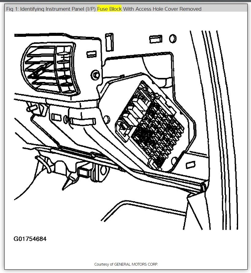

Check the power window circuit breaker for voltage, key on. That circuit breaker is in fuse box, under right side of dash. Use a testlite to check for voltage. Test the terminals with the key on. If no voltage, you'll have to check out the ignition switch.

Yes, it could be the ignition switch, if no ignition feed to circuits. I'd have to check circuits to and from ignition switch.

I can't be positive about the ignition switch. If all fuses and electrical circuits are ok, I'd replace the ignition switch.

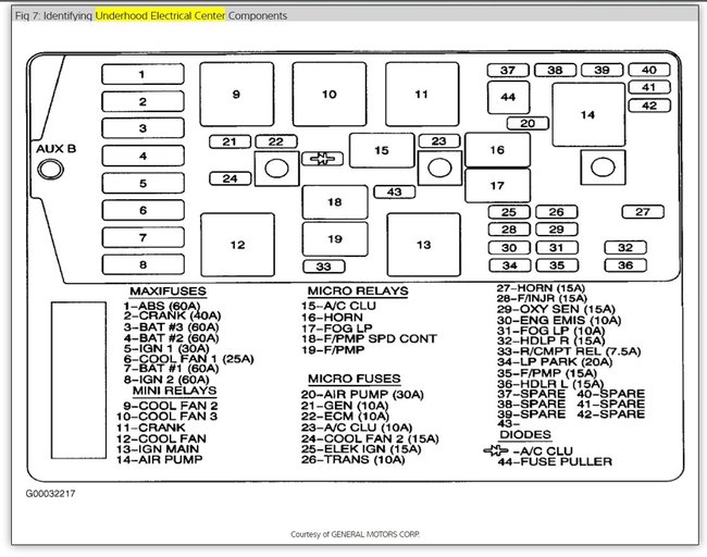

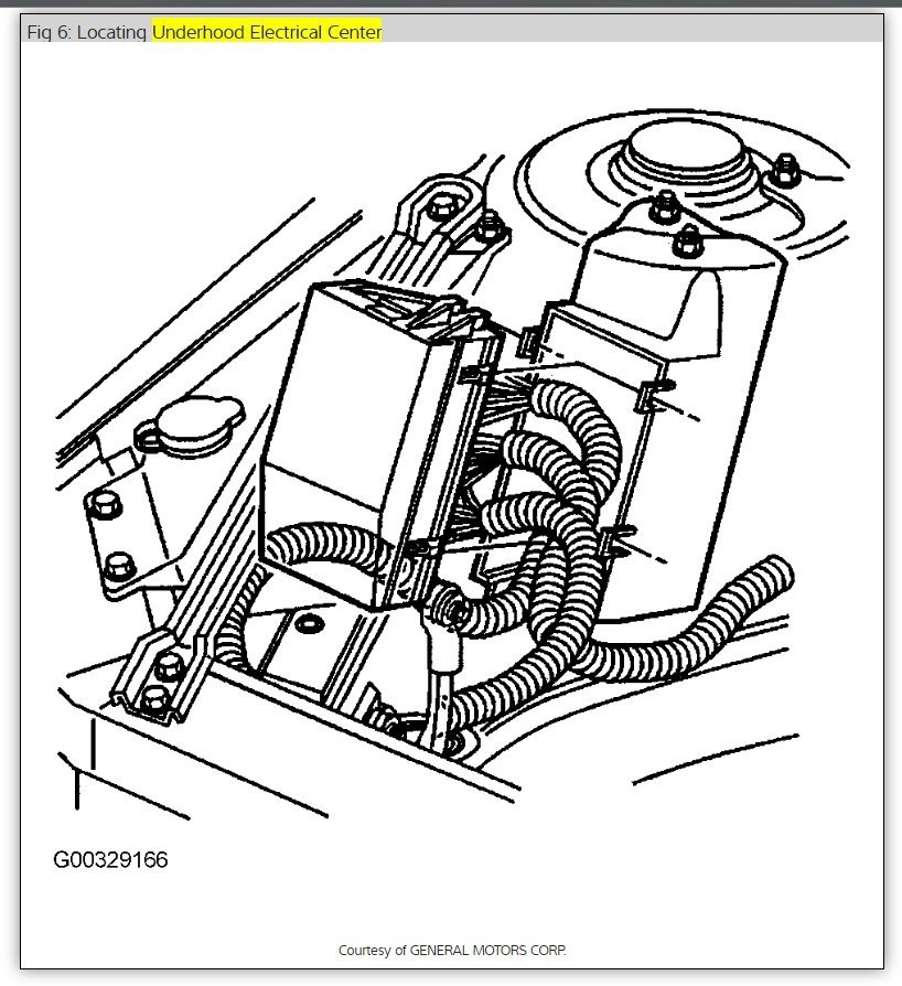

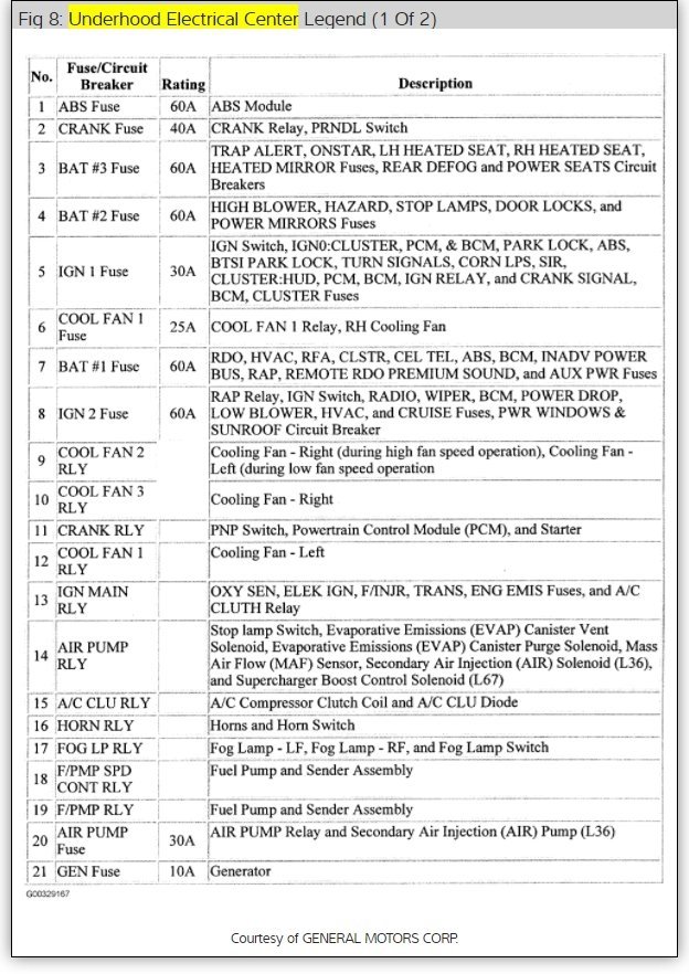

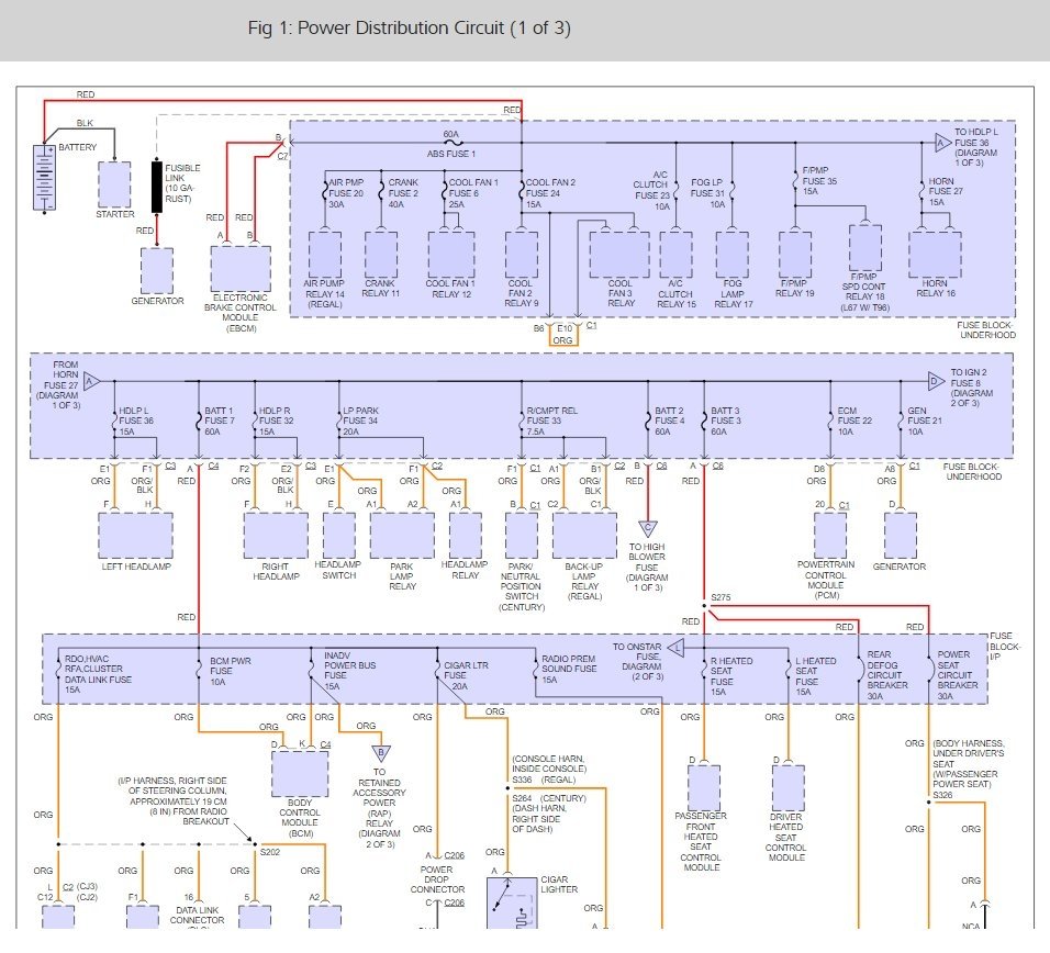

  • 55,432 POSTS
There is a 60 amp fuse 7 Batt1 that sounds like it is blown. Here is a a guide and some diagrams (below) that will help you get the problem fixed:
Please let us know what happens, we are interested to see what it is.

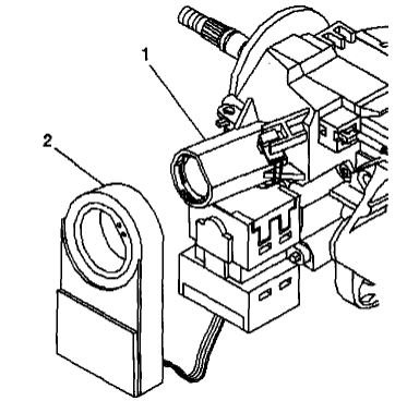

Yes, the ignition switch also provided power to many other systems in the car, however it's possible for only one section of the switch to have a problem and cause other issues. In this case I would highly suspect the ignition switch as they have been problems on many GM vehicles. The description of touchy key and key sticking also point to the ignition cylinder as the problem. The switch on those isn't hard to replace but if it has the antitheft system it can be tricky. You remove the steering column covers and the switch is screwed to the side of the column below the key cylinder. There are some wires you move out of the way and then you can change the switch. However if the key is loose in the cylinder you may want to have a locksmith make a replacement cylinder that can use the existing key and change it out as well.
