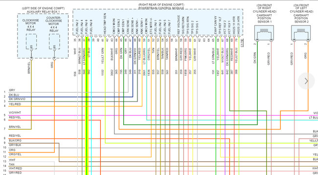

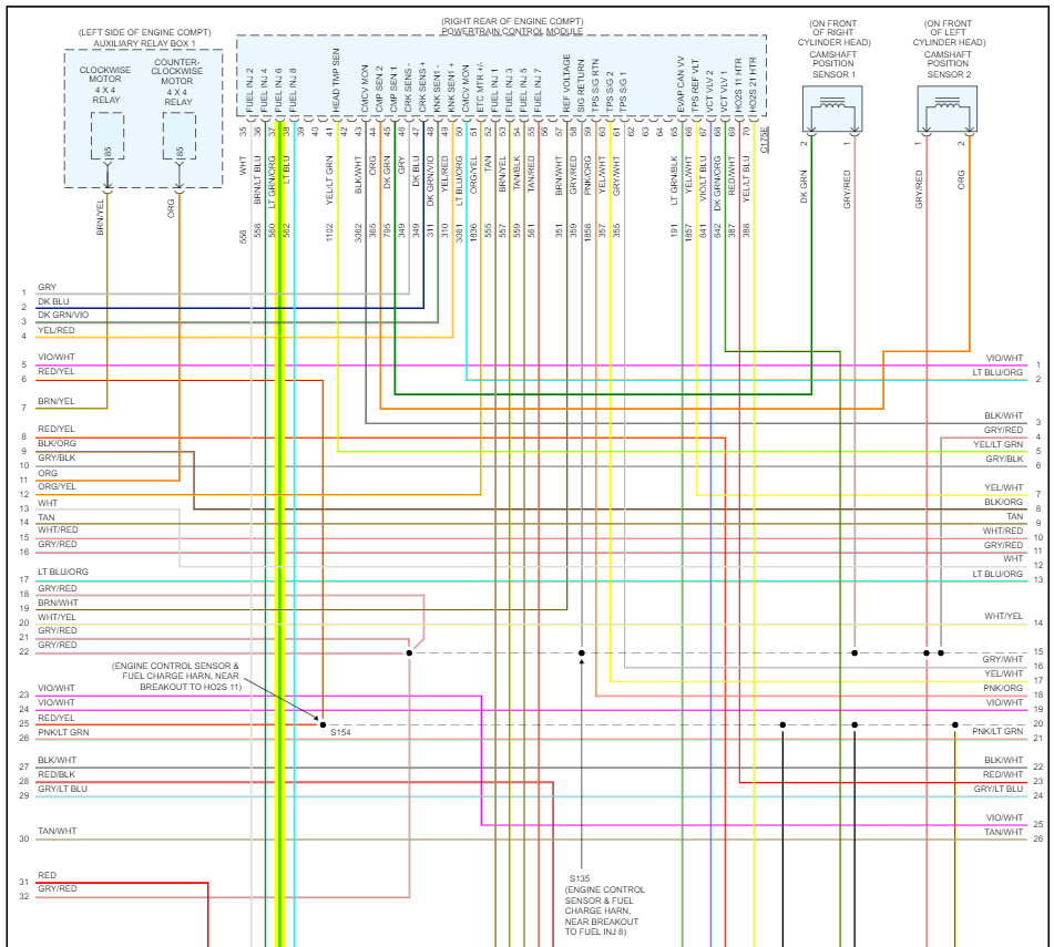

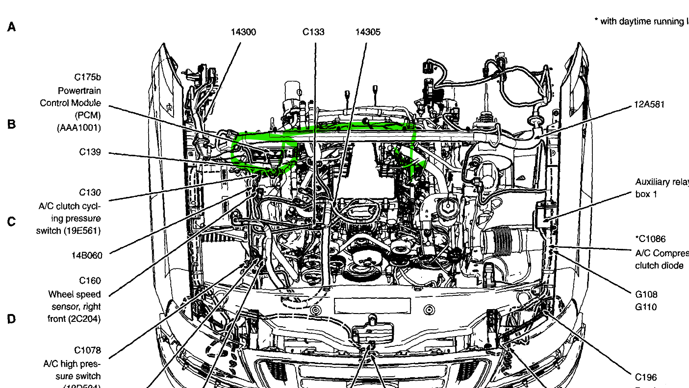

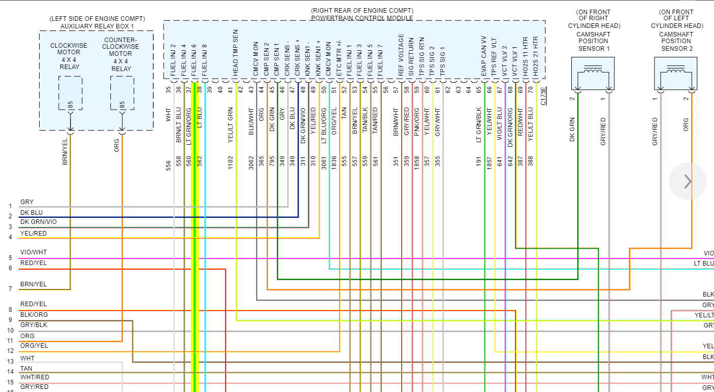

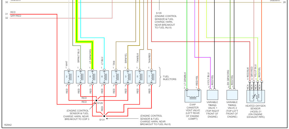

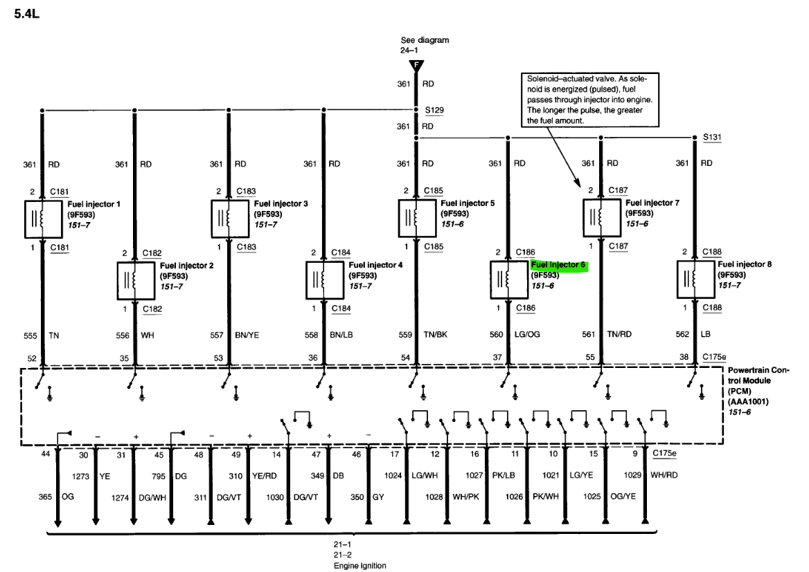

Hello, did you have the resistance checked of the old #6 fuel injector checked? If the old injector had shorted out it could have burned the ECM injector driver. If you check for the fuel injector pulse at the ECM connector and it's not there, it's probably a failed ECM driver. I'll put the wiring diagram below. If you have an Automotive LED test light, you can hook it to battery positive and check for the injector pulse that way. Because the ECM driver grounds the negative side of the fuel injector to control it. And using an LED test light will draw very low current so you don't have to worry about damaging any computer components.

If you have a injector control at the ECM and not at the injector harness plug, there must be a break in the wire in between the ECM and injector. Even on Ford ORM diagrams it looks like there aren't any connectors, it's a straight wire from the ECM to the injector. You may want to do a continuity check from the ECM to that injectors control wire with it unplugged and key Off. Just set your multimeter on Ohms, another thing that can cause a lack of injector pulse, and this depends on how you're testing the injector. If you're checking the injector for a pulse while it's plugged in and back probing the control wire, if there is no fuel pressure behind that one injector, for whatever reason, if something is stuck in the fuel rail and happen to end up in that particular injector output port. I've have heard of that happening before. But if you have the injector unplugged and there's still no pulse, it has to be a break in the wire.

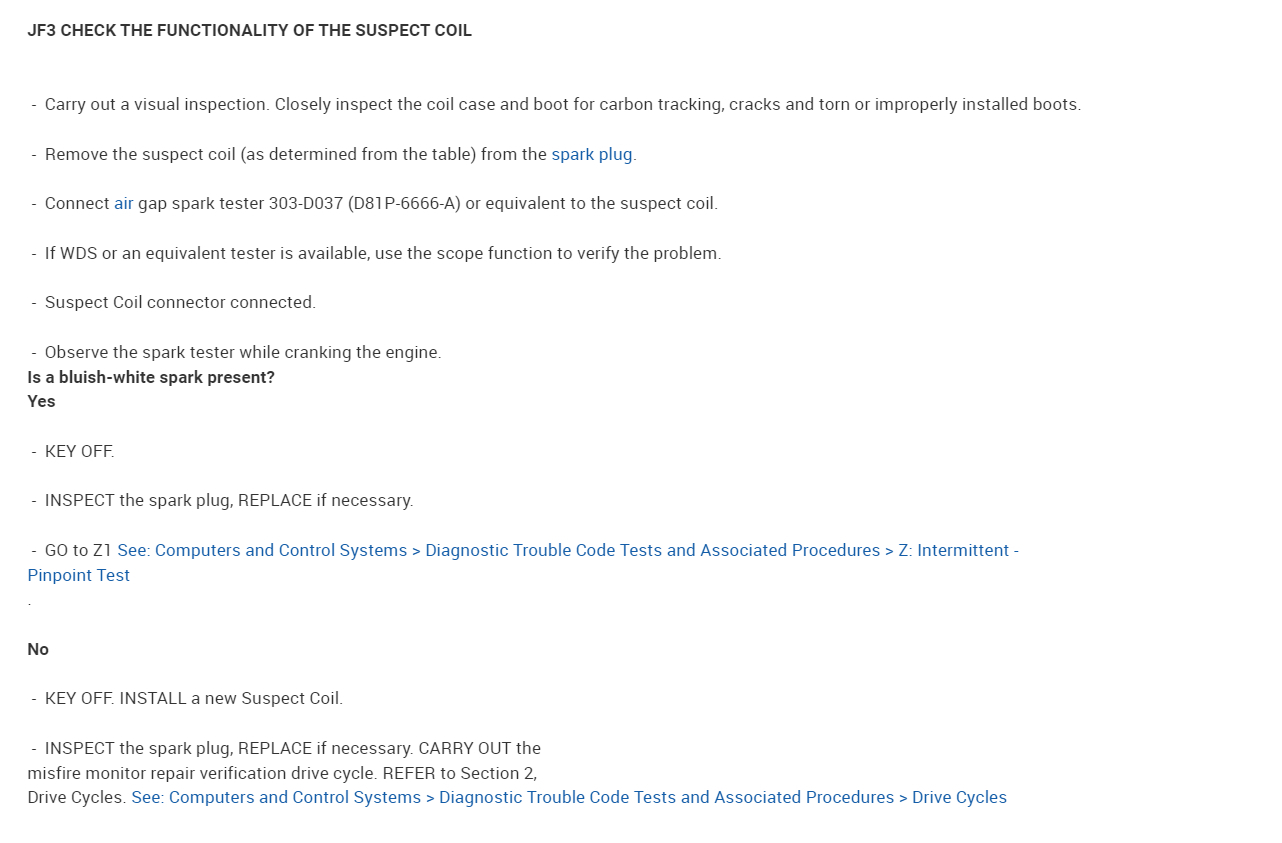

Okay, the P0356 is Ignition Coil F Primary/Secondary Circuit Malfunction. So, the Noid light pulses at the Fuel Injector harness plug? This code might be a failed Ignition Coil driver in the ECM. So, is it this code you're trying to get rid of? Is it not necessarily the fuel injector?

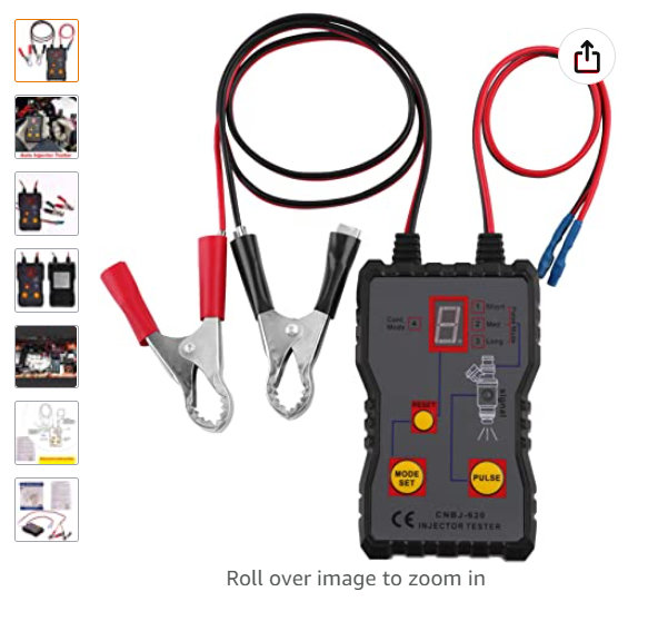

When I have a fuel injector issue, I do an injector balance test. Put a fuel pressure gauge on the rail. Ford has a small port on the end of the rail where you can screw on a pressure gauge. Then prime the fuel system by just turning the key to on position, engine off. Get the fuel pressure up to where its max reading is. It should hold fuel pressure. Then I use a Fuel Injector Pulse tool. It powers up by the battery and has two leads that hook on to the Fuel injector. Then it has three different settings, it will pulse the injector a certain number of milliseconds. I'll put a link below to the tool. When you pulse the injector with the tool, each injector should drop the same amount of fuel pressure. For example, if it's at the max pressure of 60 PSI, when you pulse the injector, it will drop in pressure to 42 PSI, as an example. Each injector should be within 1 to2 psi of that same reading.
This is a great tool for checking injector flow. You don't need the engine on, just turn the key on to prime the fuel system. If that injector doesn't pulse, and there's no fuel pressure drop, you'll know something is blocking it in the rail.

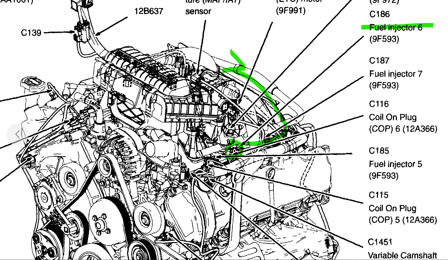

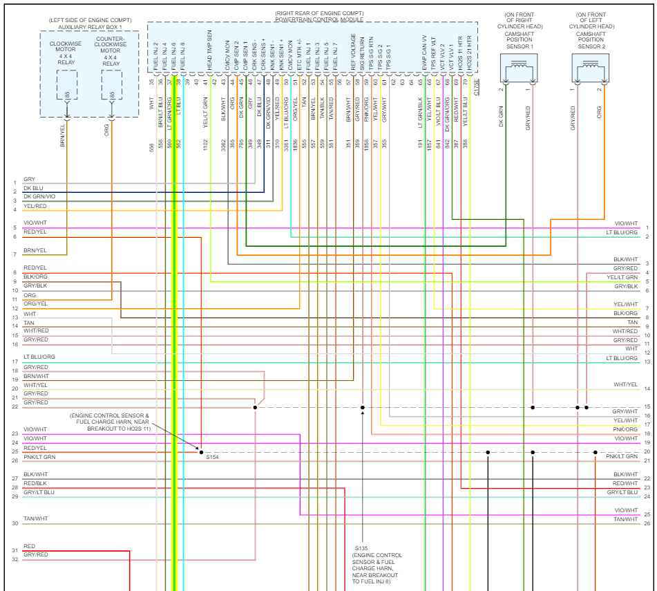

There has to be a break in the wire somewhere then. Do a continuity check from the ECM connector to the injector plug. Set your meter on Ohms and check from both ends. You should have very low resistance reading. Also check from the ECM connector to engine ground. There has to be a wire corroded somewhere or broken. They do get corroded on the inside and you will find the insulation on the wire appears fine. But the inside of the wire is completely deteriorated. All it takes is a pin hole in the insulation and it will rot away on the inside. I've seen that many times. You need to track down the problem from the ECM connector towards the injector. Keep your meter hooked up to the ECM pin that controls the injector and use the other meter lead to work your way towards the injector plug. It's the only way you're going to find it. Take apart each connector along the way and look for corrosion.

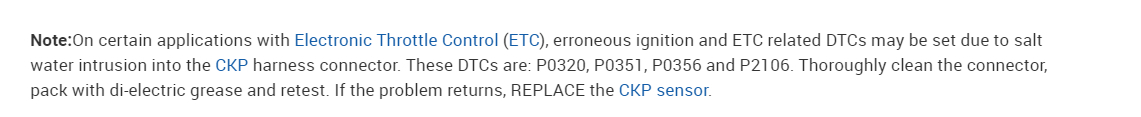

Also check the Crankshaft position sensor harness plug. Since the ECM is detecting some fault, check it, because it uses the crankshaft speed to detect misfires or faults.
I would also make sure you have spark to every other coil as well. Ford is not always the best at determining which cylinder is at fault. It may be a different cylinder not firing but it's setting a #6-cylinder fault. Make sure each coil has a strong spark, Stress the coil with a larger gap and see if a coil drops out or has weak spark. You might be chasing the wrong cylinder. My Ford has done that. Was setting misfire data in Mode 6 but it was actually a loose timing chain on the other bank of the engine.
