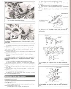

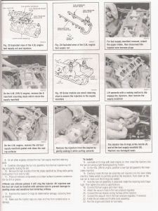

Hi,I am working on a 1995 ford f150 5.8 with 175000 miles.I want replace the fuel injectors.I believe they are 19 # injectors.Is there anyplace I can go a get a step by step procedure.I heard it can be done by someone with average mecanicle ability.Thanks
Apr 7, 2007 at 9:57 AM
MIKE H R
  • 3,094 POSTS
see if this helps.
https://images.2carpros.com/forum/automotive_pictures/54223_fuel_injector_1_chevy_1.jpg
https://images.2carpros.com/forum/automotive_pictures/54223_fuel_injectors_2_chevy_1.jpg
