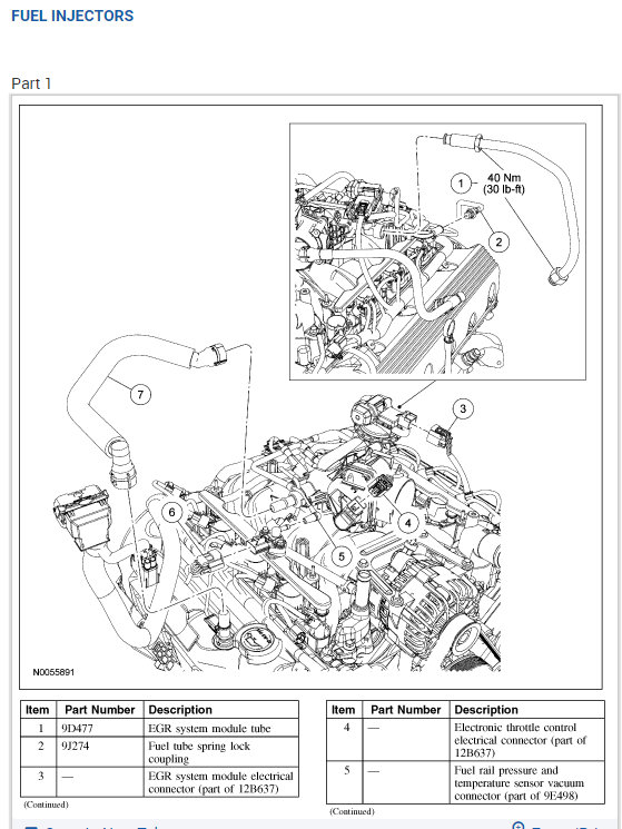

how to replace the fuel injectors?
Feb 10, 2016 at 11:48 PM
Experienced Mechanic
18,907 POSTS

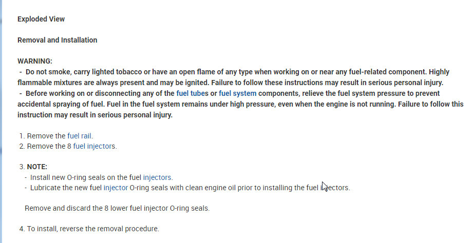

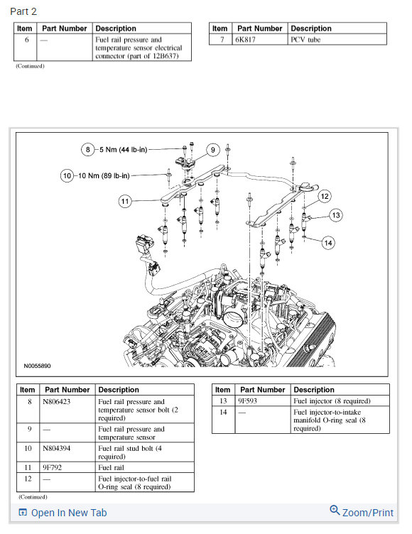

Here are a couple guides that will help with this. First is how to test the injectors. This will show the proper way to test the injectors in the event you need to do that, plus a guide on how to replace them.
https://www.2carpros.com/articles/how-to-test-a-fuel-injector
https://www.2carpros.com/articles/how-to-replace-a-fuel-injector
Below you will find the process on how to replace the injectors from the manual. Let us know if you have questions. Thanks
