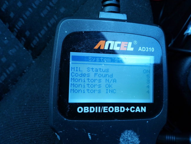

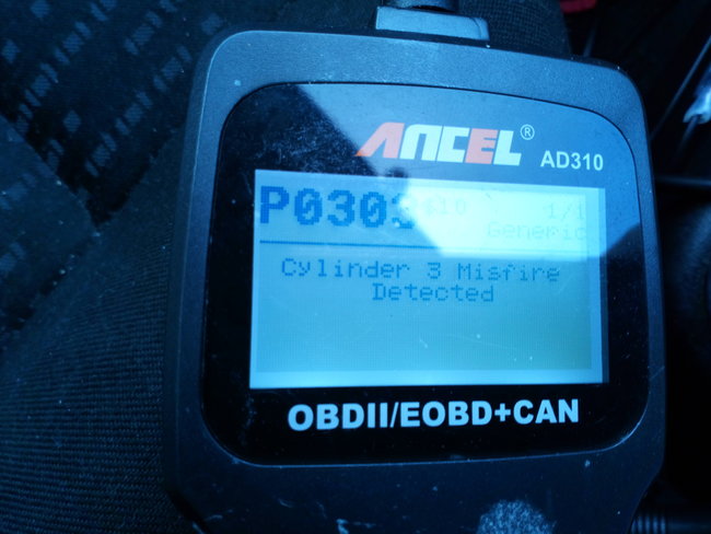

Hello, I have a misfire on cylinder three, the spark plugs have been changed coils checked
Carried out compression test, cylinders 1, 2,and 4 are 15 bar.
Cylinder three, 9 bar.
This fault running on three cylinders is intermittent. The other thing I have noticed is when it runs right the engine light stays on constant.
When the fault occurs the engine light flashes.
Any advice would be greatly appreciated
Regards,
Mark

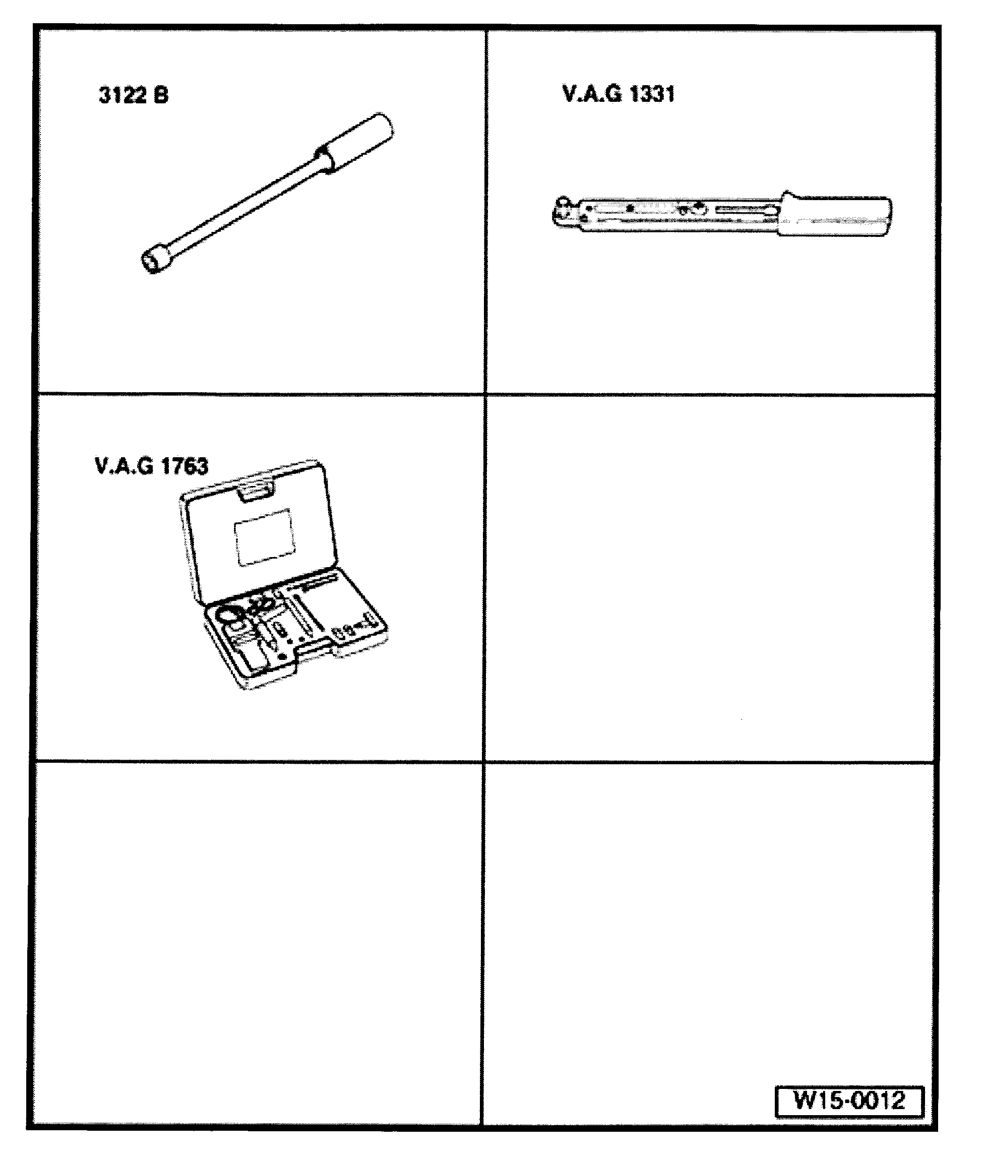

Special tools, workshop equipment, test and measuring appliances and aux. items required
^ 3122 B Spark plug spanner
^ V.A.G 1331 Torque wrench (5 to 50 Nm)
^ V.A.G 1763 Compression tester

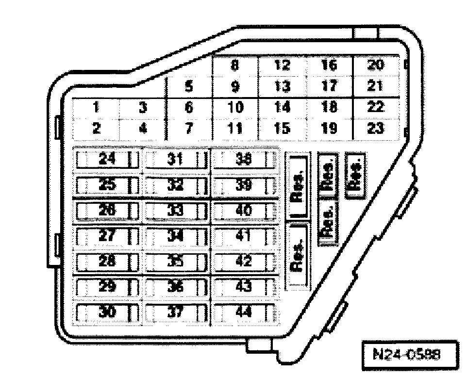

- Remove fuse 32
Note: Removing fuse 32 interrupts the voltage supply to the injectors.

Hello, I have carried out another compression test and these are the results:
Cylinders 1, 2,and 4 around 15 bar
Cylinder 3 with tablespoon of oil in cylinder was around 11 bar.
Also, the engine light, when the car is running right it stays constant.
When engine is running on 3 cylinders the engine light flashes.
There is also a pooing noise from the rear of the exhaust.
Your advice will be greatly appreciated.
Regards,
Mark
Oct 17, 2018 at 10:07 PM

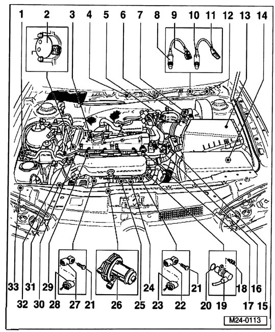

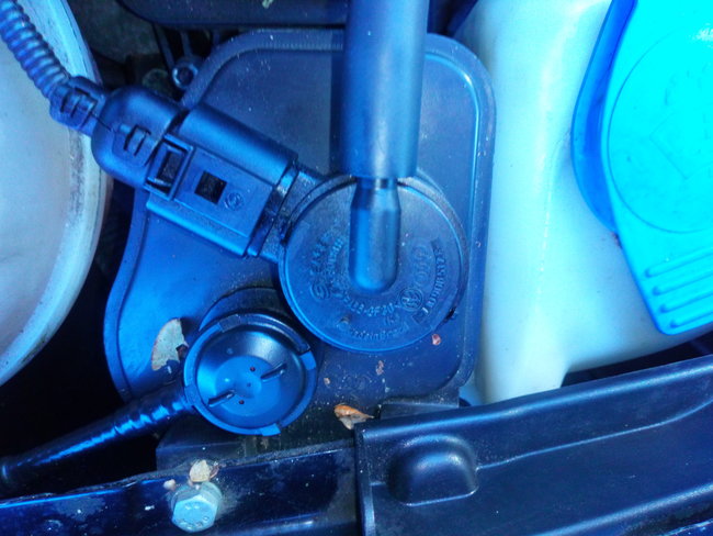

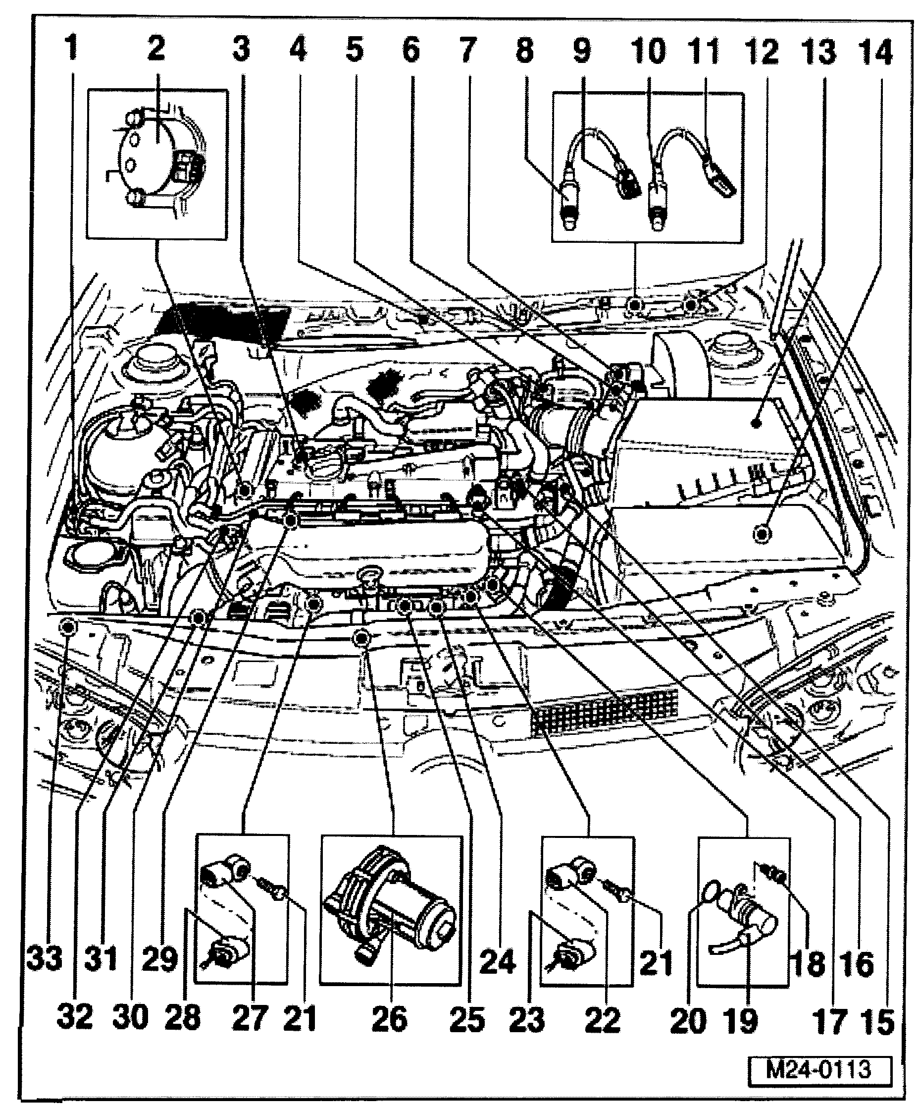

Hello, I have attached the photo of the device! Could you tell me what it does, and what it is please, it intermittently clicks.
Regards,
Mark
Oct 20, 2018 at 2:16 AM
  • 110,248 POSTS
If that is located on the right side of the engine compartment, it is the EVAP canister purge valve. See attached picture of components to identify location.

Hello, thanks for getting back to me, yes looking at the image, as you look at the engine it is on the left, it looks like number 1 on the diagram, what does it do and as I said it clicks intermittently.

The purge valve controls the amount of fuel vapor that is purged from the charcoal canister. It is part of the evaporation emissions system. The one on your vehicle is electronically controlled, so that is why you are hearing a clicking. It is controlled by the car's computer.

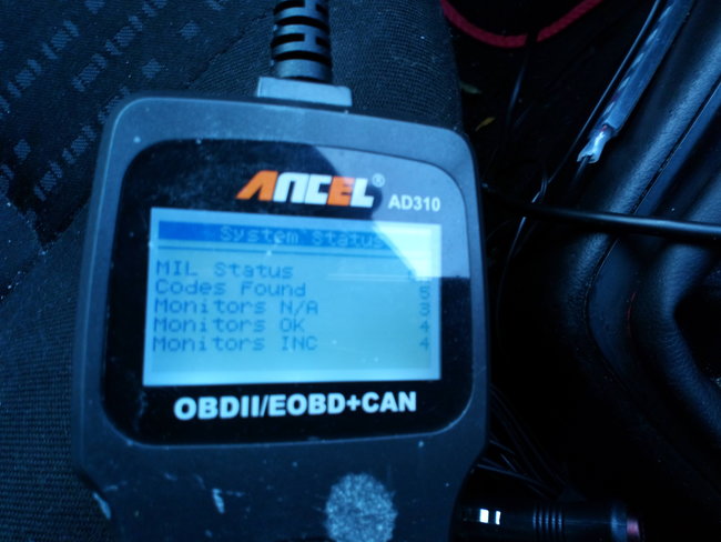

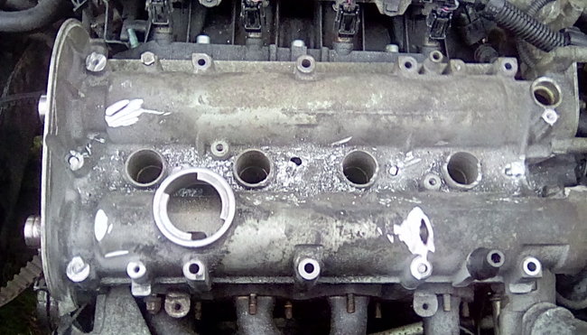

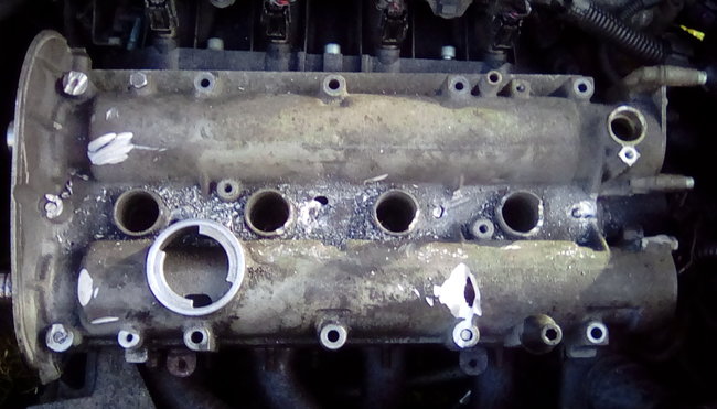

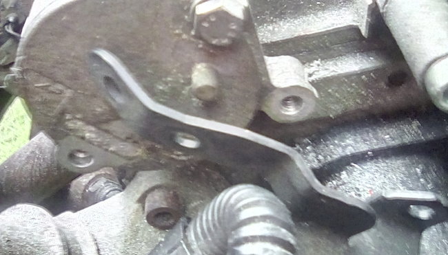

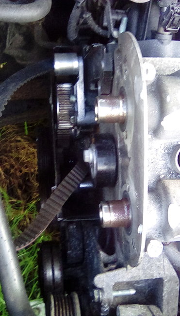

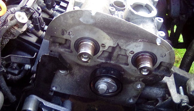

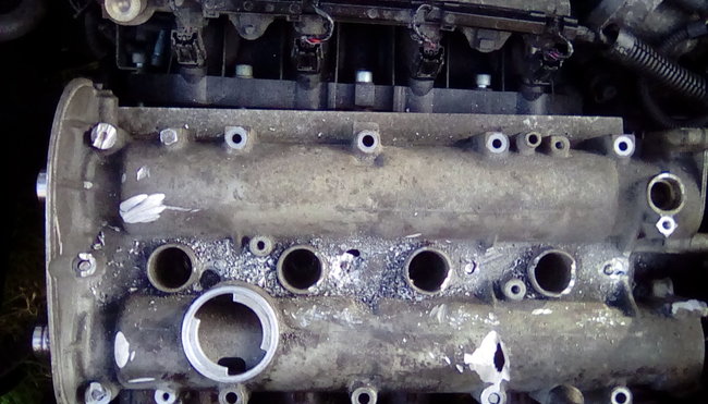

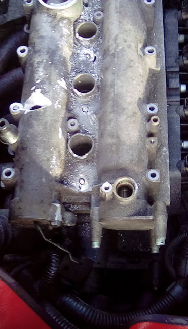

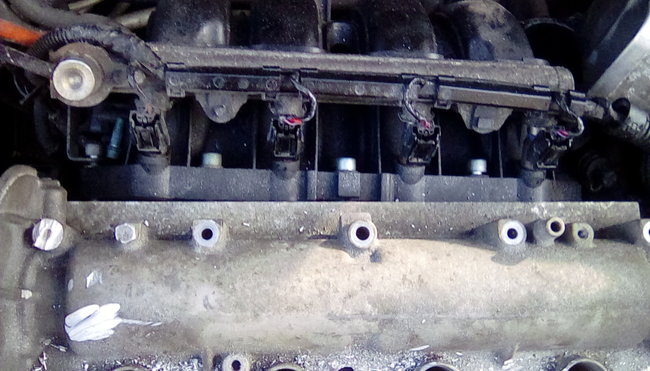

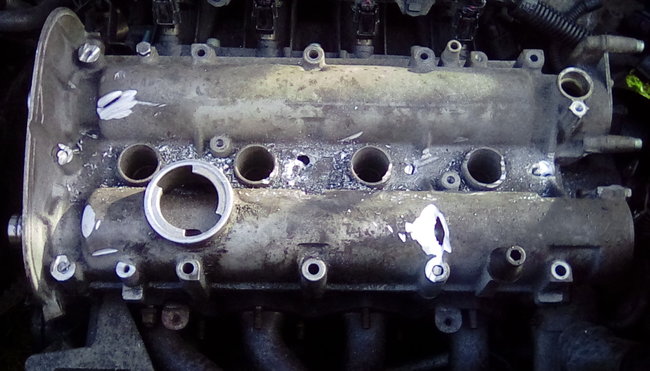

Hello, just an update on my misfiring vw golf, I carried out the tests that you surgested and gave you the results, I am Realy at a loss to why this intermitantly fault is occurring, as I am to the misfiring cylinder is also lower on commpresion, I am at the stage now to remove the head (something I Realy don't want to do unless it's nessasary) any advice or further thoughts to what is causing this fault would be greatly appreciated, it Realy is an annoying fault, electronics in cars these days are great when there working, I miss the old days when with traditional mechanics you could fix your car
Regaurds
Mark
Oct 28, 2018 at 8:55 AM
  • 110,248 POSTS
Hi Mark:
I wish I had a better answer, but you have done all the basic checks to remedy the issue. The only thing I can think is that the variation in compression is causing it.
I wish I had an easier answer.

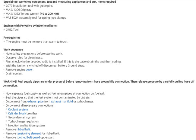

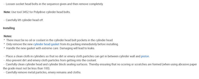

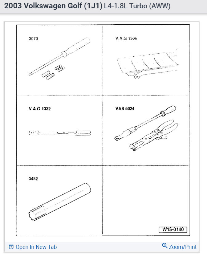

I don't know if you need them, but here are the directions for removing and replacing the cylinder head. All attached pictures correlate with these directions.
___________________________________________

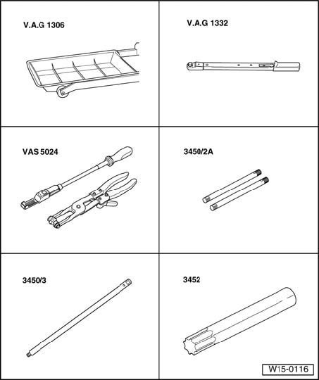

Cylinder head, removing and installing
Note:
^ When installing an exchange cylinder head with camshaft, lubricate running contact surfaces between hydraulic lifters and camshaft cam surfaces before installing cylinder head cover.
^ The plastic packing pieces for protecting the open valves must not be removed until immediately before installing the cylinder head.
^ If the cylinder head is replaced, all the coolant in the system must also be replaced.
Engine codes AEG, AVH, AZG, BEV
Special tools and equipment
^ V.A.G 1306 Drip tray
^ V.A.G 1332 Torque wrench (40 to 200 Nm)
^ VAS 5024 Assembly tool for spring-type clips
^ 3450/2A Guide pins
^ 3450/3 Removal tool
^ 3452 Key (for Polydrive cylinder head bolts)
^ T10020 Two hole pin wrench
^ T10112 Fitting tool

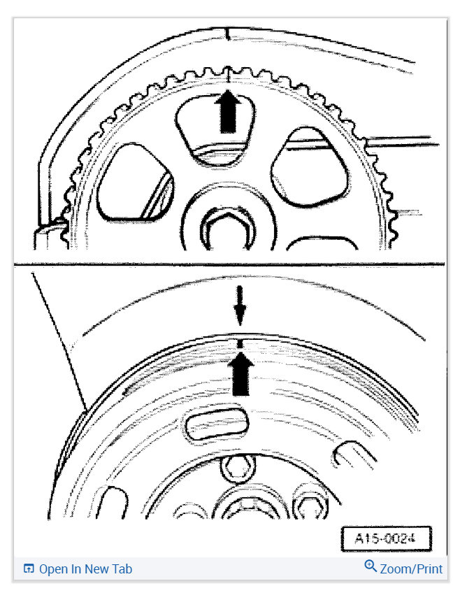

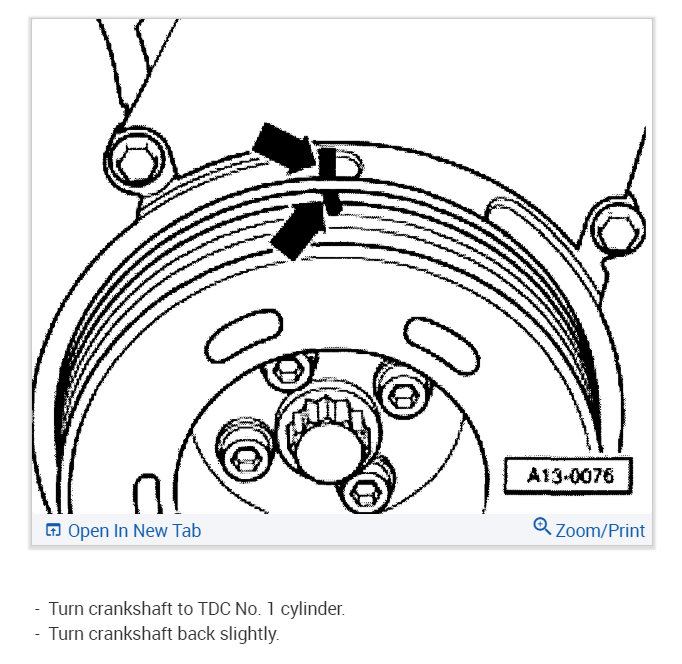

- Set camshaft pulley to TDC No. 1 cylinder by turning crankshaft 1. Mark on camshaft pulley must align with (arrow) on toothed belt guard.
- Loosen tensioning roller and remove toothed belt from camshaft pulley.
- Turn crankshaft back slightly.

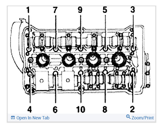

- Loosen socket head bolts in sequence given and then remove.
Note: Use key 3452 for polydrive cylinder head bolts.
- Carefully lift cylinder head off.
Note:
^ Always replace bolts.
^ There must be no oil or coolant in the cylinder head bolt pockets in the cylinder head.
^ Do not remove new cylinder head gasket from its packing until immediately before installing.
^ Handle new gasket with extreme care. Damage will cause leakage.
^ Place cleans cloths in cylinders so that no dirt or emery cloth particles can get in between cylinder wall and piston.
^ Also prevent dirt and emery cloth particles from getting into coolant.
^ Carefully clean sealing surfaces of cylinder head and cylinder block. Ensure thereby that surfaces are not scored or scratched (if abrasive paper is used, grade must not be less than 100)

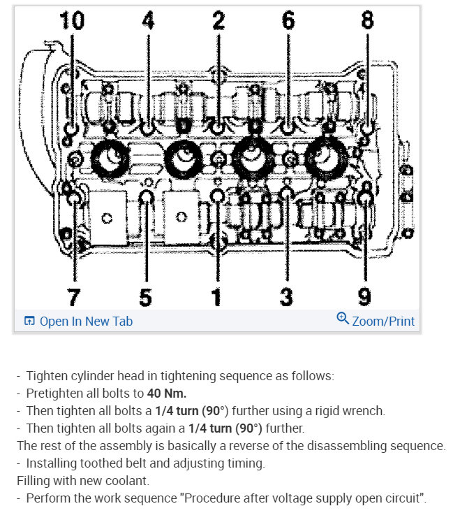

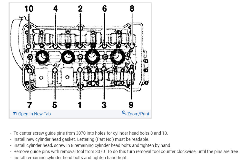

- Tighten cylinder head in tightening sequence as follow:
- Pretighten all bolts to 40 Nm.
- Then tighten all bolts 1/4 turn (90°) using a rigid wrench.
- Then tighten all bolts again another 1/4 turn (90°).
Further assembly is the reverse of the disassembling procedure.

Engine code BBW
^ VAS 5024 Spring-type clip pliers
^ 3450/3 Puller
^ 3452 Key (for polydrive cylinder head bolts)
Removing
CAUTION! When performing repair work, especially due to the confined conditions in the engine compartment, pay attention to the following:
^ Route all types of lines (e.g. for fuel, hydraulics, EVAP system, coolant, refrigerant, brake fluid and vacuum) as well as electrical wiring so that the original positions are restored.
^ Ensure sufficient clearance to all moving or hot components.
Note: During this procedure the battery Ground strap must be disconnected. Therefore, please check whether a coded radio is installed. Obtain the radio code first if necessary.
- With ignition switched off disconnect battery Ground (GND) strap.

- Turn crankshaft until camshaft is positioned at TDC No. 1 cylinder.
It should be possible to move setting bar 2065 A in camshaft groove.
- Remove tool.

- To centralize, screw guide pins from 3450/2 A into front outer threaded holes for cylinder head bolts.
- Install new cylinder head gasket.
- Install cylinder head, screw in 8 remaining cylinder head bolts and tighten by hand.
- Remove guide pins through bolt holes with removal from 3450/3. To do this turn removal tool counter-clockwise, until pins are free.
- Install remaining cylinder head bolts and tighten hand-tight.
- Then tighten all bolts 1/4 turn (90°) using a wrench.
Further assembly is reverse of the disassembling procedure.

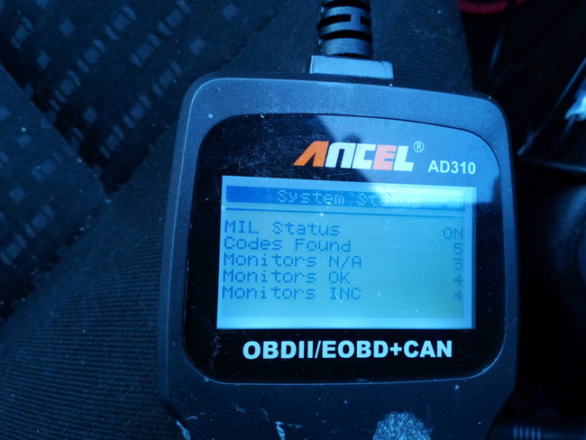

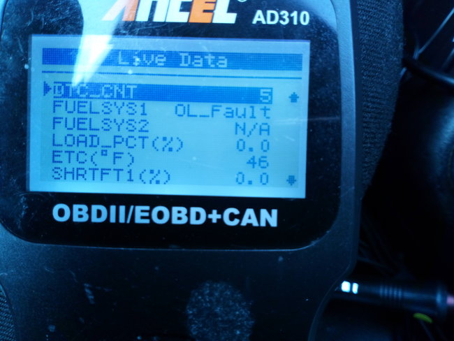

Hello Joe, just thought I would plug my OBD in and I have uploaded the pictures for you, have got more, will keep you posted as now I have carried out that test I will now get on with the cylinder head.
Regaurds
Mark
Nov 25, 2018 at 1:50 AM
  • 110,248 POSTS
I see there are five codes set. What are the other four? I only see the misfire.
Thanks,
Nov 25, 2018 at 9:02 AM
MARKRACER
  • 19 POSTS
Hello Joe, I will write them.
DTC_CNT. 5
FUEL SYSTEM. OL_FAULT
LOAD_PCT (%) 0,0
ETC F%. 46
SHRTFT1 0.0
LONGFT1 0.0
MAP (IRHG). 28.9
IAT (F%). 41
MIL STATAS ON
CODES FOUND. 5
MONITORS. N/A 3
MONITORS OK 4
MONITORS INC 4
EQ_RAT11 0.999
02S11 (CMA). 0.000
TPC (%) 7.5
02S B1S12___B25
02B152 (V). 0.060
Can you make sense of these Joe?
Regards,
Mark
Nov 25, 2018 at 10:22 AM
  • 110,248 POSTS
Hi Mark:
Honestly, that is the live data information. If you select the codes found, it should then list one at a time.
Nov 25, 2018 at 2:29 PM

Hello ken, I've just started to disassemble my engine to remove the cylinder head. I've got to the point of removing the camshaft carrier, however, I've taken everything off, removed the Alan bolts but the carrier will not lift off, I can't see anything that's holding it on, any ideas?
Regards
Mark
Feb 9, 2019 at 10:35 AM
  • 55,746 POSTS
Can you take some pictures or video and upload it so I can see whats going on?
Feb 9, 2019 at 10:36 AM

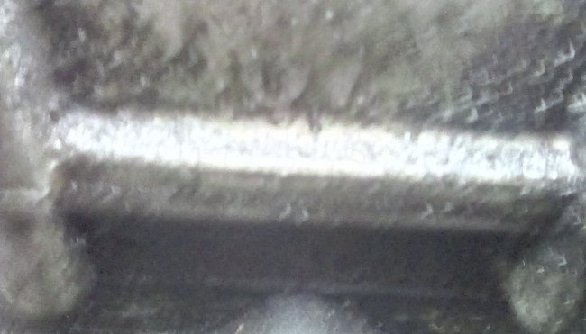

MARKGOLF
Hello Ken, attached are photos as requested. I have ruined the camshaft carrier trying to get some corroded Allan bolts. anyway as hopefully you can see that I have disconnected and income everything, but the carrier still won't budge. I hope you can help.
Regards,
Mark
Feb 10, 2019 at 2:00 AM
  • 55,746 POSTS
Wow, you do have some broken bolts there. It looks like you got them all, but how about at the rear of the engine can you upload pictures of that?

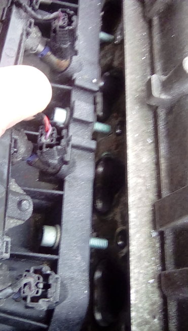

Feb 10, 2019 at 3:04 AM
MARKGOLF
Hello Ken, attached are more photos. I have removed everything including manifolds, so can't see why the carrier won't come off.
Regards,
Mark
Feb 10, 2019 at 11:00 PM
  • 55,746 POSTS
Yep it looks like it should come off is lose at all or stuck? Have you tried a pry bar?
