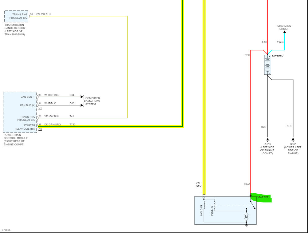

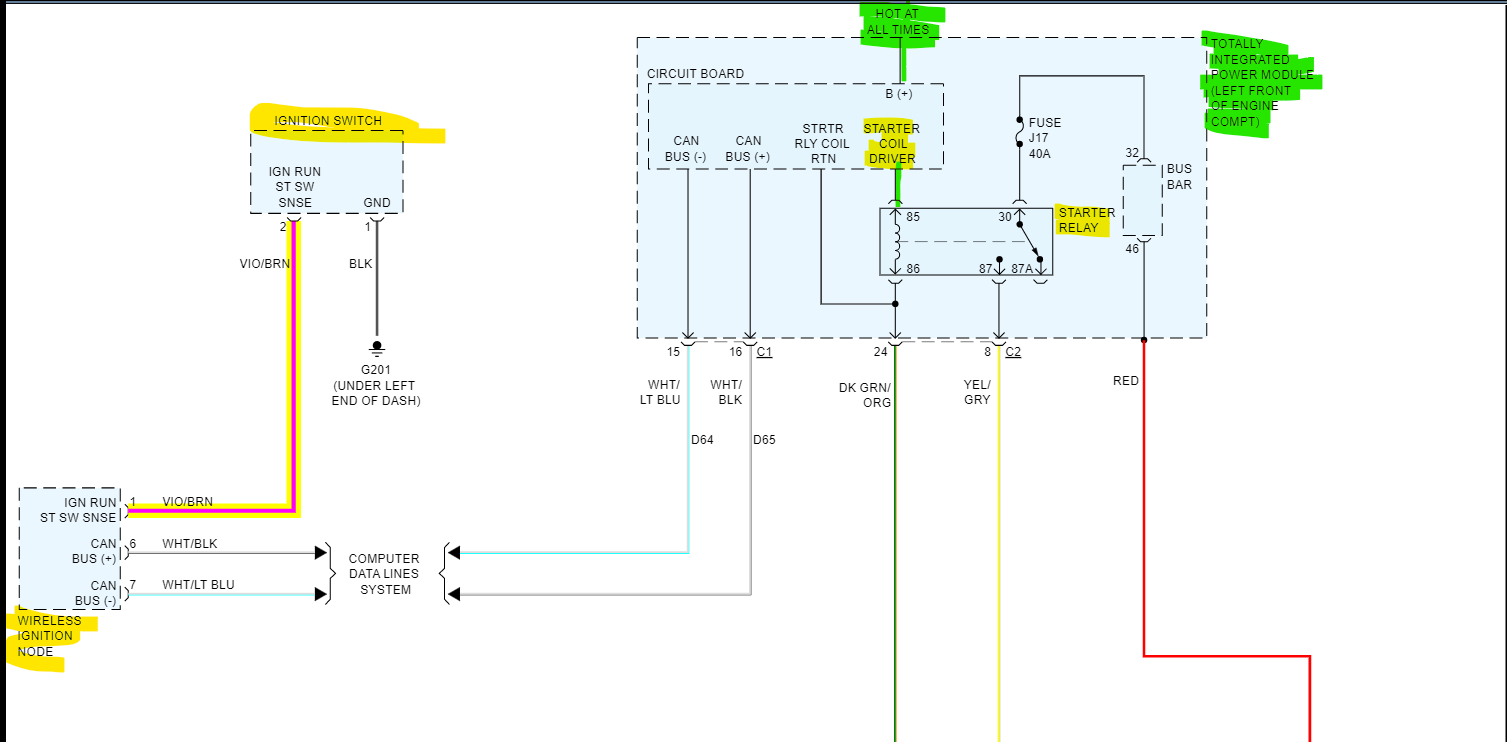

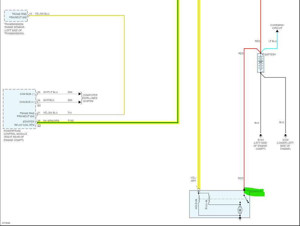

Yeah, the starting system in this vehicle has a separate wireless Ignition node or module. The Ignition switch sends a voltage signal to this module and the module communicates with the Totally Integrated Power Module (TIPM) by means of the CAN bus network. The TIPM contains the Starter Relay. I will put the wiring diagrams below so you can see how it works. But these TIP Modules have issues with corrosion from underneath. And since they have communications built into them, they cause a lot of problems.
It's not really an easy system to diagnose. We would look at the communications on an oscilloscope and check voltage signals. I can't say exactly what has failed on your vehicle.
There is a circuit board in the TIPM that controls the Starter Relay as you'll see on the wiring diagrams, there is a fuse you can check in the engine compartment on the passenger side (Fuse J17, 40Amp).
This is one of those situations where you would have to take out the Starter Relay and check the Pins that it plugs into for battery power and Ground.
If you look in the 1st diagram, to the left is the Ignition Switch and you'll see it sends a signal to the Wireless Ignition Node, that in-turn sends a signal by way of the CAN bus network to the TIPM to energize the Starter Relay. Thats what you would need to check while someone else is trying to start the engine for you.
There's a few guides below to help you if your comfortable doing this type of work. It can get somewhat complicated though if there's a problem with the Communications Network.
But I think this is a result of the bad advice that the mechanic gave you unfortunately.
If the Security System loses its memory due to the battery being unhooked so many times, it may need to be reprogrammed.
