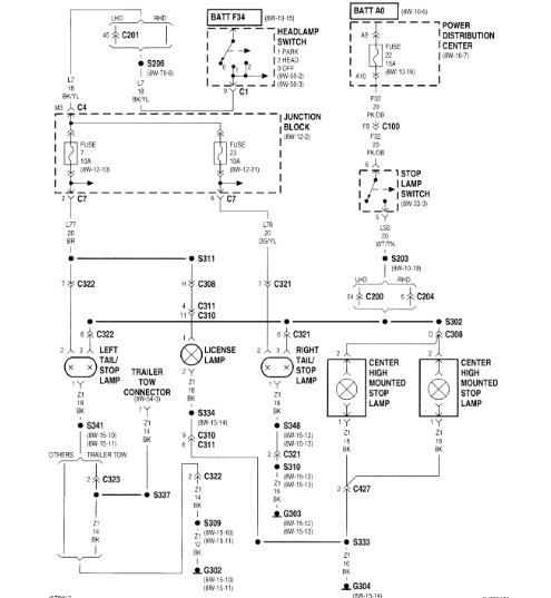

Going back over sold checks, if you have power on both sides of the fuse, the next stop for voltage is the lights. This enforces all our replies about a broken wire between the fuse block and the light. the fuse is after the switch. the fuse only gets power when the switch is in the headlight position. attached is a diagram.

You're on the wrong diagram. Look at the "Exterior Lights" diagram, then you'll see a different part of the head light switch that is fed from fuse 17, then on the tan / black wire to the switch. I was confused by this diagram too.
