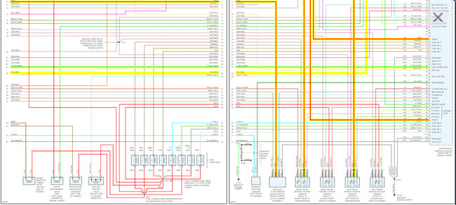

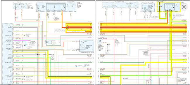

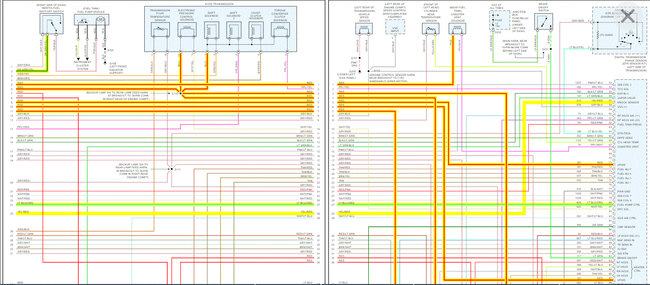

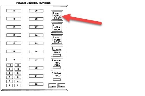

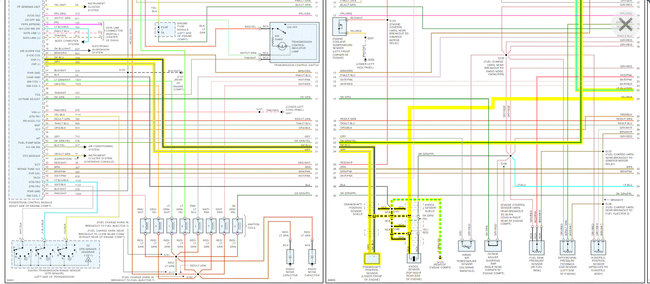

Pop the hood and on the driver side, open the fuse box cover and give this relay a tap. If it starts or stalls when you tap it, try swapping it with it's neighbor. Very very very common!
Jul 27, 2020 at 7:30 AM
As he said, that is the power relay that controls all power to the fuel pump relay and a lot of other components that I highlighted in the diagrams I sent you.
Jul 27, 2020 at 8:12 AM

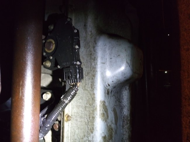

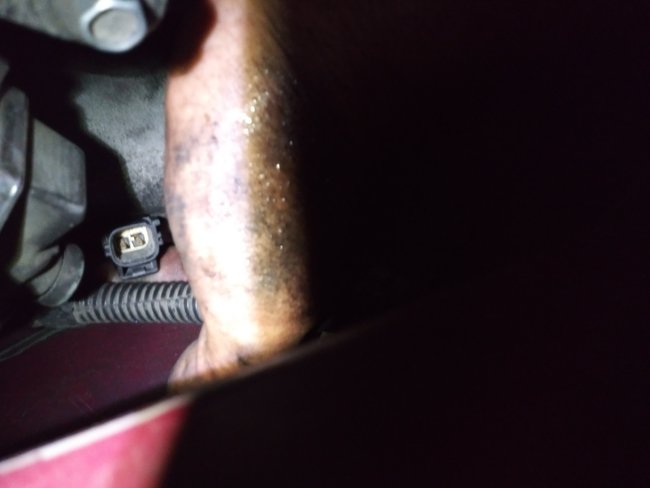

It's not the catalytic converters. I got some off another truck and swap them out and still the same problem. I found a plug towards the back of the motor on top that is not plugged into anything not sure what it's for. I was wondering if maybe you knew.
Jul 29, 2020 at 12:56 AM
Can you post a picture for me of the plug?
Also, did you check the compression in a cylinder or 2 to see if the valve timing jumped?
I would not rule out the exhaust. I would drop the front pipes and start it and drive to be sure the rest of the system is not restricted.
Jul 29, 2020 at 1:58 AM

There is that pic of the plug that's not connected.
Jul 30, 2020 at 12:58 AM
JAMESBURROW
  • 46 POSTS
Sorry wrong pic. but I was wondering what that was it's on my transmission and it has oil all over the plug wire I was wondering if maybe that caused it to go out.
Jul 30, 2020 at 12:59 AM
JAMESBURROW
  • 46 POSTS
Here's the pic of the plug:
Jul 30, 2020 at 1:00 AM
JAMESBURROW
  • 46 POSTS
And no I haven't done any compression test yet. I'm going to do it when I get home from work.
Jul 30, 2020 at 1:01 AM
Where is that connector located and what colors are the wires?
Jul 30, 2020 at 1:04 AM
JAMESBURROW
  • 46 POSTS
I figured out where the plug went; it's one of my knock sensors. I changed the idle control valve and now my truck runs a lot better, it's still missing in cylinder 3 and when i take off i can feel it kind of jerking a little. like something is working and then not working, but if i hold the gas pedal in a certain spot then it is okay.
Jul 30, 2020 at 11:29 PM
