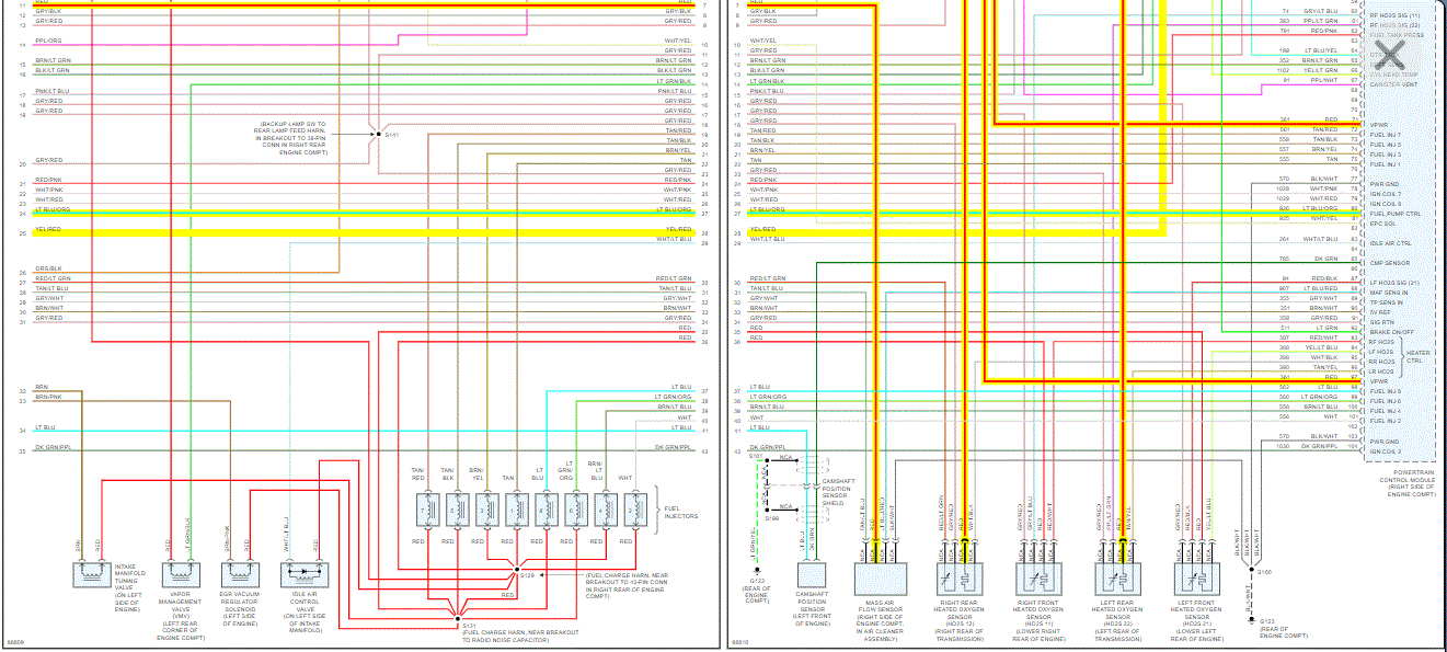

Okay, we need to do some testing. Do you have a voltmeter and a test light?
We need to check some powers at the power relay and the fuel pump relay.

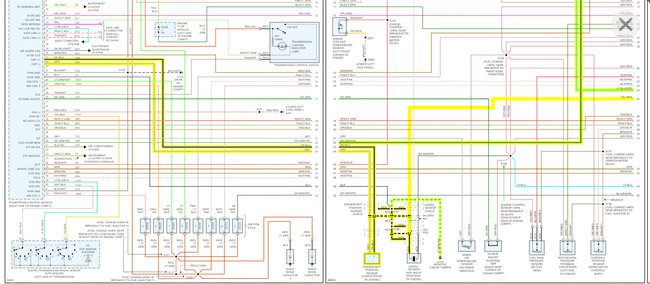

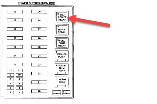

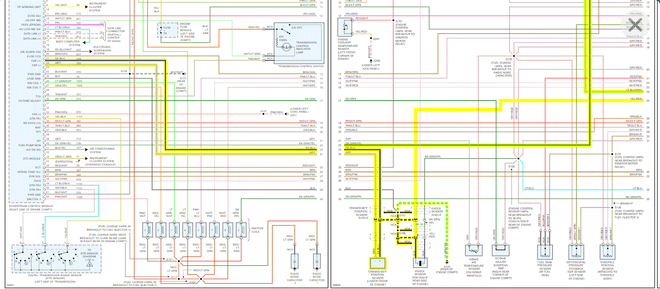

Pop the hood and on the driver side, open the fuse box cover and give this relay a tap. If it starts or stalls when you tap it, try swapping it with it's neighbor. Very very very common!
Jul 27, 2020 at 2:30 PM

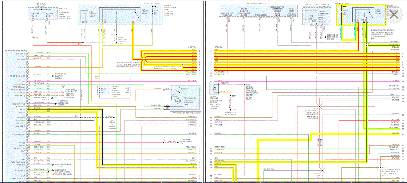

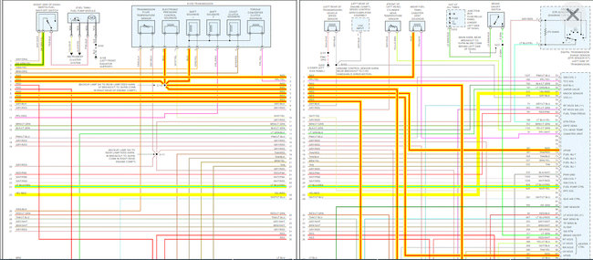

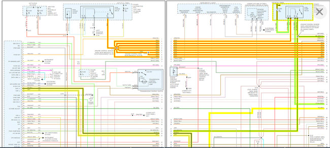

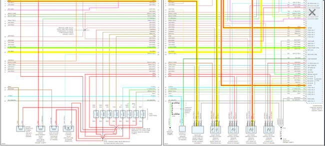

As he said, that is the power relay that controls all power to the fuel pump relay and a lot of other components that I highlighted in the diagrams I sent you.

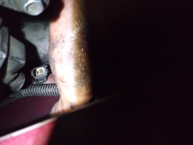

It's not the catalytic converters. I got some off another truck and swap them out and still the same problem. I found a plug towards the back of the motor on top that is not plugged into anything not sure what it's for. I was wondering if maybe you knew.
Jul 29, 2020 at 7:56 AM
Can you post a picture for me of the plug?

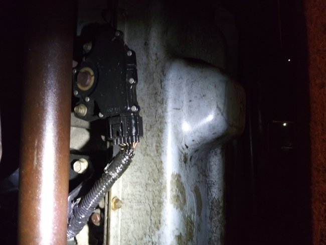

There is that pic of the plug that's not connected.
Jul 30, 2020 at 7:58 AM
JAMESBURROW
  • 46 POSTS
Sorry wrong pic. but I was wondering what that was it's on my transmission and it has oil all over the plug wire I was wondering if maybe that caused it to go out.

JAMESBURROW
  • 46 POSTS
Here's the pic of the plug:

Where is that connector located and what colors are the wires?
Jul 30, 2020 at 8:04 AM
JAMESBURROW
  • 46 POSTS
I figured out where the plug went; it's one of my knock sensors. I changed the idle control valve and now my truck runs a lot better, it's still missing in cylinder 3 and when i take off i can feel it kind of jerking a little. like something is working and then not working, but if i hold the gas pedal in a certain spot then it is okay.
