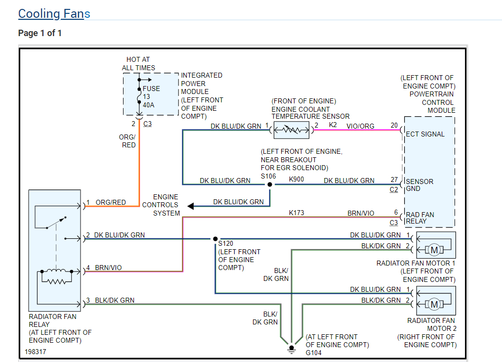

Won't star throws a PO480 code cranks but does not start.
Sep 26, 2021 at 12:04 PM

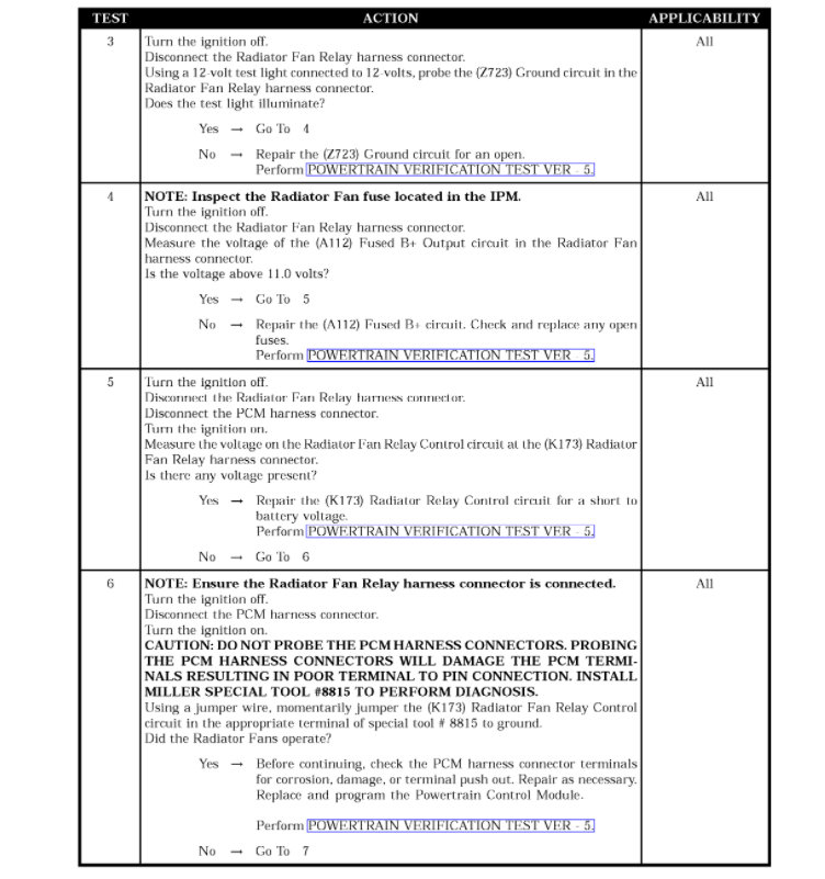

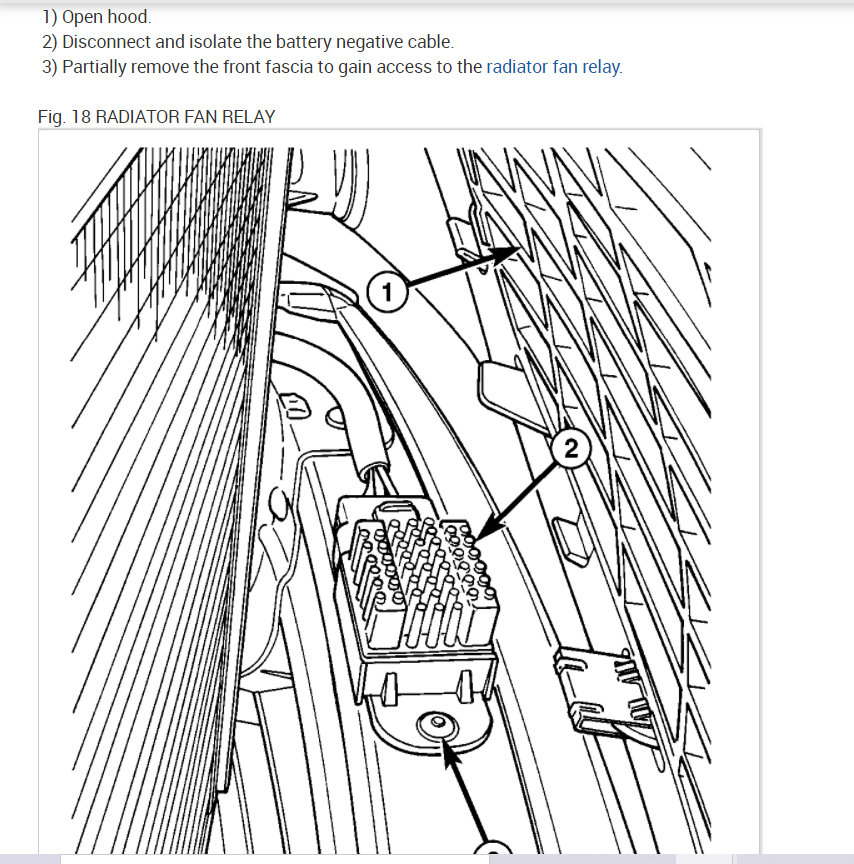

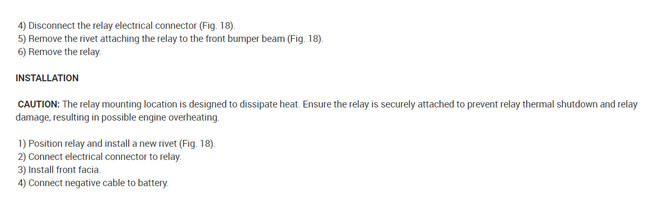

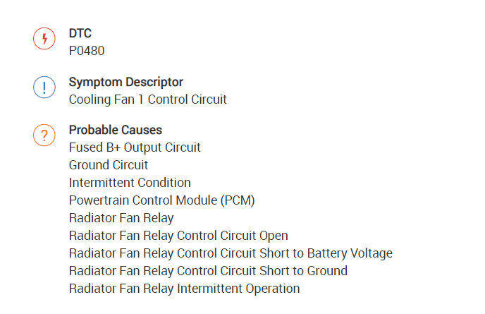

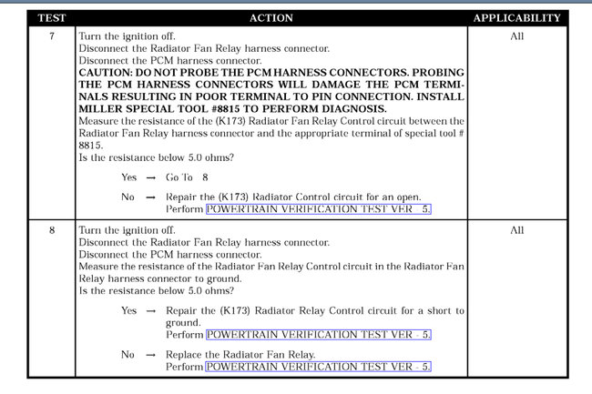

Good morning,

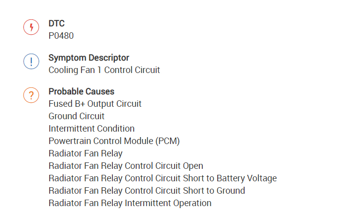

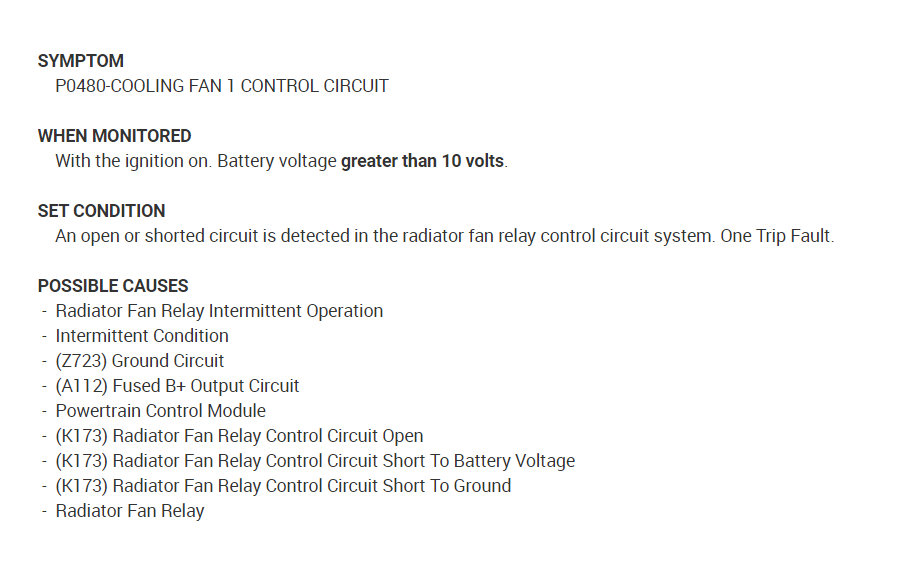

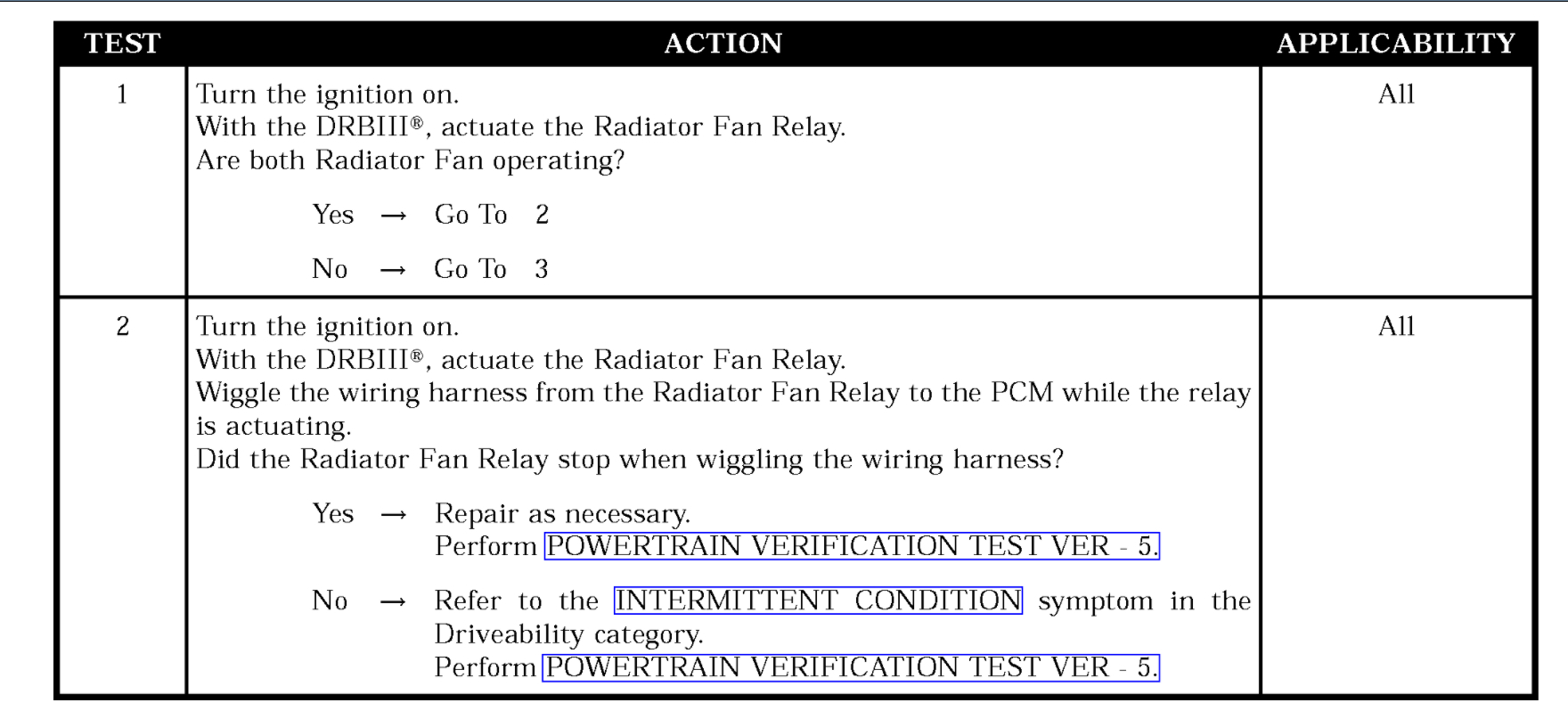

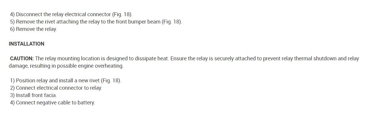

I attached the flow chart for the cooling fan issue for you below along with the location of the relay. The relay is the common failure for this but must be verified.
As far as the no start, this is a separate issue not related to the cooling fan malfunction.
Please start another question for us since site rules allow only one issue per question. I will be happy to help you with the other question when it comes up on my board.
