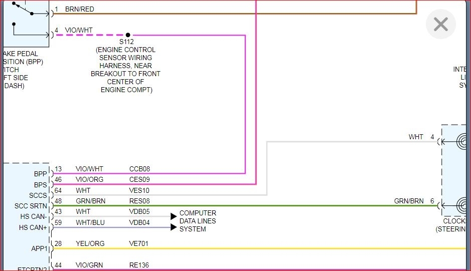

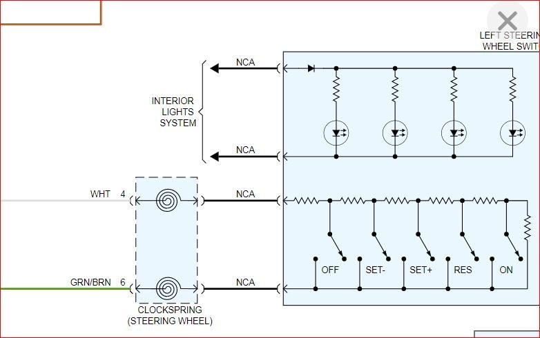

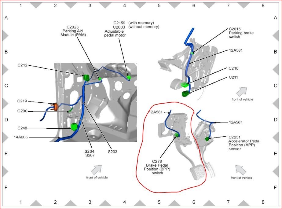

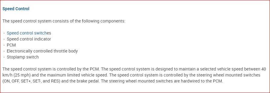

I attached the description of the system and the wiring diagram. As you can see from the diagram, the switch inputs are all a direct feed to the PCM. I assume you are saying the horn still works to rule out the clock-spring?
If the light doesn't come on at all, I suspect the PCM is not getting the input from pressing the button. Is there a chance that this has not been working for a while and not related to what you installed? How often do you use the cruise or do you remember the last time you used it?
If the light on the dash does come on, I suspect your brake switch may have failed and the PCM thinks the brakes are so it doesn't activate the system, however the light on the dash should still come on.

The fact that the light does not come on in the dash tells us that the PCM is not seeing you press the switch. That means it is either not getting the signal or the switch is not working.

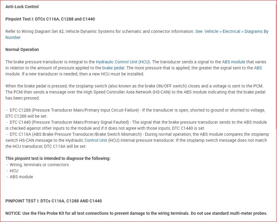

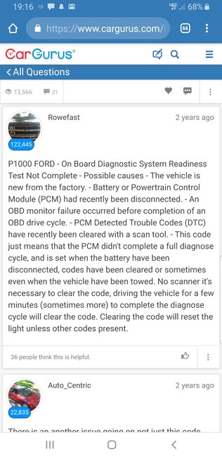

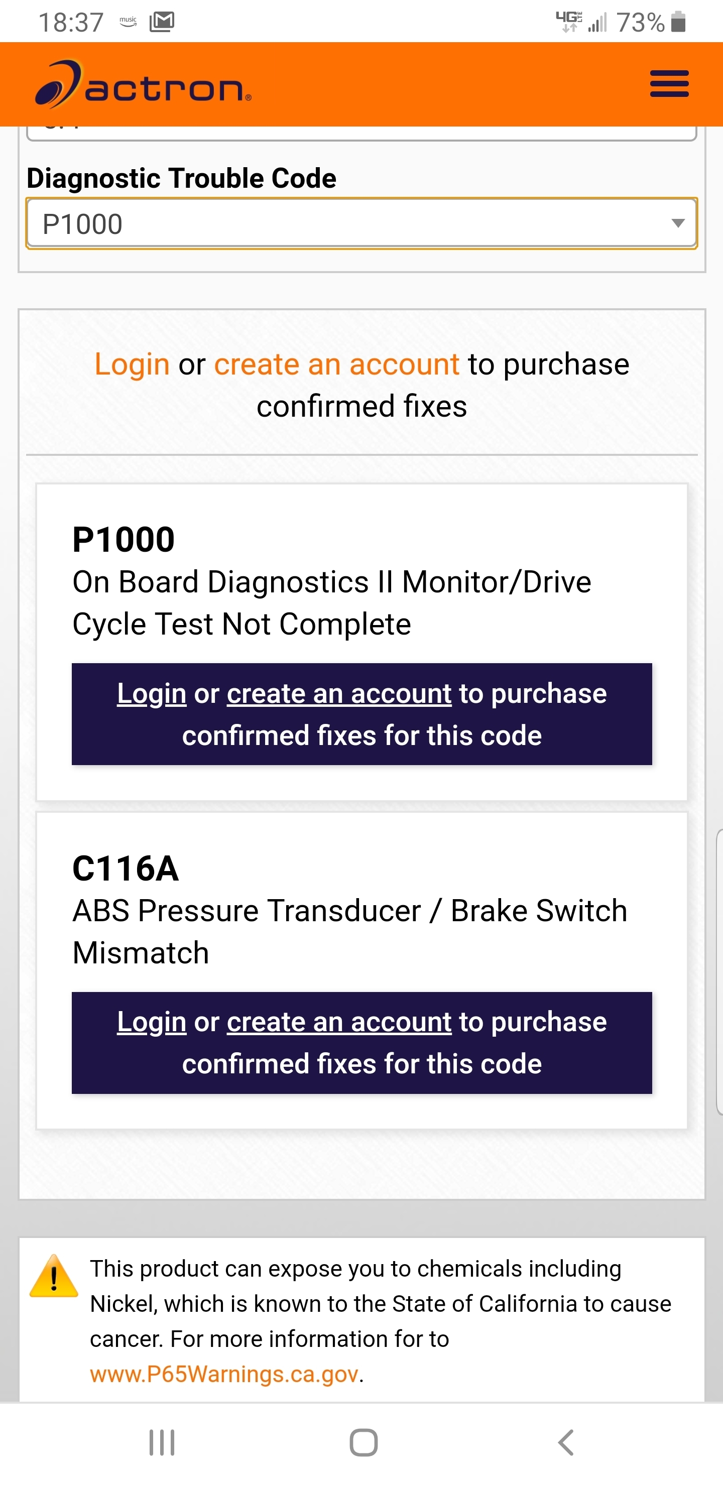

I just got back from getting it scanned at Advanced Auto parts. It found two codes. One is P1000, the other is C116A. The Actron scanner said that the diagnosis wasn't complete after she ran it twice. I looked them up on the Actron website and it said C116A was a ABS pressure transducer/brake switch mismatch as well as the cycle not completing. Someone said in a forum that the P1000 could possibly be the battery/PCM had recently been disconnected. But he was referring to an 2006 F150, if that makes a difference. Got any ideas? Thanks

Okay. The C116A is most likely your issue causing the traction control light to be on and the cruise to not work.
Has this light been on or did it just come on when the cruise stopped working?
They are correct about the P1000 code. This just means that some of the sensors have not learned in the PCM and usually happens when the battery is disconnected or the memory of a module (usually PCM) has been cleared by clearing codes.
Let's focus on the C116A. This code is telling you that the PCM thinks the brakes are depressed or at least there is an issue with the circuit. Furthermore, the ABS is comparing the pressure on the transducer to the signal it is receiving from the brake switch and they don't match. In other words, the most common cause of this is the brake switch says the brakes are on but the pressure transducer does not see the brakes being depressed.
The brake switch is the electrical component that tells the PCM that the pedal is being depressed. The Transducer is the mechanical component that increases pressure when you actually press the pedal. These need to agree or you will set this code.

Unfortunately, there isn't a specific harness that I can point you to other than the connection point from the brake switch and the ABS/HCU.

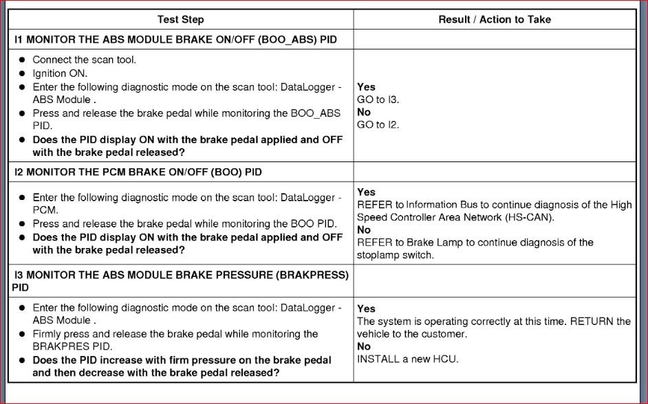

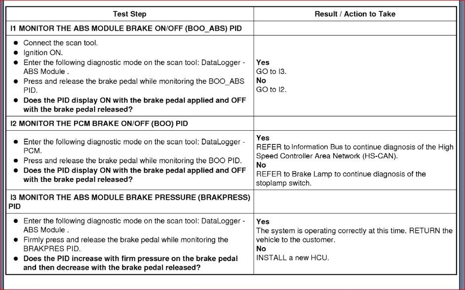

I don't know any other way to verify proper operation without a scan tool to look at the ABS and PCM brake input. Basically, here is what you are looking for. When you press the brake pedal, does the PCM see the brake being depressed (Brake switch) and does the ABS see the brake being depressed (Pressure transducer)? If both see the brake being depressed then you have a wiring issue on the CAN network. If one or the other do not see the brake being depressed or see show it being depressed when it is not, then that is your issue.
At this point, you have eliminated the brake switch. So that means it is either the HCU (pressure transducer) or the CAN network wiring. Neither of which you want to guess at.
Unfortunately, I think we are at the point of needing a scan tool to figure this one out or a wrong choice can be pretty costly.
