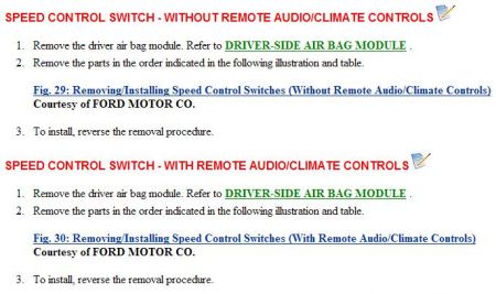

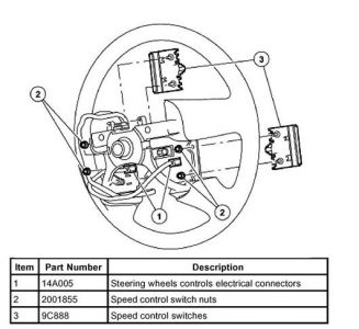

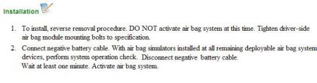

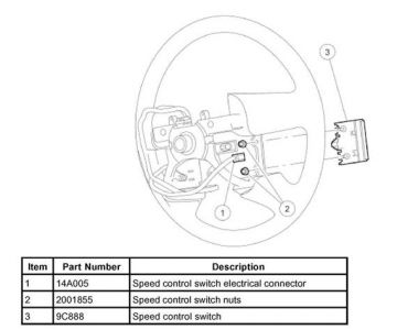

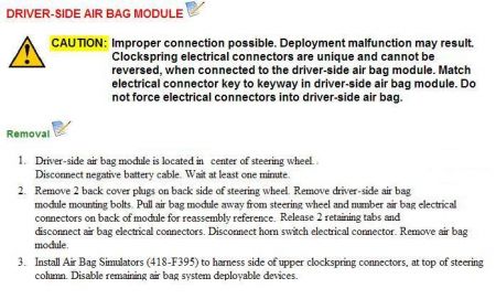

I would like to know the procedure to replace the cruise control switch. I have a replacement switch, the OEM switch was damaged by my dog.
Feb 16, 2010 at 8:19 PM
BLUELIGHTNIN6
✓ASE Certified Mechanic
16,542 POSTS
Hello and thanks for donating!
FIG. 29
FIG. 30
Feb 16, 2010 at 9:32 PM
