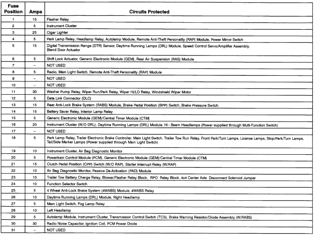

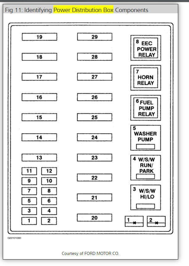

My cruise control and my horn have stopped working. The cruise buttons don't even light up at night anymore. I can't find anything in the owners man. About a fuse or relay for either of these things. Can you help me?

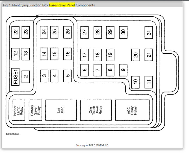

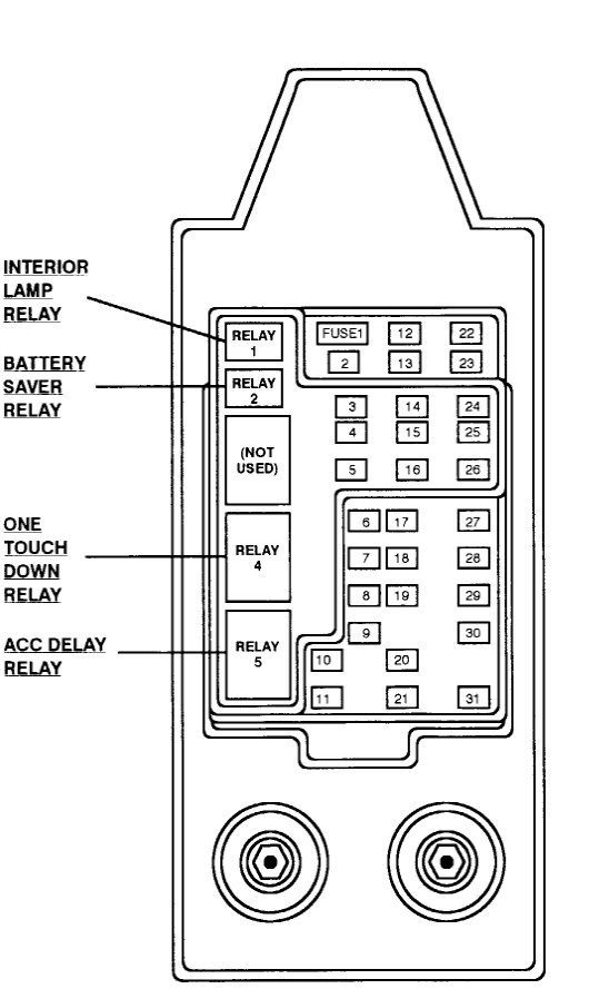

I believe you are dealing with two separate problems. Did they both stop working at once?
Check your fuses this guide will help with the fuse locations below.

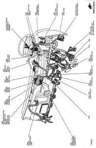

Check out the diagrams (Below). Please let us know what you find. We are interested to see what it is.

I can't find, in the owner's man, which fuses are for the horn and/or cruise control as they both stopped at the same time, I believe the problem must be related. The diagram you sent me is to small to read and when I enlarge it, it goes out of focus.
Thanks for your assist. Please keep the info coming, I don't want to have tp pay Ford to do this for me.

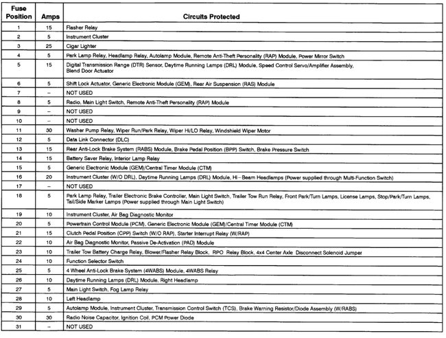

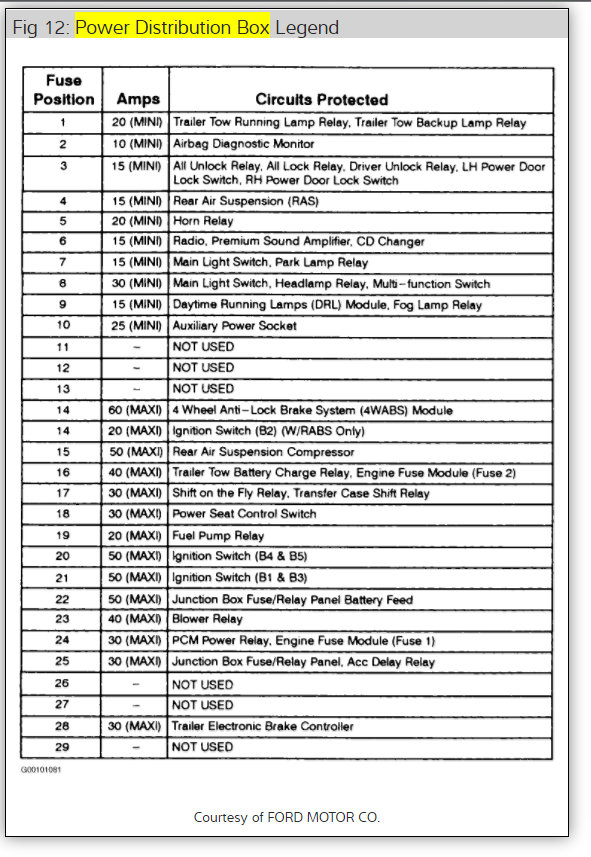

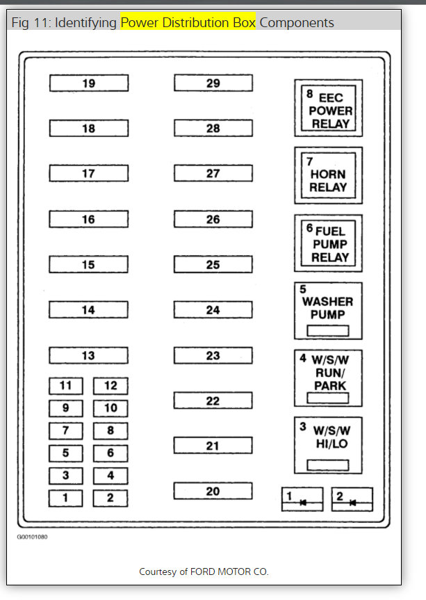

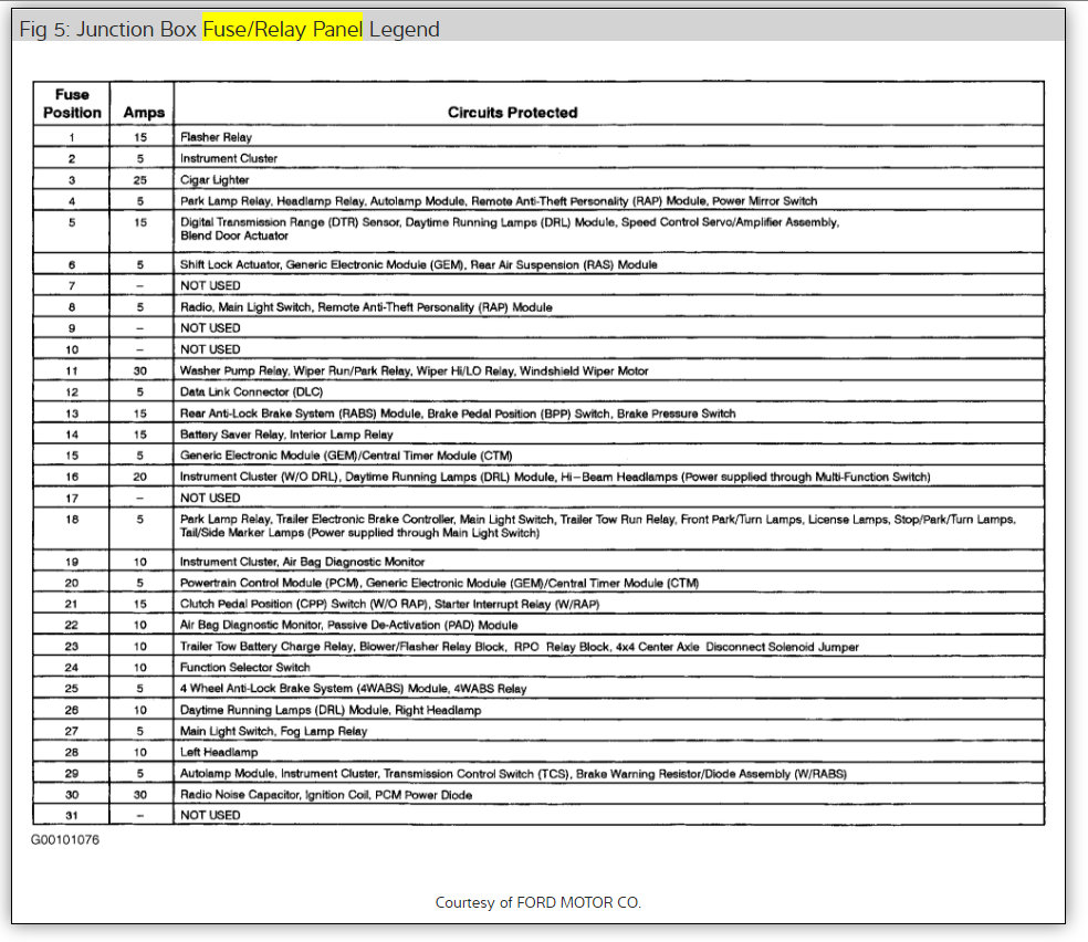

On the troubleshooting chart for Speed Control Inoperative, in order to check is a: Blown fuse, Circuitry, Stoplight switch, burnt stop lamp bulb, speed control actuator switch assemble, vehicle speed sensor, and speed control servo.
You can checkthe stop lamps and fuses. If you want you can check fuses, E, N, 8, 13 and 18. Under the hood fuse panel check 5
