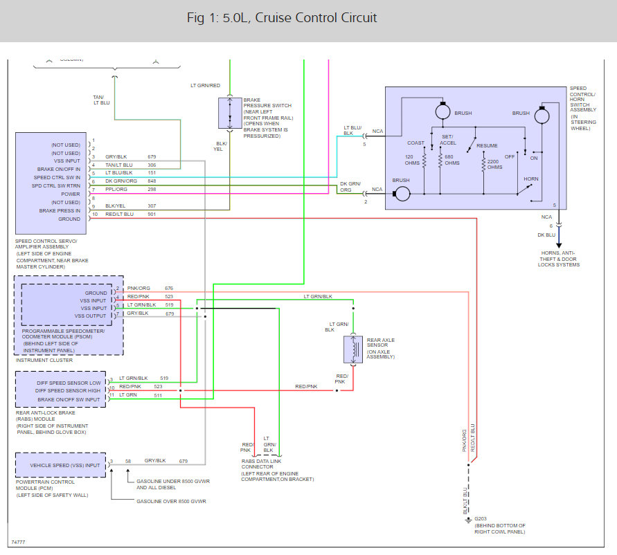

Cruise control just stopped working. All fuses are good and everything inside cruise box under hood not seized and moves freely. What else can I check to fix this issue?

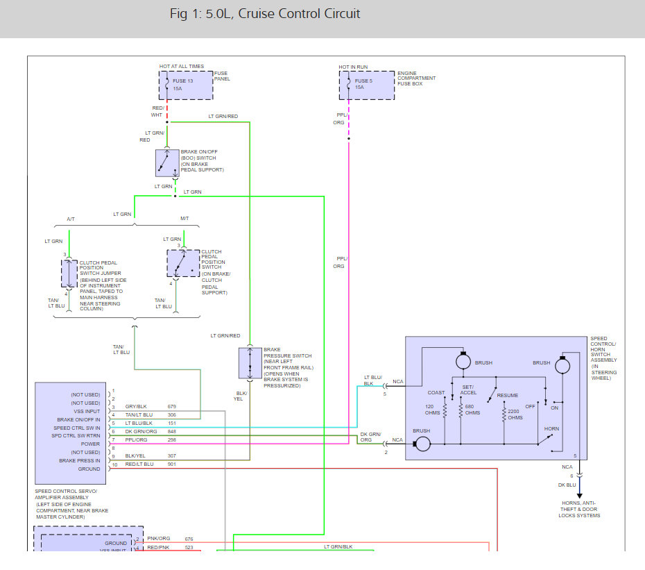

It usually is the cruise control servo that goes out but to be sure lets make sure it is getting power and ground. Also, test the brake light switch. Here is the wiring diagrams and a guide to help you run some simple test and see how the system works:
