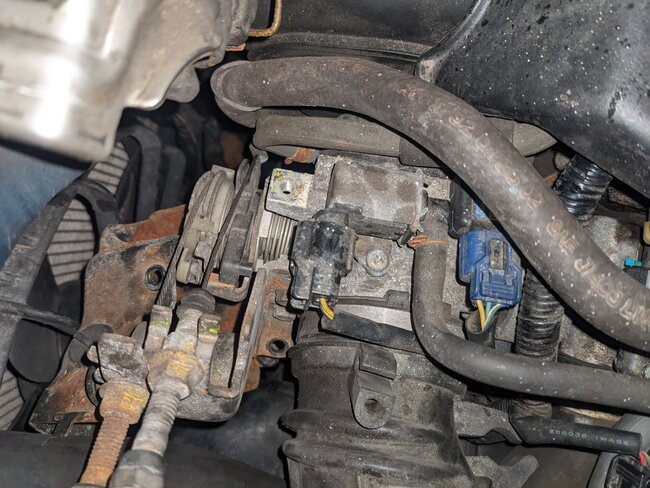

Are there any lights staying on such as ABS, traction control, stability control, or others?

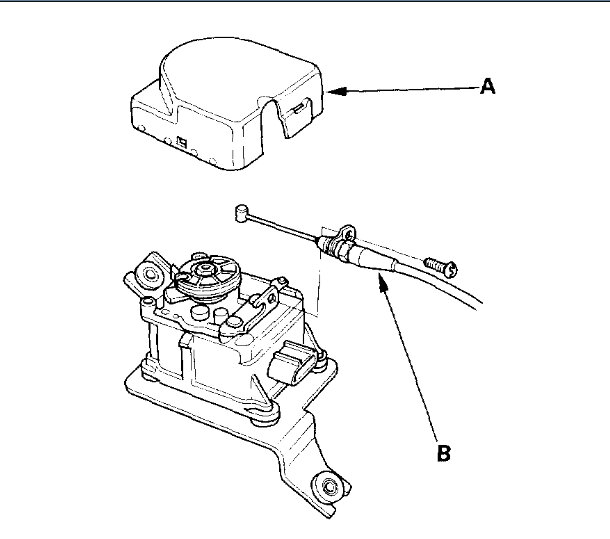

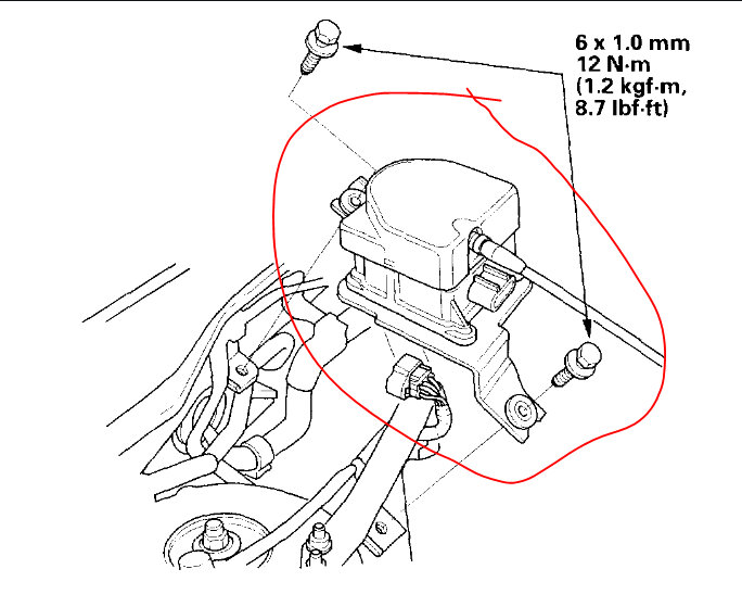

If there are no other lights, the first thing I want you to check is the actuator cable that attaches to the throttle body. Make sure it is properly installed and not damaged.
See pics below. Pic 1 shows the end which goes to the throttle body. Pics 2 and 3 are from the actuator motor that actuates the Cruise Control.
Let me know what you find. Also, let me know about any lights.

It was the cable! Thanks
