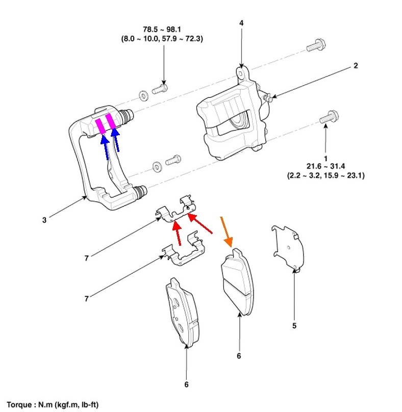

I added some nifty arrows to the exploded view to try to describe this better. The orange arrow is pointing to one of the mounting ears for the inner pad. That ear is pressed against the mounting bracket by the pink spot on the right, (blue arrow). That's one of the places we grease. When the rotor is warped, even a little, that ear grinds back and forth during braking, wearing the pink grooves into the surface. Even that may not cause a noise yet because the pads are remaining within those worn spots. It's when anything changes where the pads ride that can setup the clicking noise. New, thicker pads will push the inner pad's backing plate closer to the caliper, (away from the rotor), placing the mounting ear outside that worn area. Now, as the rotor wobbles back and forth, it pushes the pad's ear into and out of that worn spot. That makes the clicking noise.
There's a number of ways to address this. For most domestic vehicles, the easiest is to replace the mounting bracket or steering knuckle. For most imports this isn't a concern because they use stainless steel inserts to become the wear surfaces. The two red arrows are pointing to one of those inserts. This is the one that gets the forces put on it when braking going forward. Those inserts stand up to wear really well, but you still usually get new ones with new pads. If you don't, they are available as a repair kit.
The less-desirable repair method is only used on rare vehicles when replacement parts are hard to come by. That is to heat the wear surfaces for a long time with an acetylene torch, then fill in the worn spots with a wire-feed welder. Grind those surfaces smooth and flat to restore the original shape. These mounts are made of cast iron which is porous. They will crack or shatter when trying to weld to them. The preheating prevents that, but I've seen people take up to three hours of preheating to repair cracked exhaust manifolds. I've made this type of repair a half dozen times, and preheating for as little as 20 minutes was enough to prevent shattering. I've done this on these pad mounting surfaces, and with cracked anti-lock brake tone rings on outer CV joints.

I'd consider removing the wheel, then put on at least two lug nuts to hold the rotor tight. Run it in gear and watch to see if the caliper is moving back and forth. If it is, it is either warped a little, or there can be a piece of rust or scale caught between the hub and the rotor's mounting plate. If you don't see the caliper shifting back and forth, have a helper press the brake pedal lightly while keeping the speed up. If the caliper is working nice and freely, the piston may get pushed enough that the caliper no longer gets pushed back and forth by the wobbling rotor. Pressing the brake pedal will keep that piston out and adjusted so the movement will be easier to see.
