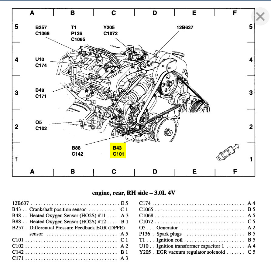

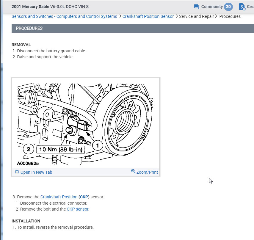

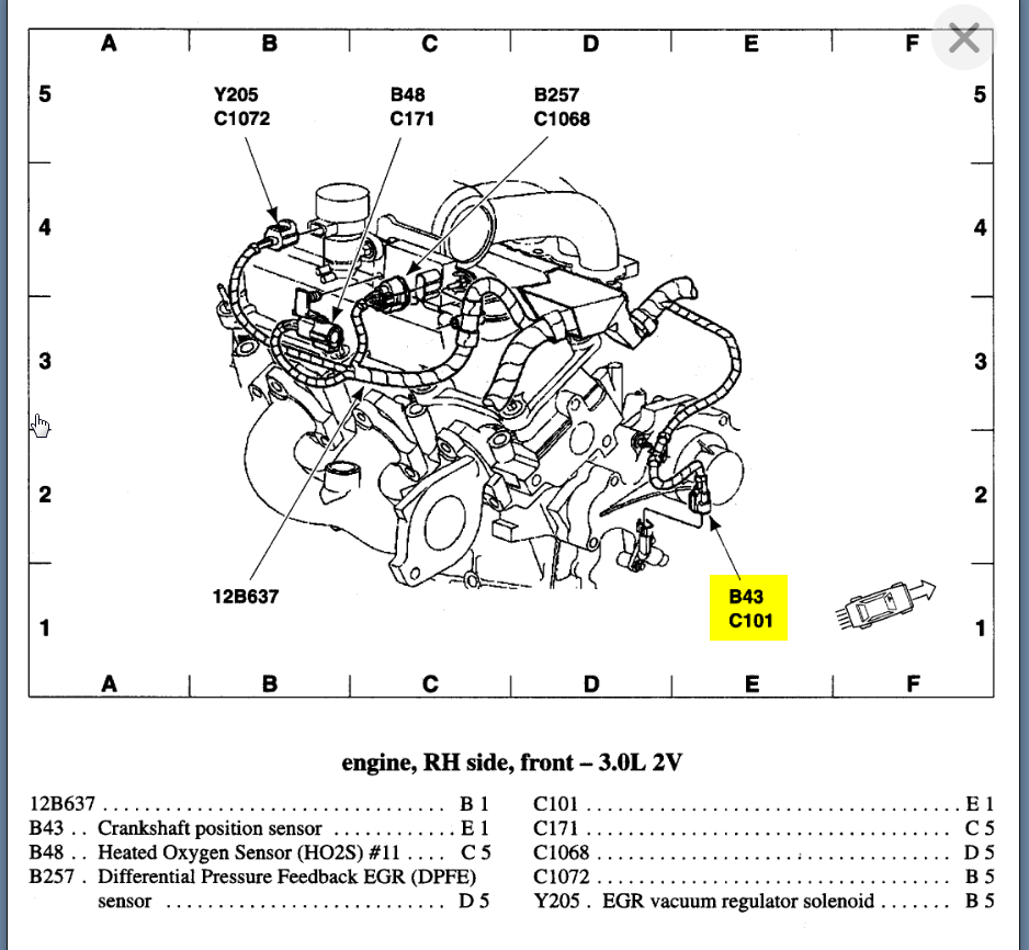

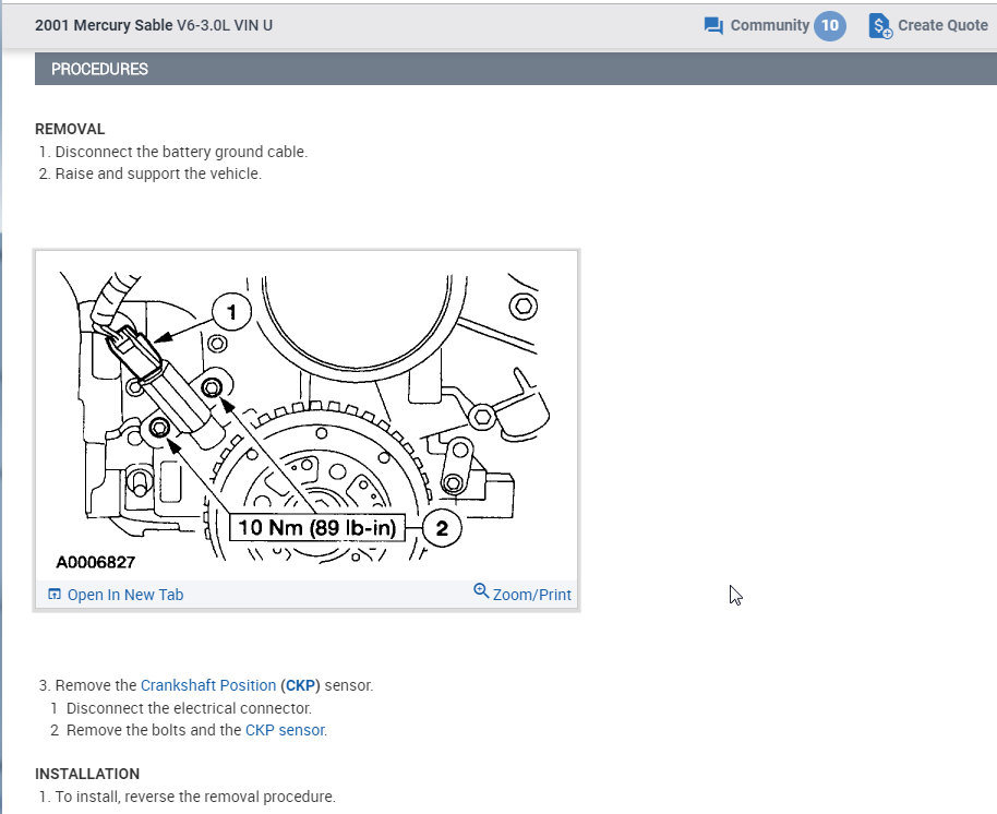

We are having to replace the sensor and need to know it’s location and replacement process.
Dec 27, 2019 at 4:48 AM
Depending on which engine you have (SOHC or DOHC) the position is a little different. It is basically the same location but I attached both. Let me know if you have more questions.
First two are SOHC engine. Second 2 are DOHC engine.
