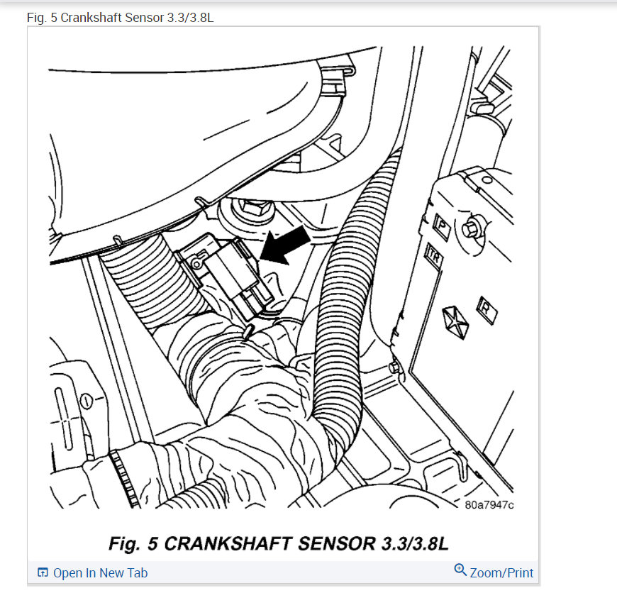

Crankshaft sensor broke off flush with block. I've read about folks drilling a hole and threading a screw or bolt into the sensor on different vehicles to try to extract it from the block, but I don't see any way to get a drill in that tiny space on this vehicle. I went in through the top/side by removing the battery, tray, and cruise control servo but I could barely even get my hand in there to take out the 10mm bolt. I can see no way to possibly even think about getting a drill in there. Can the sensor be knocked into the block and removed from the pan or will it bottom out against the flywheel teeth? Is that even feasible? Any tips? Don't know where to go from here. Thanks!

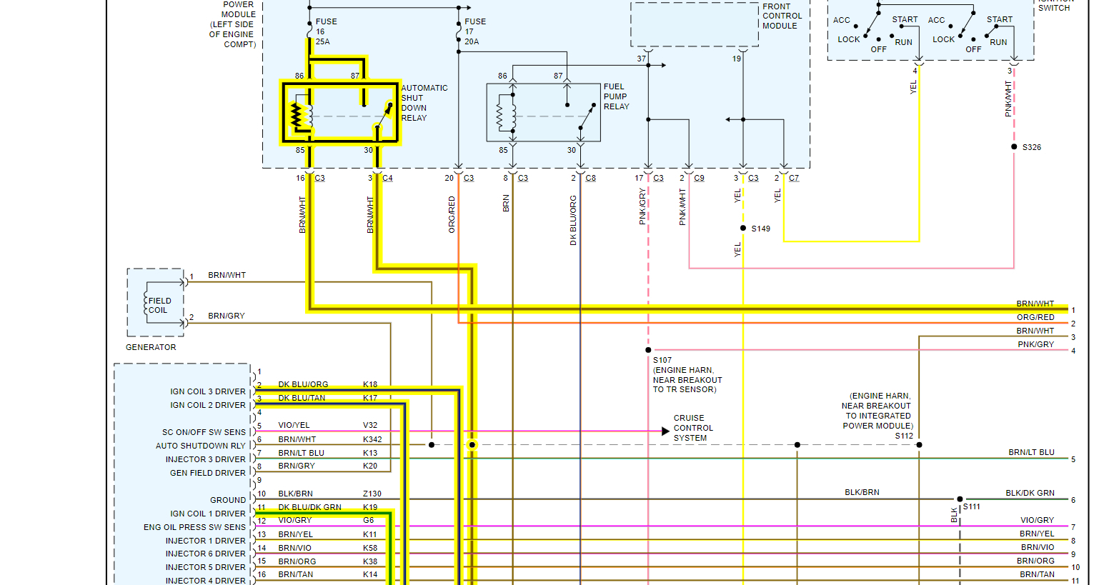

Okay, after spending the entire day, losing most of the skin on my right hand, and inventing several new cuss words, I somehow got the broken sensor out! I also replaced the camshaft sensor in addition to the crank sensor. But, still no spark. I swapped out the ASD relay with another known working relay and all the fuses are good. There is no 12V going to #3 brown/wht on the coil pack or any 12v pulses to the other three when the key is turned. There is 12V at the ASD fuse and at #85 and 86 at the ASD relay.

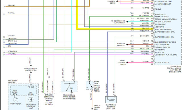

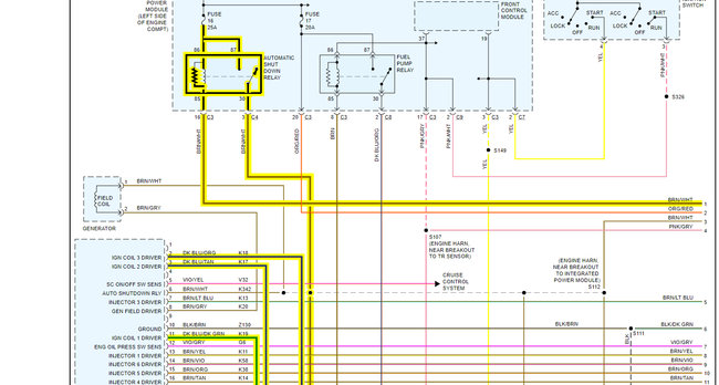

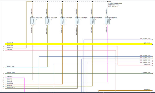

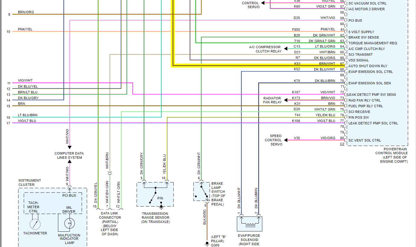

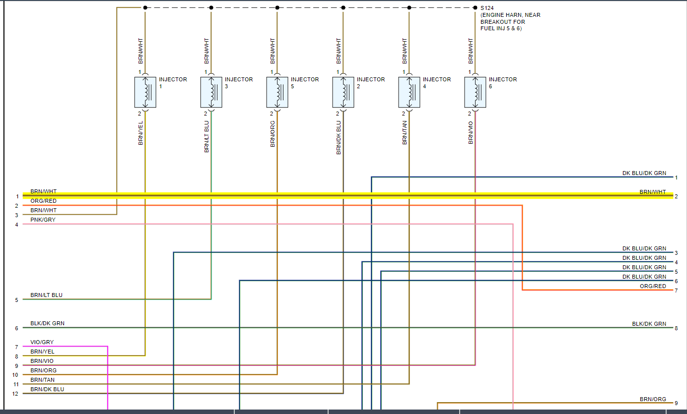

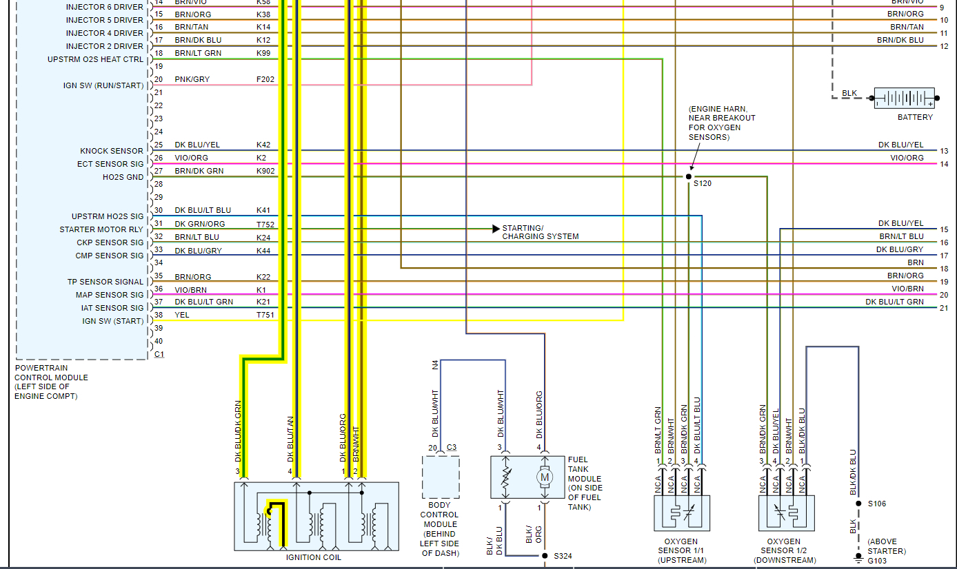

I attached a wiring diagram for you of the ignition system.
The brow/white wire should have 12 volts with the key on.
The auto shut down relay controls this power. The ECM grounds the control side to activate the load side.
There is a very good chance you have a bad ECM as it is not grounding the control side. I highlighted the wire that goes to the ECM. You need to test that wire for power with the key on and the connector off.
Saturday, July 31st, 2021 AT 4:39 PM

Okay, I'll get back into it tomorrow. Yeah, the brown/white on the coil did not have 12v with the key on. So the PCM isn't sending + voltage to the coil pairs then, it's pulsing the negative to fire the plug pairs, assuming the 12v+ constant is already there, correct? So when I jumped 12v to the constant power to the coil and the van started, that had to mean the PCM was pulsing the negative to the coil pairs? I wonder if I've got a bad wire. I'll check the wires you highlighted.
