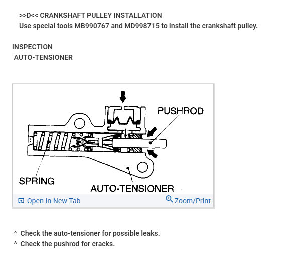

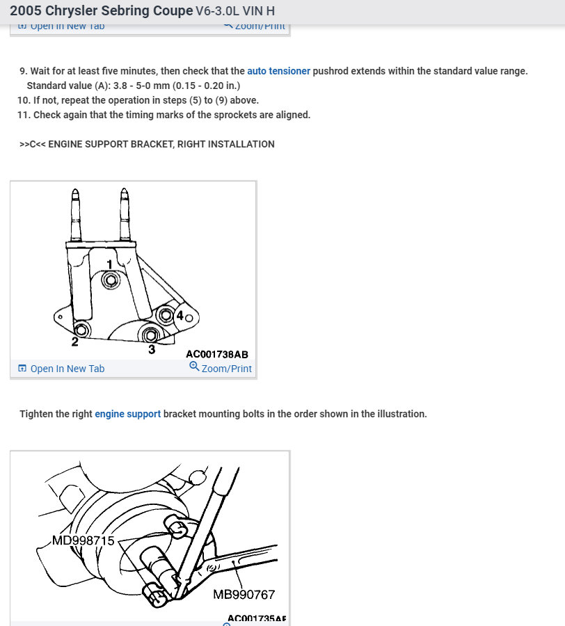

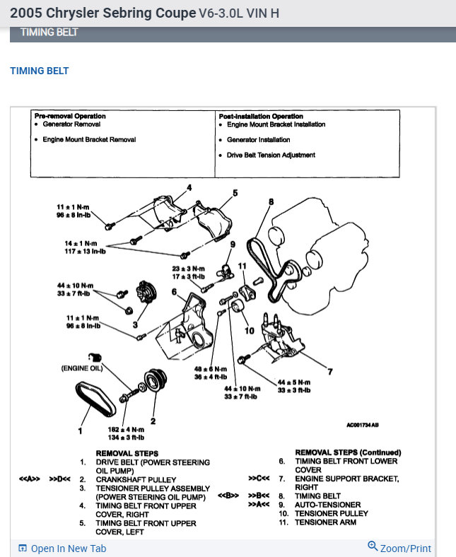

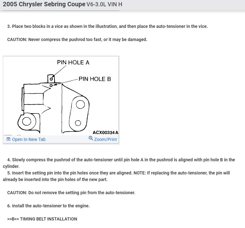

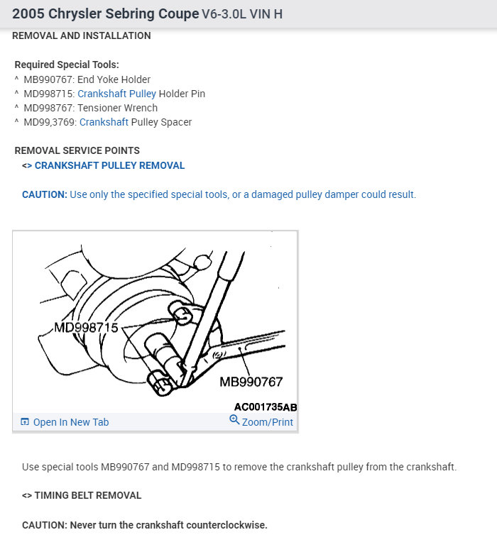

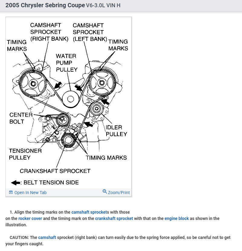

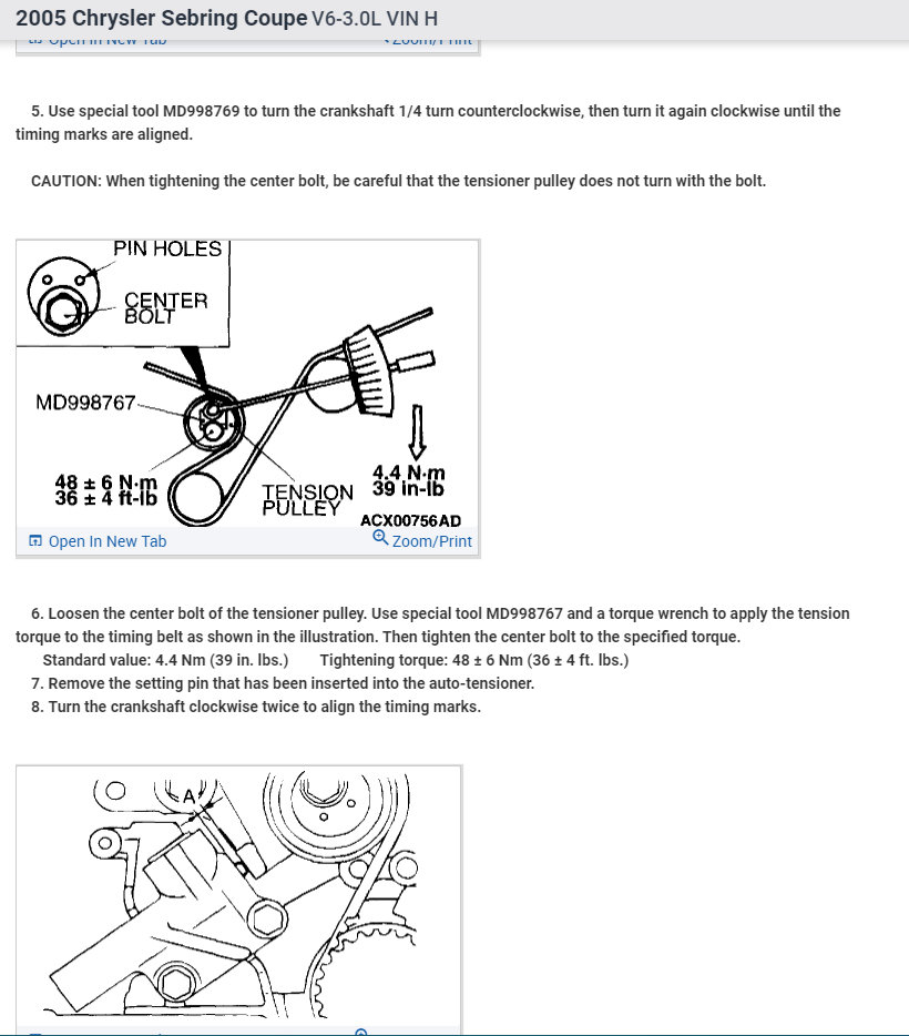

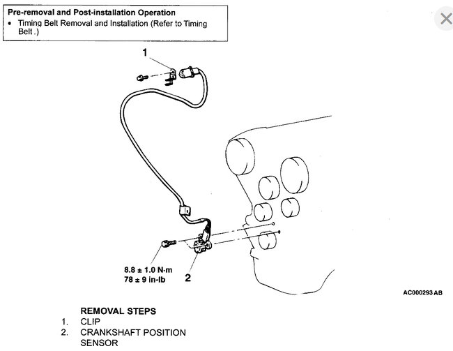

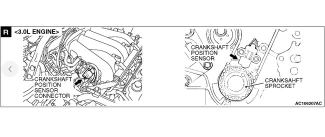

The crank position sensor is located just above the crankshaft pulley.
In order to replace the sensor, you will have to remove the timing cover and possibly the timing belt.
Can you tell me what was the code that you got?
Here is a guide that covers the typical symptoms of a bad crank position sensor:

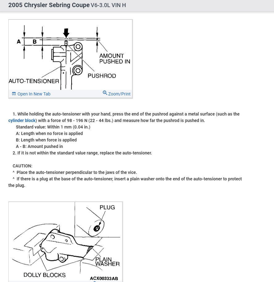

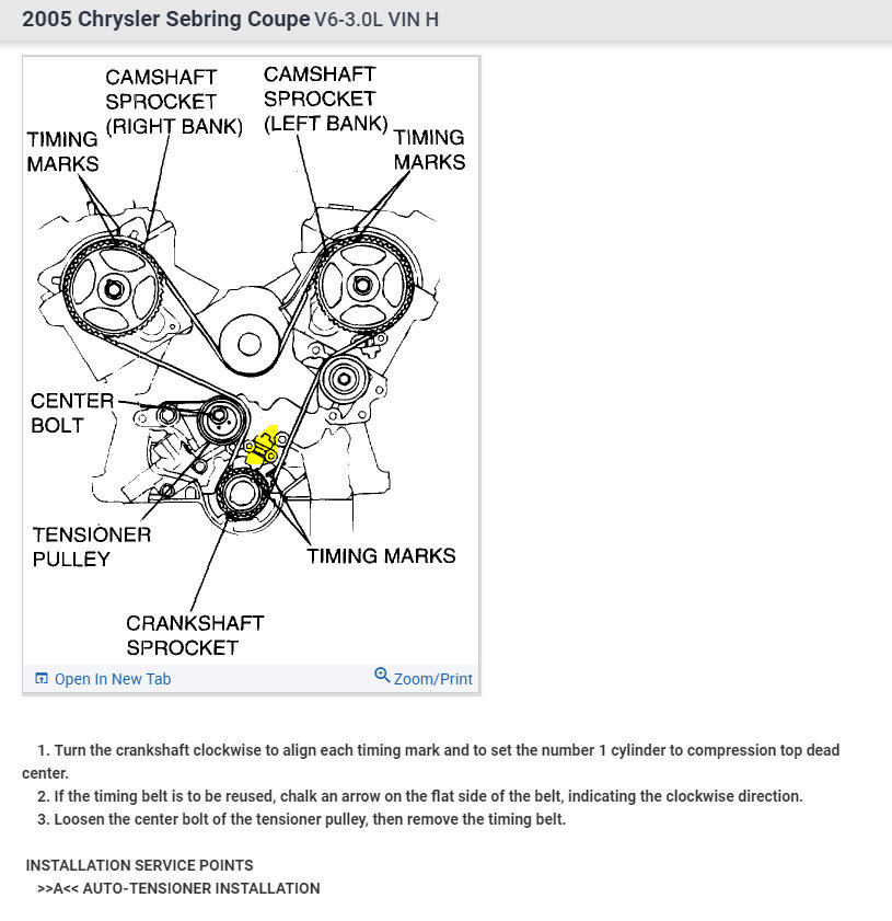

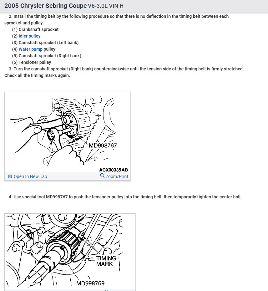

I have attached the replacement procedure below for your reference.
Let me know of any questions.
