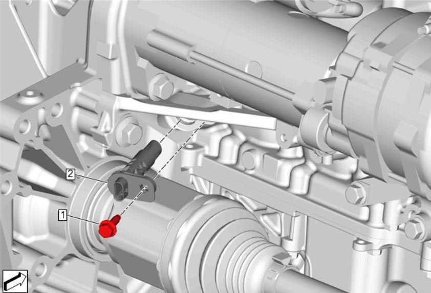

Where are the crankshaft position sensors located? I've scoured the net and can't find where they're at. Tia

It is on the rear of the engine just above the edge of the block girdle at the flywheel end of the block. Tucked behind the right drive axle. The bolt is torqued to 89 inch pounds. Once replaced you need to use a scan tool to do a crankshaft position relearn to be sure the sensor parameters are reset for the new part.
What is the reason for replacement? They rarely set a code when they fail but can cause issues when they get heated.

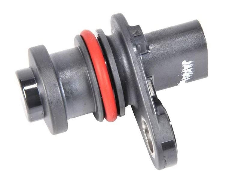

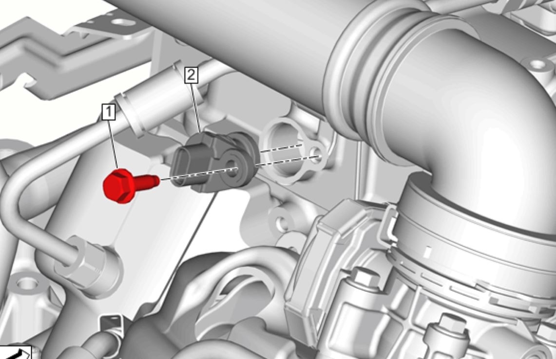

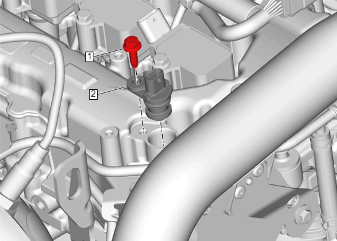

I changed one cam shaft sensor in the front of engine next to the vacuum pump that I replaced. I was unaware that there was a second one, I'm guessing towards the rear of the engine on top? I was confused at first, thinking the VVT's on the passenger side of the engine were either cam or crank sensors.

If the one you changed was straight behind the pump that is the exhaust sensor. I would still try the oil change. If it had that code prior to the pump change it sounds like it might be the cam sprocket itself locked in the advanced position. Change the oil and let the engine warm up and see if it changes. If not then you will likely need to open the engine to get to the sprockets. But I would do testing before that using a scope and scan tool. I would also try a KAM reset using a scan tool first and see if it will allow the reset, then test it to see if maybe it is just a weak sensor.
