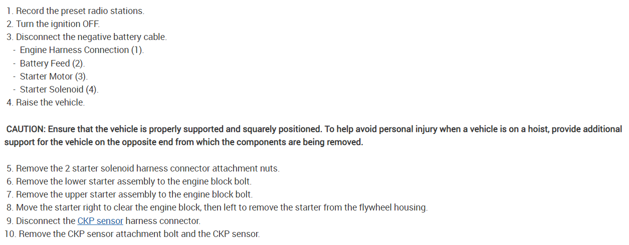

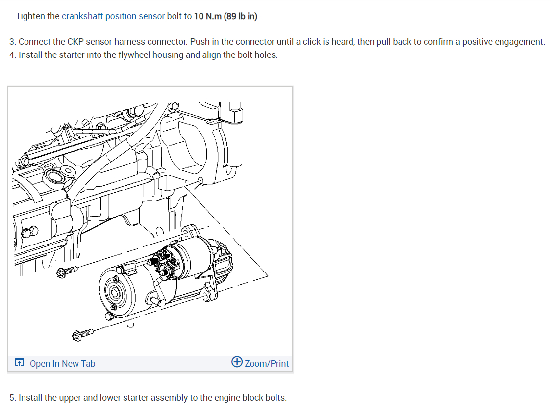

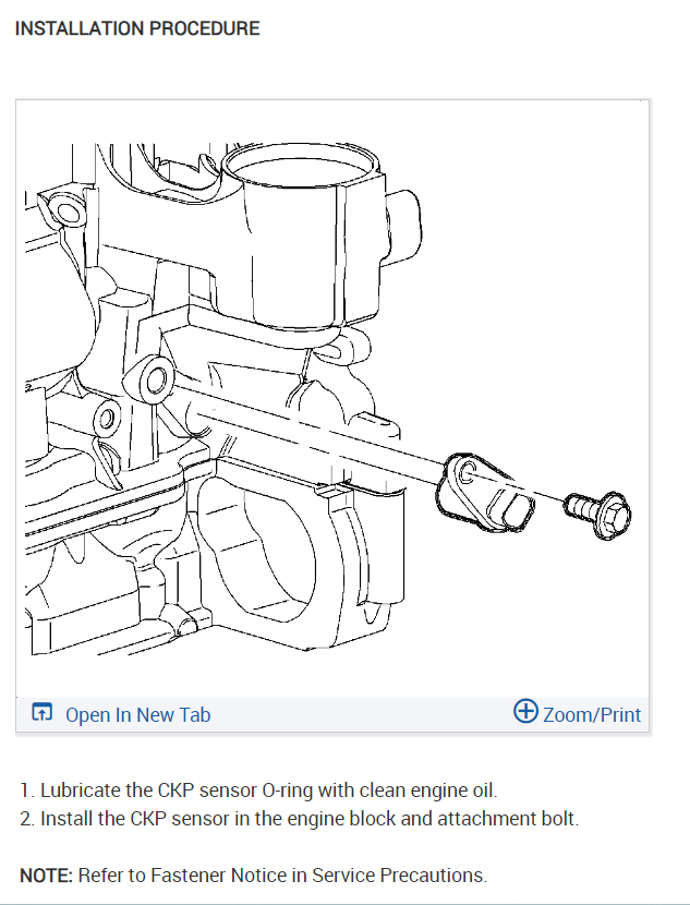

Where is the crankshaft position sensor located?
2005 CHEVROLET MALIBU
200,000 MILES • 2.2L • 4 CYL • 2WD • AUTOMATIC
KANDYCE GUERRA

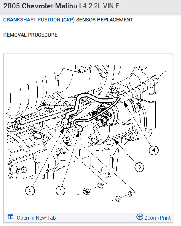

Crankshaft position sensor location needed.
Dec 3, 2023 at 1:25 AM
  • 55,456 POSTS

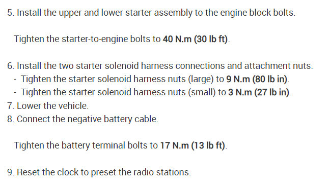

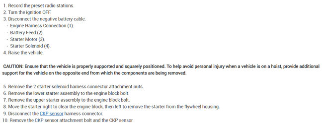

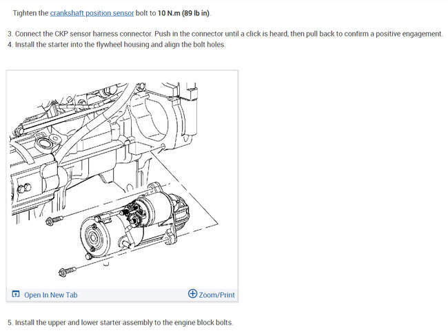

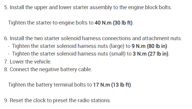

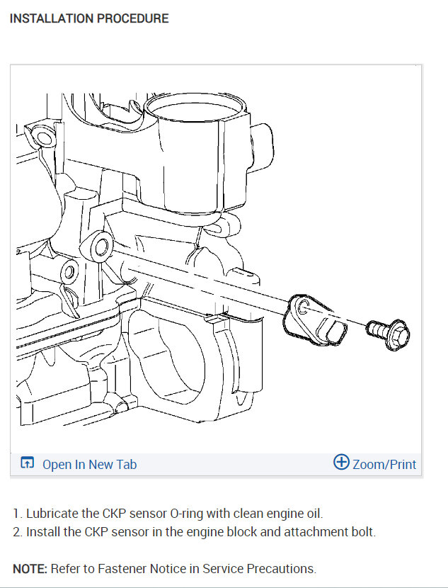

The crankshaft angle sensor is on the left side of the engine behind the starter motor so it will need to be removed, start by disconnecting the battery. Here are the instructions on how to change the crankshaft sensor out. Check out the images (below). Let us know if you need anything else.
