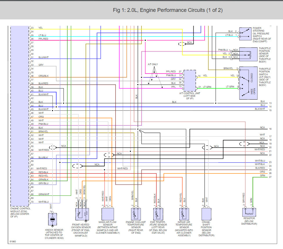

Crankshaft position sensor. Can you tell me if I am supposed to have a 5 V reference signal on the black wire at the crankshaft position sensor? Also, what should my resistance be when the engine is running? And how should I test the voltage on the crankshaft position sensor when the engine is running? Any assistance would be greatly appreciated. Thank you so much for your time.

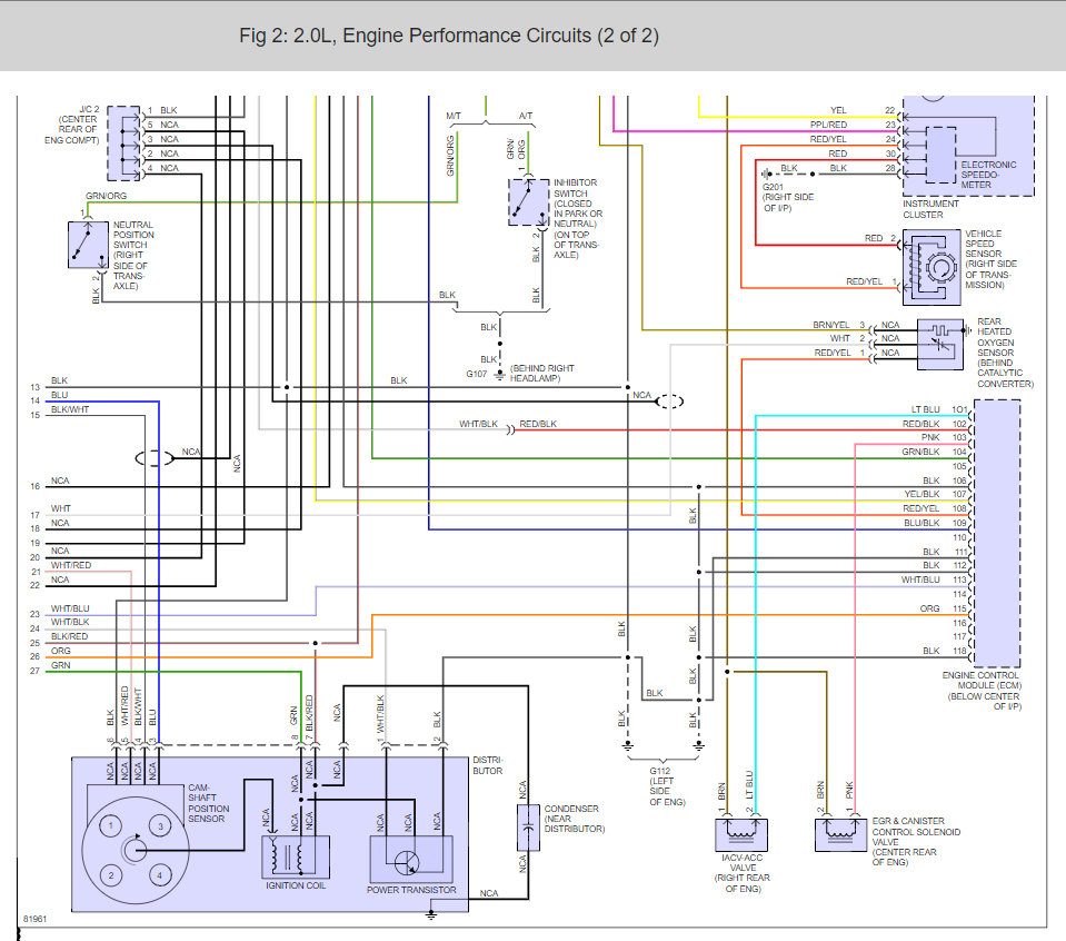

I would say your blue wires is the 5 volt reference. Just check to make sure the sensor is not open. The only way to fully test the sensor is to read the waves which is done with an oscilloscope.
Here is a guide and some wiring diagrams (below)
Please let us know what happens and upload pictures or videos of the problem.

I guess what I need to know is, I have a black and white wire at my CPS. From what I am seeing in the manual I should have 5volts on the black wire. I do not have 5 volts on that wire. The CPS is new. Also the car runs and drives fine until it gets warm and it starts wanting to cut off. Also I can turn off the check engine light off anytime warm or cold and it will run fine and the light will not come back on again until the ley gets cycled off\on. So I guess I need to know is there some kinda of fuseable link between the CPS and the ECM? Also a pin out of the ECM would be very helpful.

There is a pin out diagram in the above post. It sounds like the ECM is going out to me.
