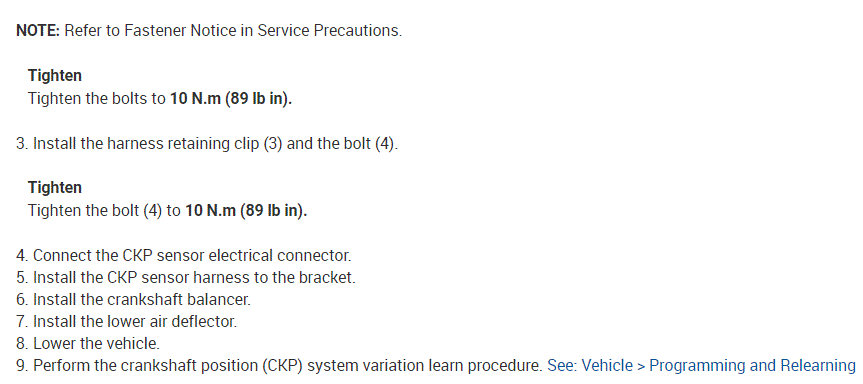

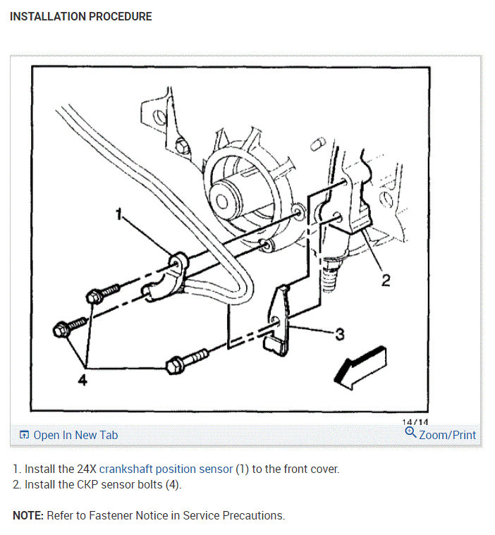

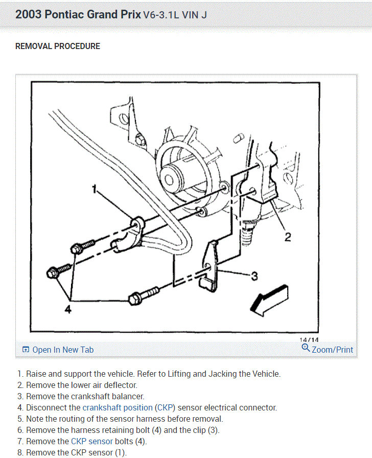

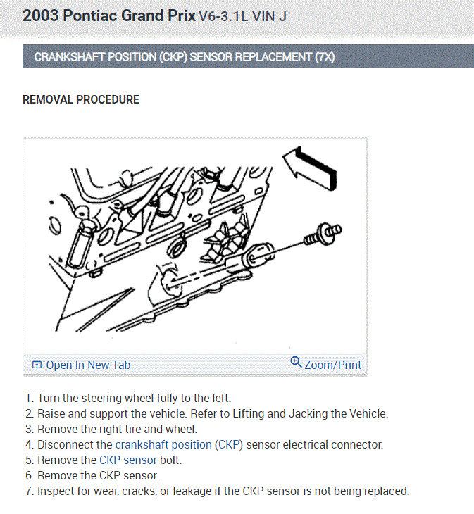

I need to know the location and if there are two crankshaft position sensors on my car listed above.
Apr 15, 2021 at 1:14 PM
  • 110,240 POSTS
The vehicle will have one sensor. However, there are two variations for location. One is on the side of the engine and the other is on the front behind the crankshaft position sensor.
You will need to check your vehicle to see which one you have.
To get you started, here is a link that shows in general how one is replaced:
Next, if you look at the attachments below, I've included the directions and pictures for both.

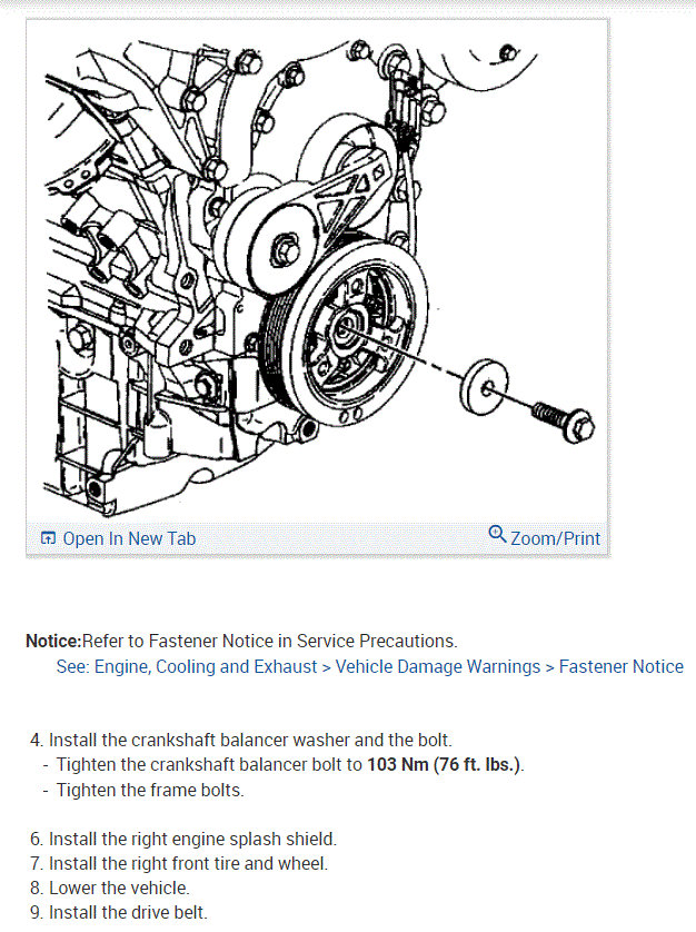

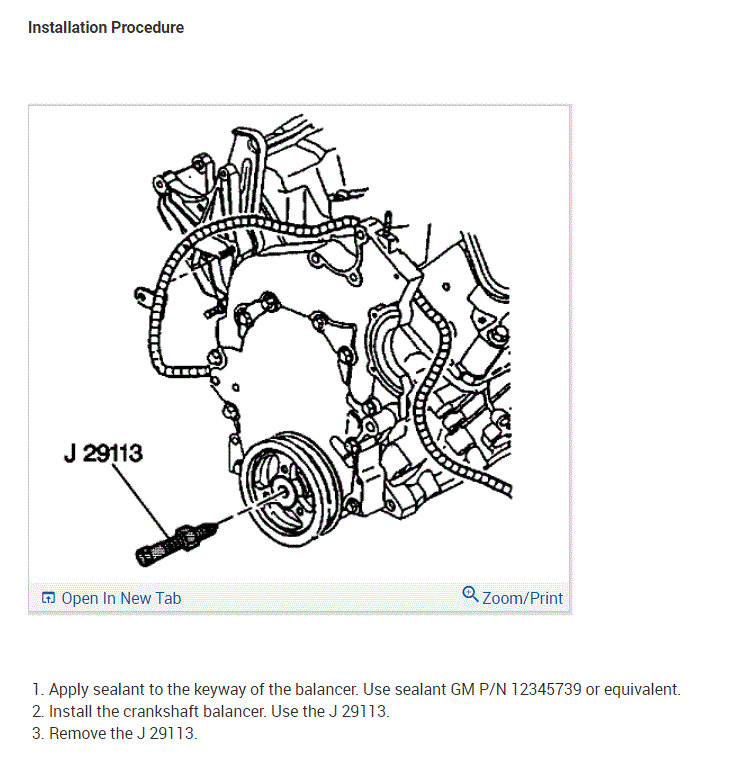

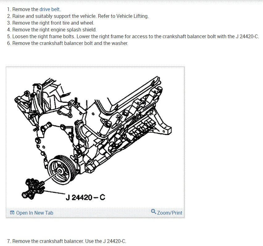

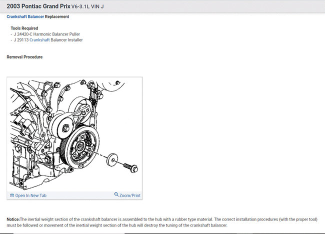

I have another question relating to the Pontiac Grand Prix 2003 I cannot get the crankshaft balancer bolt out I've tried an impact wrench I have tried a breaker bars I've tried everything I've broken sockets are broken bent 2 bolts. Please if you have any ideas let me know I don't know what to do with it
Apr 27, 2021 at 10:32 AM
  • 110,240 POSTS
The impact wrench should have taken it off for you. What kind of impact are you using? Is it battery-operated, electric, or pneumatic?
I attached the directions below specific to removal. It is a straightforward procedure.
Which bolts bent? You mentioned there are two.
Apr 27, 2021 at 12:07 PM
TONDA BOWMAN
  • 11 POSTS
The bolts that bent where the ones that are put in to keep the pully from spinning. And it was a pneumatic wrench you know and air tool. that was after the impact wrench didn't work we tried breaker bars 6 point sockets and the bolts to keep the pully from moving.
Apr 27, 2021 at 4:30 PM
  • 110,240 POSTS
The only other thing I can suggest is to put a good wrench on it and smack the wrench a few times with a heavy hammer. That will often break them loose.

Yes, we finally found a airgun with enough umph break it loose.

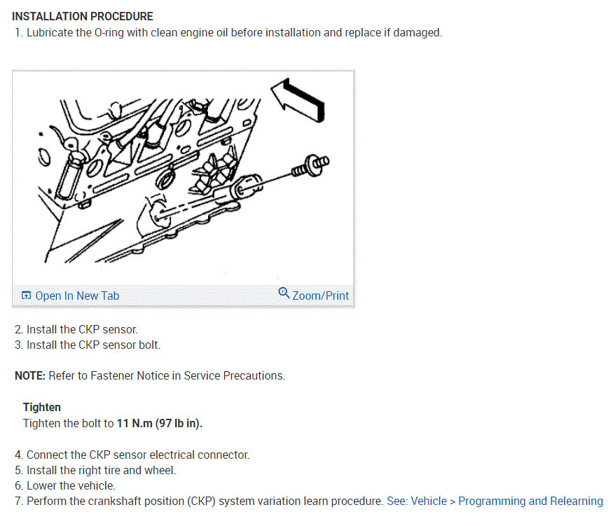

Yes, we changed the crankshaft sensor and everything works fine, but I still have the original problem with the car stalling while I'm driving down the road intermittently.
