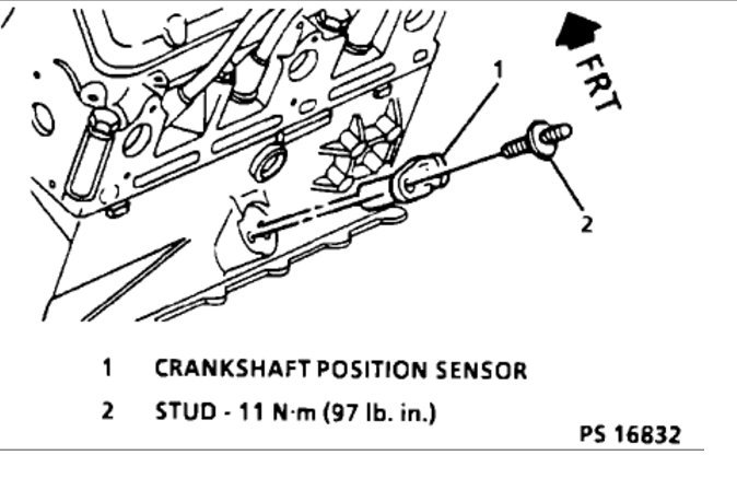

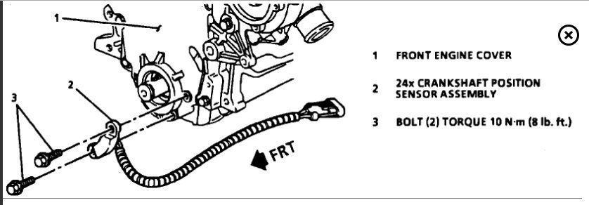

Can anyone tell me where the crankshaft sensor is on my 1993 Pontiac Grand Prix? It has 3.1 L V6. Is it something I could do at my home or send it to the shop? Thank you very much!!
Jan 30, 2006 at 9:39 AM
  • 55,579 POSTS

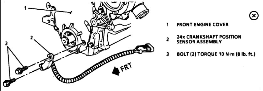

On that engine there can be two different places, here are some diagrams (Below) of the locations. You will need to jack the car up first.
and here is a guide that will give you an idea of what you are in for when changing the sensor.
