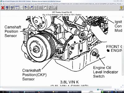

I am needing to find out where on my 1997 Grand Prix Se 6 cylinder 3800 the crankshaft position censor location is located on the car? I would like to know how to replace it as well.

Bottom of the engine to the right of the harmonic balance...pull the plug of, then unbolt!
https://www.2carpros.com/forum/automotive_pictures/62217_CKP_2.jpg
