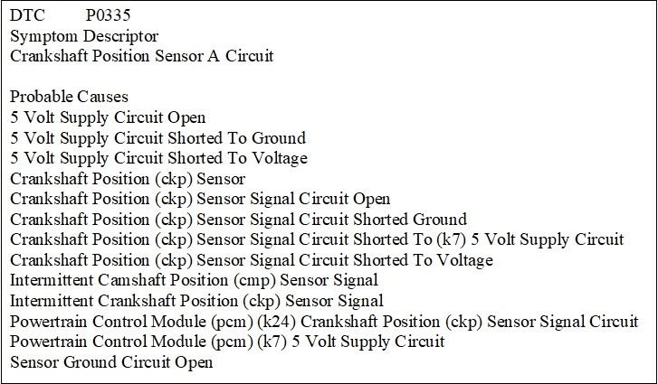

I have replaced the cam sensor and the crankshaft sensor 3 times, and it is still coming up p0335 crankshaft position sensor circuit A. I brought it to my buddy's friend's shop to put on their better computer, and they came up with same thing and is why I got third crankshaft sensor they said try one from Napa and I still have the same issue this been going on for 2 weeks. now is driving me nuts and am losing work I over it.

This is a common mistake. Diagnostic fault codes never say to replace a part or that one is defective. They only indicate the circuit that needs further diagnosis. When a sensor or other part is referenced, as it is here, that part is the cause of the fault code only about half of the time. First we have to rule out wiring and connector terminal problems, and mechanical problems associated with that part.
This chart lists the things that could cause code 335 to set. The best place to start is by watching the signal on a scanner under "live sensor data". You should see it switch from "No" to "Present", or something similar, when the crankshaft is rotating, (cranking or running). If it stays on "No" while you're cranking the engine, we have to look at this chart to find the cause. We know it's not the sensor at this point.

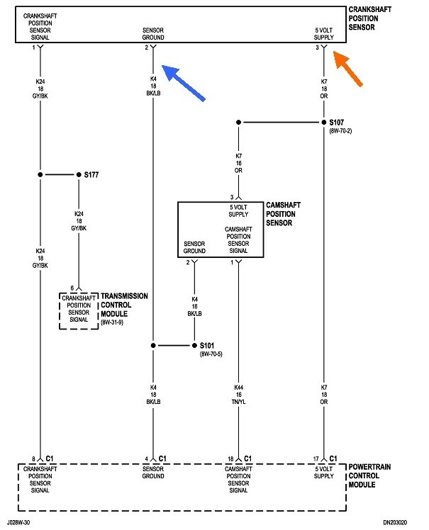

Next would be to measure the 5-volt feed and ground circuits. To be valid, these have to be taken with the sensor plugged in. Back-probe through the rubber seals, alongside the wires. For the benefit of others researching this topic, here's a link to an article on how to use a digital voltmeter:
The five volts should be there any time the ignition switch is in the "run" position. Expect to find 0.2 volts on the ground wire. That ground is shared by a few other sensors, so if there's a defect in it, there should be fault codes set for additional sensors.
The signal wire is a little trickier, and you may not get any usable information when measuring on that wire. With some sensors, you'll see the voltage switch from near 0 volts to near 5.0 volts as you turn the crankshaft by hand, but for a majority of position sensors, speed of that motion is a factor. It may take cranking speed for the sensor to generate a signal, and that's much too fast to read on a voltmeter. That's why we have to use a scanner and let the Engine Computer tells us if it's seeing the signal pulses.

I am getting 5 volts to it.

As far as your finding, a 5v reference is what should be the power supply to the sensor. Have you been able to check for a signal ground? This needs to be done with the key in the run position as well.

Okay, I will go check the ground. I had a few broken grounds, I have fixed. how do I check the ground?
May 9, 2022 at 6:16 AM
BUCKSDAMAN
  • 6 POSTS
The red led to the red and black to a ground?

Now that you know which is the 5-volt supply wire at the sensor, check for 0.2 volts on the black / light blue wire when the ignition switch is on. If that is there, the best approach is to find a scanner to view sensor data and see if the camshaft position sensor signal is showing up at the computer. My Chrysler DRB3 I have for all of my vehicles lists the sensors with a "No" or "Present" during cranking. Aftermarket scanners have a similar way to show that.
