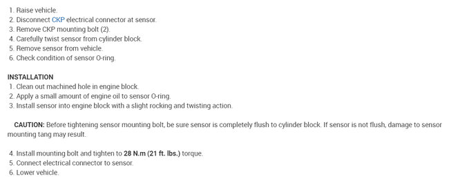

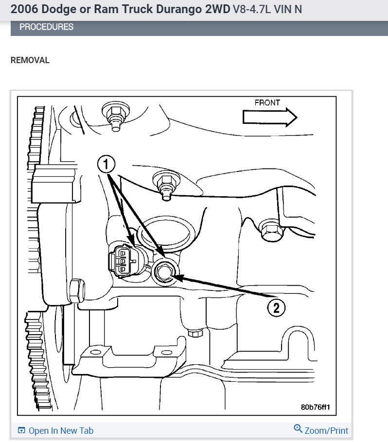

It is suppose to have oil on it but did you use an OEM sensor because if not the sensor could have just gone out again. Here is the sensor location and instructions so you can change it out again and a guide to help walk you through the replacement steps.
