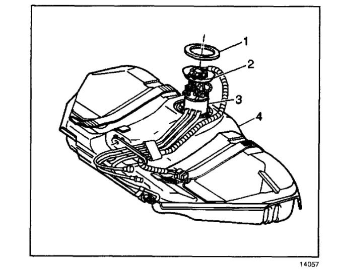

Last time I drove it it shut off while coming to stop to park. next day it turns over won’t start. put new plugs, reset auto theft, still won’t. It is getting gas, pump kicks in, you can smell and hear.

I would also check the actual fuel pressure. Even if the pump works, it may not be proving sufficient pressure for it to run.
Fuel System Pressure
Key On Engine Off 41-47 psi

Removal Procedure
Caution: To reduce the risk of fire and personal injury that may result from a fuel leak, always replace the fuel sender gasket when reinstalling the fuel sender assembly.
1. Remove the negative battery cable.
2. Relieve system fuel pressure. Refer to Fuel Pressure Relief Procedure. See: Fuel Pressure Release > Procedures > Fuel System Pressure Relief Procedure
3. Drain fuel tank. Refer to Draining Fuel Tank.
4. Remove the fuel tank. Refer to Fuel Tank/Service and Repair.
Important:
^ The modular fuel sender assembly may spring up from its position.
^ When removing the modular fuel sender assembly from the fuel tank, be aware that the reservoir bucket is full of fuel. It must be tipped slightly during removal to avoid damage to the float. Discard fuel sender O-ring and replace with a new one.
^ Carefully discard the reservoir fuel into an approved container.
5. While holding the modular fuel sender assembly down, remove the snap ring from designated slots located on the retainer.
Installation Procedure
1. Install a new O-ring on modular fuel sender (3) to tank.
2. Align tab on front of sender (2) with slot on front of retainer snap ring.
3. Slowly apply pressure to top of spring loaded sender until sender aligns flush with retainer on tank.
Important: Be sure that the snap ring is fully seated within the tab slots.
4. Insert snap ring (1) into designated slots.
