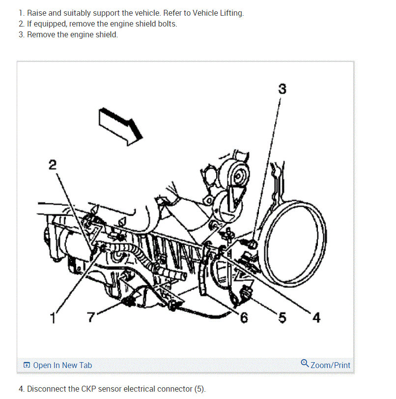

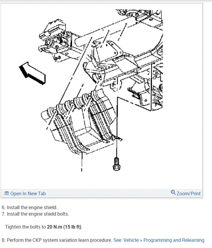

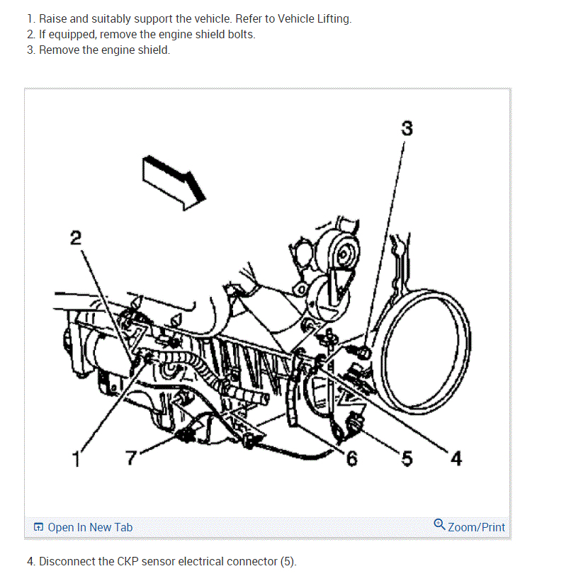

My truck was running great, two days ago I drove the truck all day no problems. Then parked it for an hour or two, went to go to store, it started up fine but stalled down the road at a stop sign. Started right back up. It did it several more times then today it quit and wont start. It cranks but no fire. I can hear fuel pump kick on. Please help.

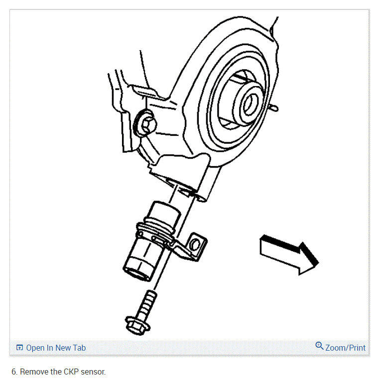

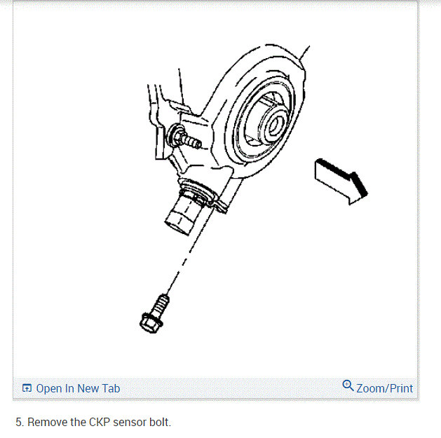

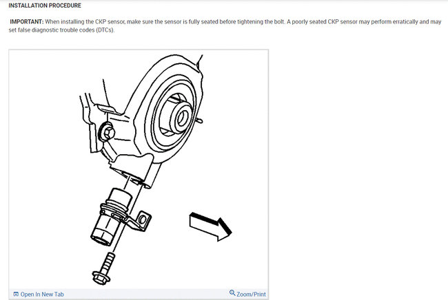

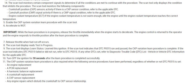

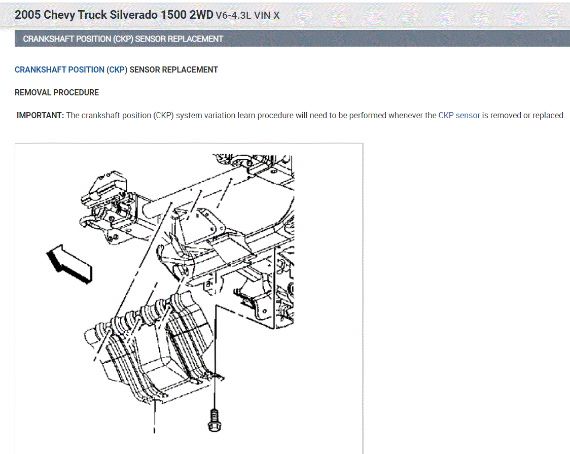

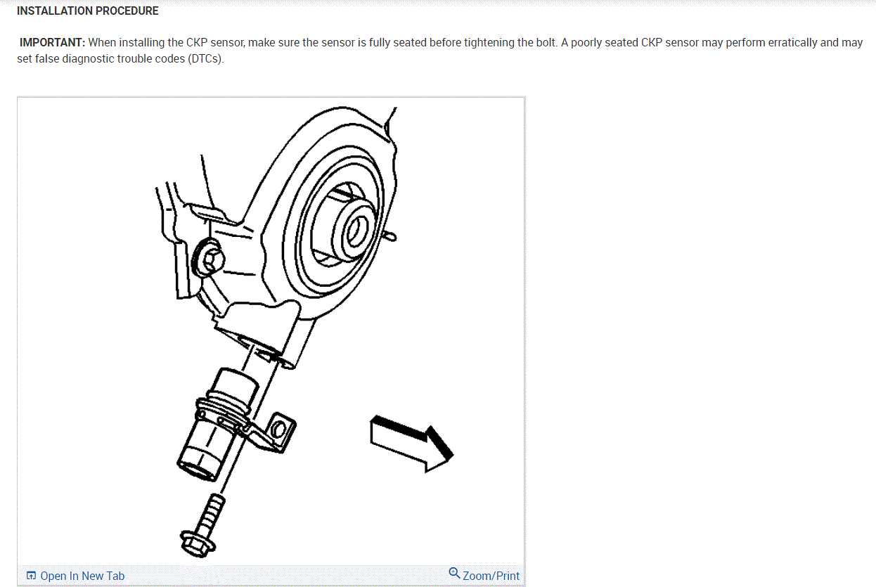

If you find there is no spark, I suspect it could be a bad or faulty crankshaft position sensor. Take a look through this link. It explains common symptoms of a faulty crankshaft position sensor.
If you have no spark and that link mirrors what you experience, here is a link that shows in general how one is replaced:

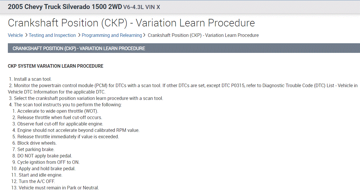

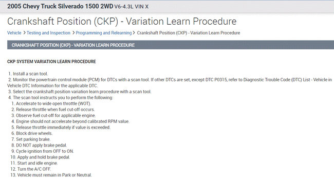

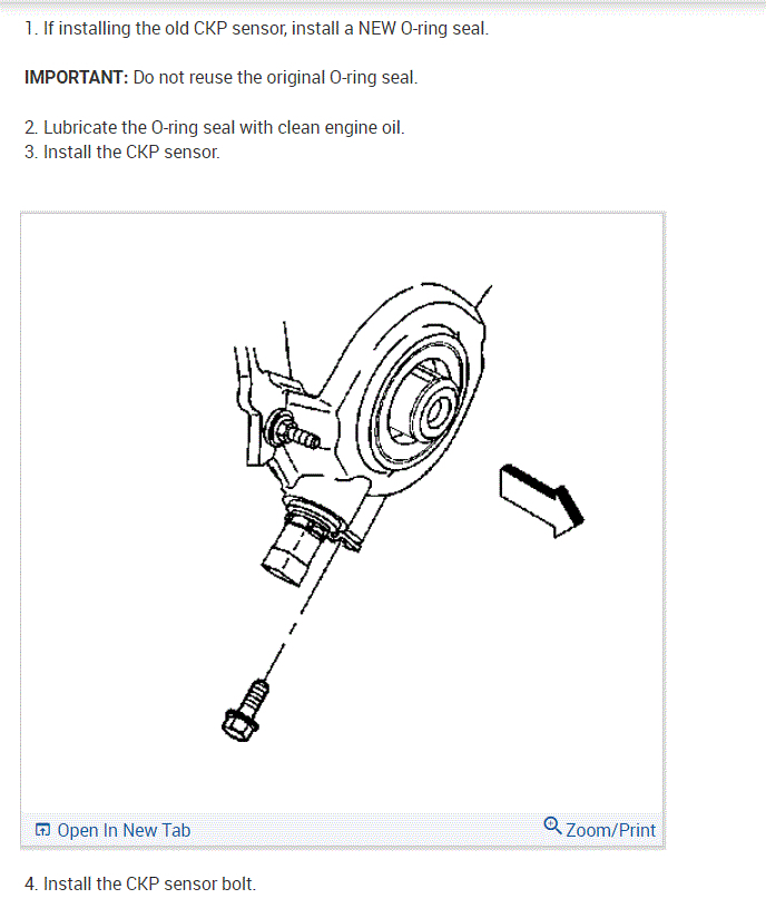

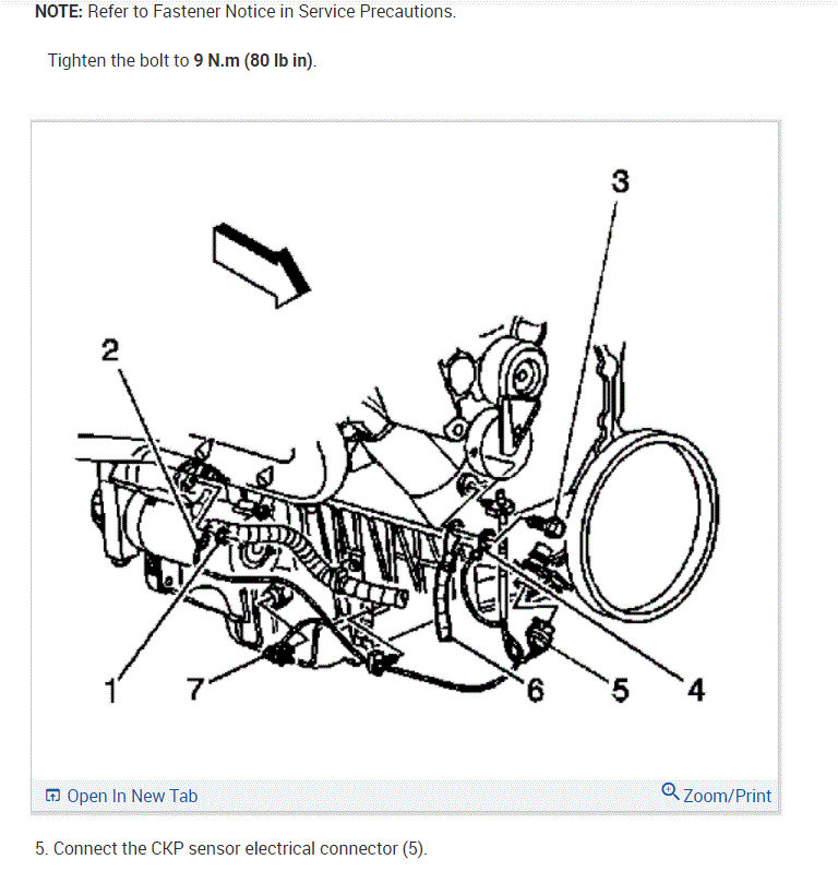

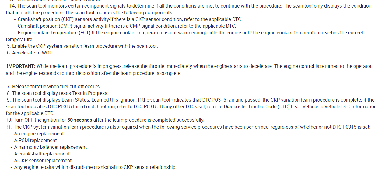

If you determine if it the crankshaft position sensor, I attached the directions, pictures, and relearn procedures below specific to your vehicle.
See pics below
